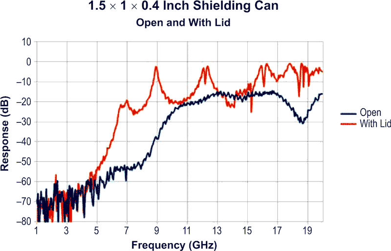

Time to make some real measurements. A VNA was connected between the connectors and the VNA's port 1 and port 2. Then a series of S21 measurements were made.
The first plot on the VNA was with the lid off, and it shows the natural coupling between the input and output probe (Figure 4). This circuit could be roughly modeled with a small capacitor in series with a resistor between the circuit probes inside the shield. At low frequencies the coupling is very small, while at higher frequencies the coupling increases and eventually levels off.
Needless to say, the exact location of the capacitive probes in the shield will effect the exact response. Closer together and the coupling will increase, etc. But as long as we don't move the probes the comparison results will be valid, and these probes are soldered in place, so they don't move.
Shields are your friend, except when...
Figure 4. The Blue trace is a VNA plot of the input to output with the cover off. This shows the expected capacitive coupling behavior until very high frequencies. The Orange trace is what happens when the lid is put on, this completes the cavity circuit and turns our tame circuit board into a the highly resonant and complex cavity structure with multiple resonances.
As can be seen in Figure 4, when the lid is put on, our nice shielding box turns into a complex resonant structure with multiple resonances (peaks and dips). Equation 2 predicted that the first resonance would happen at about 7 GHz and sure enough, that is where the first peak is. At that first peak the coupling between the input to output probe has been reduced by over 30 dB.
Why care about this? There are a number of reasons. First, if you have gain at any of these peaks the increased coupling can cause a spurious oscillation. This may be out of your band of interest, but if your amplifier is oscillating at some high frequency it will probably be detrimental to its operation at lower frequencies also.
I once had a multistage amplifier that oscillated well out of band when it was buttoned up in its shield. You would never see it in a VNA gain or match sweep, but it changed the amplifier's operating point and also the harmonics of the amplifier and that did affect the downstream circuits.
If, on the other hand, your circuit operates through these resonances it is possible that as you sweep the frequencies through these points you will see all sorts of unexplained power dips (also called “suck outs”).
A third problem may be when your circuit has internal frequencies near these resonances (or just by the increased broadband coupling). This peaks the energy inside the shield and can cause EMI emissions failures by increasing the leakages that get outside the shields.
