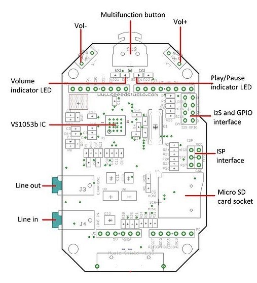

The Music Shield is a professional audio codec.It can work with Arduino, Seeeduino, Seeeduino Mega and Arduino Mega. It is based on VS1053b IC, and can play a variety of music formats stored on MicroSD cards with Seeed the provided Arduino Library.
Seeed Misic Shield
Seeed Misic Shield on Seeduino/Arduino
Note :Recording is only supported on Seeeduino Mega and Arduino Mega for now.
Features
  • Arduino/Seeeduino, Arduino Mega, and Seeeduino Mega compatible
  • 2 control-push buttons and 1 knob switch
  • Plays music from micro SD cards Decodes:MP3,WAV,MIDI,Ogg Vorbis
  • I2S interface for external DAC
  • Headphone/Line Out for playback
  • Line In for recording in OGG format
  • Excellent sound quality with ±1dB Frequency Response
  • FCC verification
