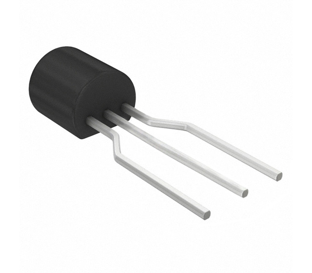

Datasheet Texas Instruments TL431CLPM
| Manufacturer | Texas Instruments |
| Series | TL431 |
| Part Number | TL431CLPM |
2% Accuracy Adjustable Precision Shunt Regulator 3-TO-92 0 to 70
Datasheet TL431, TL432
PDF, 3.1 Mb, Language: en, File published: May, 2025, Pages: 85
Precision Programmable Reference
Extract from the document
Datasheet TL431, TL431A, TL431B, TL432, TL432A, TL432B
PDF, 2.9 Mb, Revision: O, File published: Jan 29, 2015, Pages: 78
TL43xx Precision Programmable Reference
Parametrics
| Reference Type | Shunt |
| Output Type | Adjustable |
| Voltage - Output (Min/Fixed) | 2.495 V |
| Voltage - Output (Max) | 36 V |
| Current - Output | 100 mA |
| Package / Case | TO-92-3 Formed Leads ![]() |
| Tolerance | -2.2~2.2 % |
| Operating Temperature | 0~70 °C |
| Current Cathode | 1 mA |
| RoHS | Yes |
| Product Status | Active |
| Packaging | Cut Tape Tape Box |
Status
| Lifecycle Status | Active (Recommended for new designs) |
| Manufacture's Sample Availability | No |
Packaging
| Pin | 3 |
| Package Type | LP |
| Industry STD Term | TO-92 |
| JEDEC Code | O-PBCY-W |
| Package QTY | 2000 |
| Carrier | AMMO |
| Device Marking | TL431C |
| Width (mm) | 4.3 |
| Length (mm) | 4.3 |
| Thickness (mm) | 3.6 |
| Pitch (mm) | 1.27 |
| Max Height (mm) | 5.34 |
| Mechanical Data | Download |
Parametrics
| Initial Accuracy(Max) | 2 % |
| Iout/Iz(Max) | 100 mA |
| Iz for Regulation(Min) | 400 uA |
| Operating Temperature Range | -40 to 125,-40 to 85,0 to 70 C |
| Package Group | TO-92 |
| Package Size: mm2:W x L | 3TO-92: 19 mm2: 3.68 x 5.2(TO-92) PKG |
| Pin/Package | 3SOT-23, 3SOT-89, 3TO-92, 5SOT-23, 6SC70, 8PDIP, 8SO, 8SOIC, 8TSSOP |
| Rating | Catalog |
| Reference Voltage | Adjustable |
| Temp Coeff(Max) | 92 ppm/ degree C |
| Temp Coeff(Typ) | 34 ppm/ degree C |
| VO | 2.495 V |
| VO Adj(Max) | 36 V |
| VO Adj(Min) | 2.495 V |
Eco Plan
| RoHS | Compliant |
| Pb Free | Yes |
