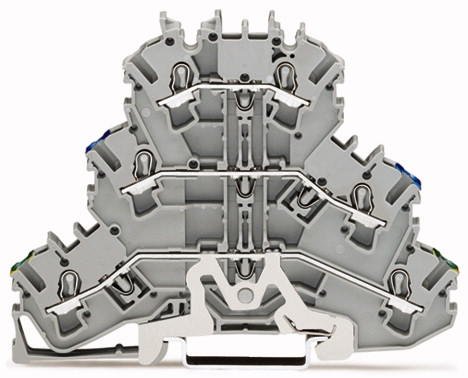

Datasheet Wago 2002-3217
TOPJOB S triple-deck terminal block; ground/through/through (PE/N/L); rail mount; 2-conductor; 5.2 mm wide; gray
Parametrics
| Actuation type | Open Tool Slot |
| Color | gray |
| Connectable conductor materials | Copper |
| Connection technology | Push-in CAGE CLAMP® |
| Страна происхождения | DE |
| Depth | 93.3 mm / 3.673 inch |
| Design | horizontal |
| Fine-stranded conductor | 0.25 … 4 mm² / 22 … 12 AWG |
| Fine-stranded conductor with ferrule, push-in termination, from | 0.75 mm² / 18 AWG |
| Fire load | 0.306 MJ |
| Global Trade Item Number (GTIN) | 4044918691208 |
| Height from upper-edge of DIN-35 rail | 69.5 mm / 2.736 inch |
| Insulating material | Polyamide 66 (PA 66) |
| Marking level | Center/side marking |
| Nominal cross section | 2.5 mm² |
| Number of connection points | 3 |
| Number of connection points (connection type) | 3 |
| Number of levels | 3 |
| Potential marking | PE/N/L |
| Product Group | 22 (TOPJOB S) |
| Rated current (Ex e II) | 19 A |
| Rated current (Ex e II) with jumper | 17 A |
| Rated voltage EN (Ex e II) | 440 V |
| Solid conductor | 0.25 … 4 mm² / 22 … 12 AWG |
| Solid conductor, push-in termination | 0.75 … 4 mm² / 18 … 12 AWG |
| Strip length | 10 … 12 mm / 0.39 … 0.47 Inch |
| Total number of connection points | 6 |
| Total number of potentials | 3 |
| Type of mounting | DIN-35 rail |
| Type of wiring | Front-entry wiring |
| Weight | 19.673 g |
| Width | 5.2 mm / 0.205 inch |
