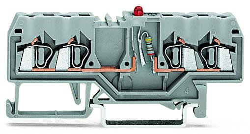

Datasheet Wago 280-809/281-434
LED terminal block; with red LED (PN); 24 VDC; rail-mount; 4-conductor; 5 mm wide; gray
Parametrics
| Actuation type | Operating tool |
| Color | gray |
| Connectable conductor materials | Copper |
| Connection technology | CAGE CLAMP® |
| Страна происхождения | DE |
| Depth | 75 mm / 2.953 inch |
| Design | horizontal |
| Fine-stranded conductor | 0.08 … 2.5 mm² / 28 … 14 AWG |
| Fire load | 0.157 MJ |
| Global Trade Item Number (GTIN) | 4045454396619 |
| Height from upper-edge of DIN-35 rail | 28 mm / 1.102 inch |
| Insulating material | Polyamide 66 (PA 66) |
| Marking level | Center marking |
| Nominal voltage | 24 V |
| Number of levels | 1 |
| Product Group | 1 (Rail Mounted Terminal Blocks) |
| Solid conductor | 0.08 … 2.5 mm² / 28 … 14 AWG |
| Strip length | 8 … 9 mm / 0.31 … 0.35 Inch |
| Total number of connection points | 4 |
| Total number of potentials | 1 |
| Type of mounting | DIN-35 rail |
| Type of wiring | Front-entry wiring |
| Voltage type (1) | DC |
| Weight | 9.515 g |
| Width | 5 mm / 0.197 inch |
