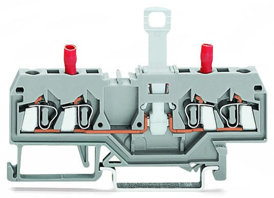

Datasheet Wago 280-829
2-conductor disconnect/test terminal block; without pivoting knife disconnect; with touch-proof test sockets; Test socket, red; for DIN-rail 35 x 15 and 35 x 7.5; 2.5 mm²; CAGE CLAMP
Parametrics
| Actuation type | Open Tool Slot |
| Color | gray |
| Connectable conductor materials | Copper |
| Connection technology | CAGE CLAMP® |
| Страна происхождения | DE |
| Depth | 53 mm / 2.087 inch |
| Design | horizontal |
| Fine-stranded conductor | 0.08 … 2.5 mm² / 28 … 12 AWG |
| Global Trade Item Number (GTIN) | 4044918691390 |
| Height from upper-edge of DIN-35 rail | 52.5 mm / 2.067 inch |
| Insulating material | Polyamide 66 (PA 66) |
| Legend (ratings) | (III / 3) ≙ Overvoltage category III / Pollution degree 3 |
| Marking level | Center marking |
| Number of levels | 1 |
| Product Group | 1 (Rail Mounted Terminal Blocks) |
| Rated current | 10 A |
| Rated impulse voltage (III / 3) | 6 kV |
| Rated voltage (III / 3) | 400 V |
| Solid conductor | 0.08 … 2.5 mm² / 28 … 12 AWG |
| Strip length | 8 … 9 mm / 0.31 … 0.35 Inch |
| Total number of connection points | 2 |
| Total number of potentials | 2 |
| Type of mounting | DIN-35 rail |
| Type of wiring | Front-entry wiring |
| Weight | 10.9 g |
| Width | 5 mm / 0.197 inch |
