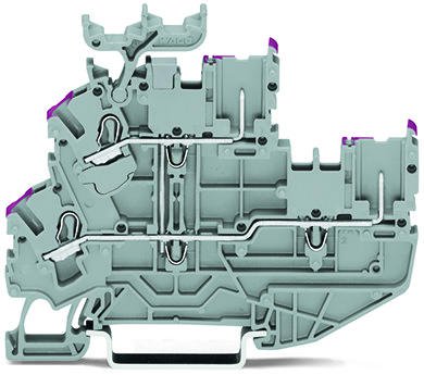

Datasheet Wago 2022-2238/999-953
2-conductor/2-pin, double-deck carrier terminal block; 2-conductor/2-pin through terminal block; L; internal commoning; suitable for Ex nA applications; conductor entry with violet marking; for DIN-rail 35 x 15 and 35 x 7.5; 2.5 mm²; Push-in CAGE CLAMP
Detailed Description
Parametrics
| Actuation type | Operating tool Push-in |
| Color | gray |
| Connectable conductor materials | Copper |
| Connection technology | Push-in CAGE CLAMP® |
| Страна происхождения | DE |

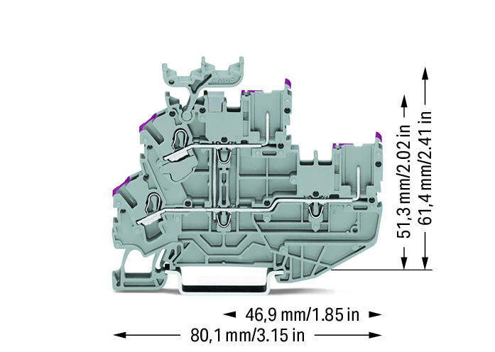

| Depth | 80.1 mm / 3.154 inch |
| Design | horizontal |
| Fine-stranded conductor | 0.25 … 4 mm² / 22 … 12 AWG |
| Fine-stranded conductor with ferrule, push-in termination, from | 0.75 mm² / 18 AWG |
| Global Trade Item Number (GTIN) | 4055143299404 |
| Height from upper-edge of DIN-35 rail | 61.4 mm / 2.417 inch |
| Insulating material | Polyamide 66 (PA 66) |
| Marking level | Side marking |
| Nominal cross section | 2.5 mm² |
| Number of levels | 2 |
| Potential marking | L |
| Rated voltage EN (Ex e II) | 630 V |
| Solid conductor | 0.25 … 4 mm² / 22 … 12 AWG |
| Solid conductor, push-in termination | 0.75 … 4 mm² / 18 … 12 AWG |
| Strip length | 10 … 12 mm / 0.39 … 0.47 Inch |
| Total number of connection points | 2 |
| Total number of potentials | 1 |
| Type of mounting | DIN-35 rail |
| Type of wiring | Front-entry wiring |
| Weight | 12.542 g |
| Width | 5.2 mm / 0.205 inch |
