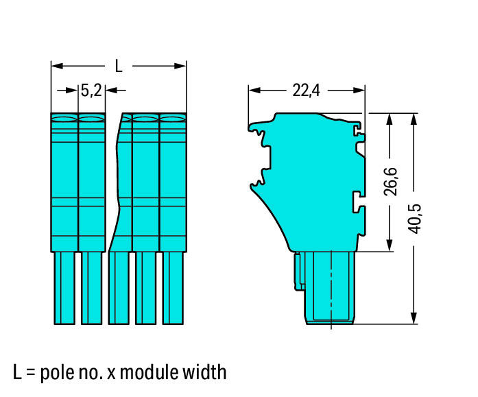

Datasheet Wago 2022-114/000-006
1-conductor female plug; 2.5 mm²; 14-pole
Detailed Description
Parametrics
| Actuation type | Operating tool Push-in |
| Color | blue |
| Connectable conductor materials | Copper |
| Connection technology | Push-in CAGE CLAMP® |
| Connector connection type | for conductors |
| Contact type (pluggable connector) | Female connector/socket |
| Страна происхождения | DE |
| Depth | 22.4 mm / 0.882 inch |
| Fine-stranded conductor | 0.25 … 4 mm² / 22 … 12 AWG |
| Fine-stranded conductor with ferrule, push-in termination, from | 0.75 mm² / 18 AWG |
| Fire load | 0.749 MJ |
| Global Trade Item Number (GTIN) | 4045454705558 |
| Height | 40.5 mm / 1.594 inch |
| Insulating material | Polyamide 66 (PA 66) |
| Legend (ratings) | (III / 3) ≙ Overvoltage category III / Pollution degree 3 |
| Marking level | Side marking |
| Nominal cross section | 2.5 mm² |
| Number of Poles | 14 |
| Product Group | 18 (X-COM-System) |
| Rated current | 24 A |
| Rated current (2) | 32 A |
| Rated impulse voltage (III / 3) | 6 kV |
| Rated voltage (III / 3) | 690 V |
| Solid conductor | 0.25 … 4 mm² / 22 … 12 AWG |
| Solid conductor, push-in termination | 0.75 … 4 mm² / 18 … 12 AWG |
| Strip length | 10 … 12 mm / 0.39 … 0.47 Inch |
| Total number of connection points | 14 |
| Total number of potentials | 14 |
| Type of wiring | Front-entry wiring |
| Weight | 46.02 g |
| Width | 72.8 mm / 2.866 inch |
