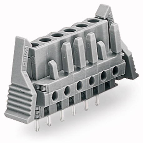

Datasheet Wago 232-138/039-000
THT female header; 0.6 x 1.0 mm solder pin; straight; Locking lever; Pin spacing 5 mm; 8-pole
Detailed Description
Parametrics
| Color | gray |
| Connector connection type | for PCBs |
| Contact material | Copper alloy |
| Contact plating | tin-plated |
| Contact type (pluggable connector) | Female connector/socket |
| Страна происхождения | DE |
| Depth | 11.6 mm / 0.457 inch |
| Drilled hole diameter (tolerance) | 1.3(+ 0.1) mm |
| Fire load | 0.155 MJ |
| Flammability class per UL94 | V0 |
| Global Trade Item Number (GTIN) | 4044918623353 |
| Height | 26.6 mm / 1.047 inch |
| Height from the surface | 21.6 mm / 0.85 inch |
| Insulating material | Polyamide 66 (PA 66) |
| Legend (ratings) | (III / 2) ≙ Overvoltage category III / Pollution degree 2 |
| Limit temperature range | -60 … +85 °C |
| Locking of plug-in connection | locking lever |
| Material group | I |
| Mating direction to the PCB | 90 ° |
| Mismating protection | No |
| Number of Poles | 8 |
| Number of levels | 1 |
| Number of solder pins per potential | 1 |
| PCB contact | THT |
| Pin spacing | 5 mm (0.197 inch) |
| Product Group | 3 (Multi Conn. System) |
| Rated current | 12 A |
| Rated impulse voltage (II / 2) | 4 kV |
| Rated impulse voltage (III / 2) | 4 kV |
| Rated impulse voltage (III / 3) | 4 kV |
| Rated voltage (II / 2) | 630 V |
| Rated voltage (III / 2) | 320 V |
| Rated voltage (III / 3) | 320 V |
| Solder pin arrangement | over the entire female connector, in line |
| Solder pin dimensions | 0.6 x 1 mm |
| Solder pin length | 5 mm |
| Total number of potentials | 8 |
| Weight | 8.272 g |
| Width | 55.8 mm / 2.197 inch |
