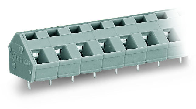

Datasheet Wago 236-208
PCB terminal block; 2.5 mm²; Pin spacing 7.5/7.62 mm; 8-pole; CAGE CLAMP ; commoning option
Parametrics
| Actuation type | Operating tool |
| Clamping spring material | Chrome nickel spring steel (CrNi) |
| Color | gray |
| Conductor entry angle to the PCB | 45 ° |
| Connection technology | CAGE CLAMP® |
| Contact material | Electrolytic copper (Ecu) |
| Contact plating | tin-plated |
| Страна происхождения | CH |
| Depth | 14 mm / 0.551 inch |
| Drilled hole diameter (tolerance) | 1.1(+ 0.1) mm |
| Fine-stranded conductor | 0.08 … 2.5 mm² / 28 … 12 AWG |
| Fine-stranded conductor with ferrule with plastic collar | 0.25 … 1.5 mm² |
| Fine-stranded conductor with ferrule without plastic collar | 0.25 … 1.5 mm² |
| Fire load | 0.156 MJ |
| Flammability class per UL94 | V0 |
| Global Trade Item Number (GTIN) | 4044918768016 |
| Height | 17 mm / 0.669 inch |
| Height from the surface | 13 mm / 0.512 inch |
| Insulating material | Polyamide 66 (PA 66) |
| Legend (ratings) | (III / 2) ≙ Overvoltage category III / Pollution degree 2 |
| Limit temperature range | -60 … +105 °C |
| Material group | I |
| Number of Poles | 8 |
| Number of connection types | 1 |
| Number of levels | 1 |
| Number of solder pins per potential | 1 |
| PCB contact | THT |
| Pin spacing | 7.5/7.62 mm / 0.295/0.3 inch |
| Product Group | 4 (Printed Circuit) |
| Rated current | 24 A |
| Rated impulse voltage (II / 2) | 6 kV |
| Rated impulse voltage (III / 2) | 6 kV |
| Rated impulse voltage (III / 3) | 6 kV |
| Rated voltage (II / 2) | 1000 V |
| Rated voltage (III / 2) | 630 V |
| Rated voltage (III / 3) | 400 V |
| Solder pin arrangement | over the entire terminal strip, in line |
| Solder pin dimensions | 0.7 x 0.7 mm |
| Solder pin length | 4 mm |
| Solid conductor | 0.08 … 2.5 mm² / 28 … 12 AWG |
| Strip length | 5 … 6 mm / 0.2 … 0.24 Inch |
| Total number of connection points | 8 |
| Total number of potentials | 8 |
| Weight | 8.644 g |
| Width | 62.3 mm / 2.453 inch |
