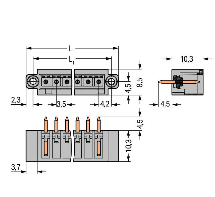

Datasheet Wago 734-132/108-000
THT male header; 1.0 x 1.0 mm solder pin; straight; 100% protected against mismating; Threaded flange; Pin spacing 3.5 mm; 2-pole
Detailed Description
Parametrics
| Color | light gray |
| Connector connection type | for PCBs |
| Contact material | Electrolytic copper (Ecu) |
| Contact plating | tin-plated |
| Contact type (pluggable connector) | Male connector/plug |
| Страна происхождения | DE |
| Depth | 8.5 mm / 0.335 inch |
| Drilled hole diameter (tolerance) | 1.4(+ 0.1) mm |
| Fire load | 0.02 MJ |
| Flammability class per UL94 | V0 |
| Global Trade Item Number (GTIN) | 4045454682897 |
| Height | 14.8 mm / 0.583 inch |
| Height from the surface | 10.3 mm / 0.406 inch |
| Insulating material | Polyamide 66 (PA 66) |
| Legend (ratings) | (III / 2) ≙ Overvoltage category III / Pollution degree 2 |
| Limit temperature range | -60 … +100 °C |
| Locking of plug-in connection | Threaded flange |
| Material group | I |
| Mating direction to the PCB | 90 ° |
| Mismating protection | Yes |
| Number of Poles | 2 |
| Number of levels | 1 |
| Number of solder pins per potential | 1 |
| PCB contact | THT |
| Pin spacing | 3.5 mm (0.138 inch) |
| Product Group | 3 (Multi Conn. System) |
| Rated current | 10 A |
| Rated impulse voltage (II / 2) | 2.5 kV |
| Rated impulse voltage (III / 2) | 2.5 kV |
| Rated impulse voltage (III / 3) | 2.5 kV |
| Rated voltage (II / 2) | 320 V |
| Rated voltage (III / 2) | 160 V |
| Rated voltage (III / 3) | 160 V |
| Solder pin arrangement | over the entire male connector, in line |
| Solder pin dimensions | 1 x 1 mm |
| Solder pin length | 4.5 mm |
| Total number of potentials | 2 |
| Weight | 1.22 g |
| Width | 16.5 mm / 0.65 inch |
