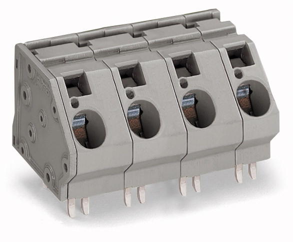

Datasheet Wago 745-605/006-000
PCB terminal block; 16 mm²; Pin spacing 15 mm; 5-pole; CAGE CLAMP ; commoning option
