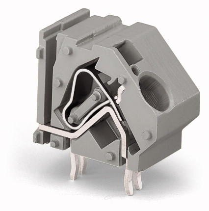

Datasheet Wago 745-887/006-000
Stackable PCB terminal block; 16 mm²; Pin spacing 20 mm; 1-pole; CAGE CLAMP ; commoning option
Parametrics
| Actuation type | Operating tool |
| Clamping spring material | Chrome nickel spring steel (CrNi) |
| Color | green-yellow |
| Conductor entry angle to the PCB | 45 ° |
| Connection technology | CAGE CLAMP® |
| Contact material | Electrolytic copper (Ecu) |
| Contact plating | tin-plated |
| Страна происхождения | PL |
| Depth | 33.4 mm / 1.315 inch |
| Drilled hole diameter (tolerance) | 2.2(+ 0.1) mm |
| Fine-stranded conductor | 0.2 … 16 mm² / 24 … 6 AWG |
| Fine-stranded conductor with ferrule with plastic collar | 0.25 … 10 mm² |
| Fine-stranded conductor with ferrule without plastic collar | 0.25 … 10 mm² |
| Fire load | 0.236 MJ |
| Flammability class per UL94 | V0 |
| Global Trade Item Number (GTIN) | 4055143555913 |
| Height | 33.5 mm / 1.319 inch |
| Height from the surface | 27 mm / 1.063 inch |
| Insulating material | Polyamide 66 (PA 66) |
| Legend (ratings) | (III / 2) ≙ Overvoltage category III / Pollution degree 2 |
| Limit temperature range | -60 … +105 °C |
| Material group | I |
| Number of Poles | 1 |
| Number of connection types | 1 |
| Number of jumper slots | 1 |
| Number of levels | 1 |
| Number of solder pins per potential | 4 |
| PCB contact | THT |
| Pin spacing | 20 mm (0.787 inch) |
| Product Group | 4 (Printed Circuit) |
| Rated current | 76 A |
| Rated impulse voltage (II / 2) | 12 kV |
| Rated impulse voltage (III / 2) | 12 kV |
| Rated impulse voltage (III / 3) | 12 kV |
| Rated voltage (II / 2) | 1000 V |
| Rated voltage (III / 2) | 1000 V |
| Rated voltage (III / 3) | 1000 V |
| Solder pin arrangement | over the entire terminal strip, in line |
| Solder pin dimensions | 1.2 x 1.6 mm |
| Solder pin length | 6.5 mm |
| Solid conductor | 0.2 … 16 mm² / 24 … 6 AWG |
| Strip length | 12 … 13 mm / 0.47 … 0.51 Inch |
| Total number of connection points | 1 |
| Total number of potentials | 1 |
| Weight | 12.61 g |
| Width | 21.5 mm / 0.846 inch |
