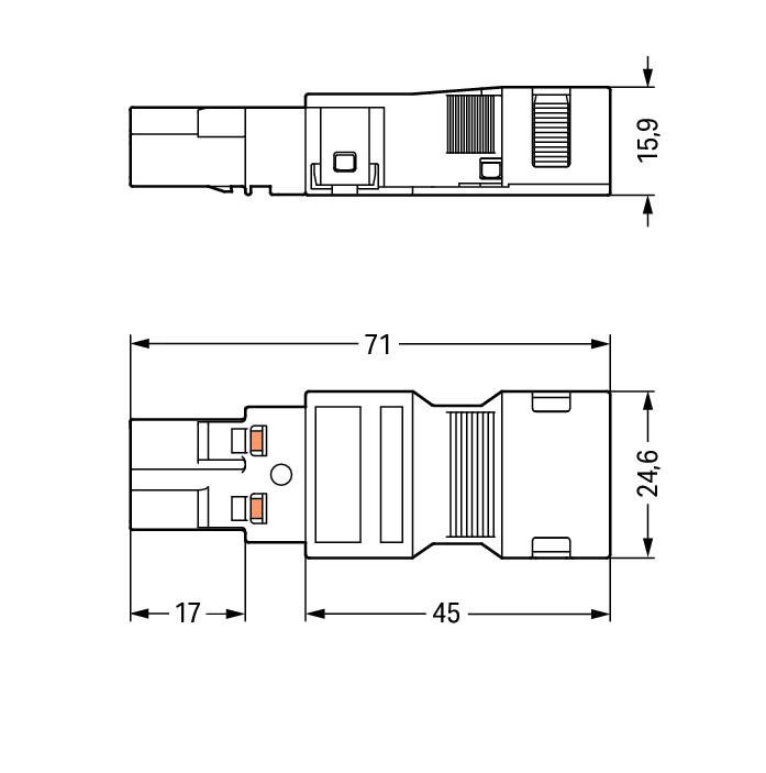

Parametrics
| Actuation type | Operating tool Push-in |
| Clamping spring material | Chrome nickel spring steel (CrNi) |
| Coding | A |
| Color | white |
| Connectable sheathed cable diameter | 7 … 10.5 mm |
| Connection technology | Push-in CAGE CLAMP® |
| Connector connection type | for conductors |
| Contact material | Copper or copper alloy, surface-treated |
| Contact type (pluggable connector) | Male connector/plug |
| Страна происхождения | DE |
| Degree of protection | IP20 |
| Depth | 71 mm / 2.795 inch |
| Fine-stranded conductor | 0.5 … 4 mm² / 20 … 12 AWG |
| Fine-stranded conductor with ferrule with plastic collar | 0.25 … 1.5 mm² / 20 … 16 AWG |
| Fine-stranded conductor with ferrule without plastic collar | 0.25 … 2.5 mm² / 20 … 14 AWG |
| Fine-stranded conductor with ferrule, push-in termination, from | 1.5 mm² / 16 AWG |
| Fire load | 0.318 MJ |
| Flammability class per UL94 | V0 |
| Global Trade Item Number (GTIN) | 4050821117964 |
| Height | 15.9 mm / 0.626 inch |
| Insulating material | Polyamide 66 (PA 66) |
| Legend (ratings) | (III / 3) ≙ Overvoltage category III / Pollution degree 3 |
| Locking lever | no |
| Locking of plug-in connection | locking lever |
| Marking | L N |
| Mating force of a plug-in connection | approx. 20 … 70 N (depending on pole number) |
| Mismating protection | Yes |
| Nominal cross section | 4 mm² |
| Note (strip length) | see also packaging or instructions |
| Number of Poles | 2 |
| Pin spacing | 10 mm (0.394 inch) |
| Potential marking | L N |
| Rated current | 25 A |
| Rated impulse voltage (III / 3) | 4 kV |
| Rated voltage (III / 3) | 250 V |
| Retention force of a plug-in connection | when locked: > 80N |
| Solid conductor | 0.5 … 4 mm² / 20 … 12 AWG |
| Solid conductor, push-in termination | 1.5 … 4 mm² / 16 … 12 AWG |
| Strain relief | Strain relief housing |
| Stranded conductor | 0.5 … 2.5 mm² / 20 … 14 AWG |
| Strip length | 35 mm |
| Surrounding air (operating) temperature | -35 … 85 °C |
| Total number of connection points | 4 |
| Total number of potentials | 2 |
| Unmating force of a plug-in connection | when unlocked: approx. 20 … 70 N (depending on pole number) |
| Weight | 12.876 g |
| Width | 24.6 mm / 0.969 inch |
