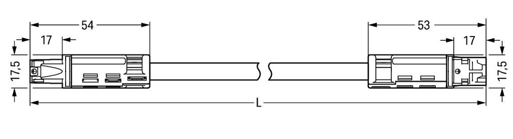

Datasheet Wago 774-9994/006-102
pre-assembled interconnecting cable; Eca; Socket/plug; 4-pole; Cod. A; H05VV-F 4G 1.5 mm²; 1 m
Detailed Description
Parametrics
| Coding | A |
| Color | white |
| Connection type | Socket - Plug |
| Connector color | white |
| Contact material | Copper or copper alloy, surface-treated |
| Страна происхождения | DE |
| Cross section of single conductor | 1.5 mm² |
| Degree of protection | IP20 |
| Durchmesser der Mantelleitung | 8.4 … 10.5 mm |
| Fire load | 2.376 MJ |
| Flammability class per UL94 | V0 |
| Global Trade Item Number (GTIN) | 4045454325671 |
| Insulating material | Polyamide 66 (PA 66) |
| Legend (ratings) | (III / 3) ≙ Overvoltage category III / Pollution degree 3 |
| Locking lever | yes |
| Locking of plug-in connection | locking lever |
| Marking | N ⏚ 2 1 |
| Mating force of a plug-in connection | approx. 30 … 70 N (depending on pole number) |
| Mismating protection | Yes |
| Number of Poles | 4 |
| Rated current | 16 A |
| Rated impulse voltage (III / 3) | 4 kV |
| Rated voltage (III / 3) | 250 V |
| Reaction to fire class per EN 50575 | Eca |
| Retention force of a plug-in connection | when locked: > 80N |
| Sheath material | PVC |
| Strain relief color | white |
| Surrounding air (operating) temperature | -35 … 85 °C |
| Total length | 1 m |
| Total number of potentials | 4 |
| Type of cable | H05VV-F 4G1.5 |
| Type of cable assembly | Interconnecting cable |
| Unmating force of a plug-in connection | when unlocked: approx. 30 … 70 N (depending on pole number) |
| Weight | 138.733 g |
