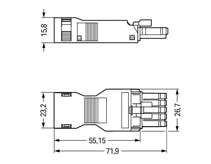

| Depth | 71.9 mm / 2.831 inch |

| Height | 15.8 mm / 0.622 inch |

| Width | 26.7 mm / 1.051 inch |
