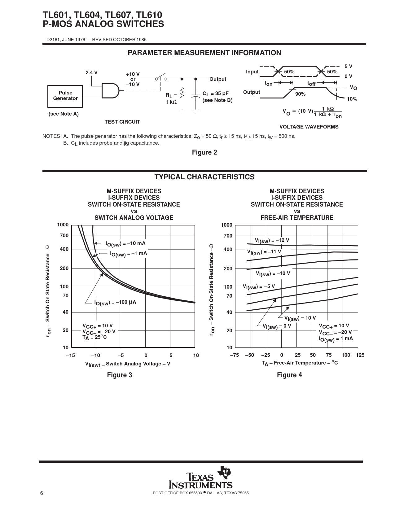

TL601, TL604, TL607, TL610 P-MOS ANALOG SWITCHES. PARAMETER MEASUREMENT INFORMATION. 5 V. Input. 50%. 2.4 V. +10 V. 0 V. Output. –10 V. off
D2161, JUNE 1976 — REVISED OCTOBER 1986
PARAMETER MEASUREMENT INFORMATION 5 V Input 50% 50% 2.4 V +10 V 0 V or Output t t –10 V on off VO Pulse Output C R L = 35 pF 90% L = Generator 10% (see Note B) 1 k
Ω
V
(10 V) 1 k
W
(see Note A) O 1 k
W )
ron TEST CIRCUIT VOLTAGE WAVEFORMS
NOTES: A. The pulse generator has the following characteristics: Zo = 50 Ω, tr ≥ 15 ns, tf ≥ 15 ns, tw = 500 ns. B. CL includes probe and jig capacitance.
Figure 2 TYPICAL CHARACTERISTICS M-SUFFIX DEVICES M-SUFFIX DEVICES I-SUFFIX DEVICES I-SUFFIX DEVICES SWITCH ON-STATE RESISTANCE SWITCH ON-STATE RESISTANCE vs vs SWITCH ANALOG VOLTAGE FREE-AIR TEMPERATURE 1000 1000 700 700 V I I(sw) = –12 V O(sw) = –10 mA
Ω Ω
400
ÎÎÎÎÎ
400 I V O(sw) = –1 mA I(sw) = –11 V
ÎÎÎÎÎ
200 200 VI(sw) = –10 V
ÎÎÎÎÎ
100 100 V
ÎÎÎÎÎ
I(sw) = – 5 V 70 70
ÎÎÎÎÎ
IO(sw) = –100
µ
A 40 40 VI(sw) = 10 V – Switch On-State Resistance – – Switch On-State Resistance – VCC+ = 10 V VI(sw) = 0 V VCC+ = 10 V 20 20 V on CC– = –20 V on V r CC– = –20 V r TA = 25
C IO(sw) = 1 mA 10 10 –15 –10 –5 0 5 10 –75 –50 –25 0 25 50 75 100 125 V T I(sw) – Switch Analog Voltage – V A – Free-Air Temperature –
C Figure 3 Figure 4
