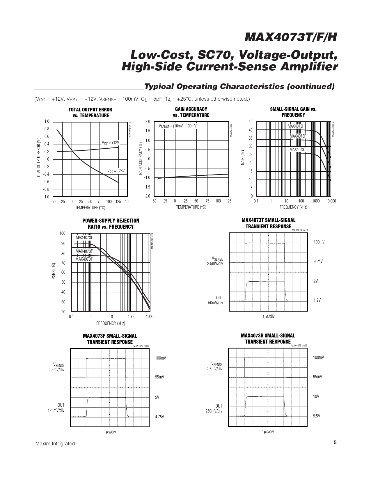

MAX4073T/F/H Low-Cost, SC70, Voltage-Output, High-Side Current-Sense Amplifier Typical Operating Characteristics (continued)
(VCC = +12V, VRS+ = +12V, VSENSE = 100mV, CL = 5pF, TA = +25°C, unless otherwise noted.)
TOTAL OUTPUT ERROR GAIN ACCURACY SMALL-SIGNAL GAIN vs. vs. TEMPERATURE vs. TEMPERATURE FREQUENCY
1.0 2.0 45 VSENSE = (10mV - 100mV) MAX4073H 0.8 1.5 40 0.6 MAX4073 toc10 MAX4073 toc11 MAX4073 toc12 MAX4073F 35 1.0 0.4 VCC = +12V 30 MAX4073T 0.2 0.5 25 0 0 20 GAIN (dB) -0.2 V -0.5 CC = +28V 15 -0.4 GAIN ACCURACY (%) TOTAL OUTPUT ERROR (%) -1.0 10 -0.6 -1.5 -0.8 5 -1.0 -2.0 0 -50 -25 0 25 50 75 100 125 150 -50 -25 0 25 50 75 100 125 0.1 1 10 100 1000 10,000 TEMPERATURE (°C) TEMPERATURE (°C) FREQUENCY (kHz)
POWER-SUPPLY REJECTION MAX4073T SMALL-SIGNAL RATIO vs. FREQUENCY TRANSIENT RESPONSE
MAX4073 toc14 100 MAX4073H 90 100mV MAX4073 toc13 MAX4073F 80 MAX4073T VSENSE 70 2.5mV/div 95mV 60 PSRR (dB) 50 2V 40 OUT 30 1.9V 50mV/div 20 0.1 1 10 100 1000 1µs/div FREQUENCY (kHz)
MAX4073F SMALL-SIGNAL MAX4073H SMALL-SIGNAL TRANSIENT RESPONSE TRANSIENT RESPONSE
MAX4073 toc15 MAX4073 toc16 100mV 100mV V V SENSE SENSE 2.5mV/div 2.5mV/div 95mV 95mV 5V 10V OUT OUT 125mV/div 250mV/div 4.75V 9.5V 1µs/div 1µs/div
