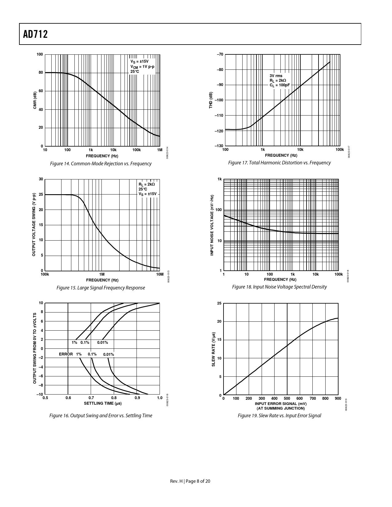

100. –70. VS = ±15V VCM = 1V p-p. –80. 25°C. 3V rms RL = 2kΩ. –90. CL = 100pF. ) 60. R (. –100. HD (. –110. –120. –130. 10k. 100k. FREQUENCY (Hz)

100 –70 VS = ±15V VCM = 1V p-p –80 80 25°C 3V rms RL = 2kΩ –90 CL = 100pF ) 60 B B) d d R ( –100 HD ( CM T 40 –110 20 –120 0 –130

00 00 Figure 14. Common-Mode Rejection vs. Frequency Figure 17. Total Harmonic Distortion vs. Frequency
30 1k RL = 2kΩ 25°C ) 25 V ) -p S = ±15V p V √Hz ( V/ 20 (n 100 ING E W G S A E T L 15 AG T VO L E O IS V 10 O 10 UT N P T T U PU O 5 IN 0

823 0 00 0 Figure 15. Large Signal Frequency Response Figure 18. Input Noise Voltage Spectral Density
10 25 8 TS 6 OL 20 V 4 ) TO ± s V µ 0 2 V/ 15 1% 0.1% 0.01% OM E ( R 0 T A ERROR 1% 0.1% 0.01% G F R –2 IN 10 EW W S SL –4 T U TP –6 5 OU –8 –10

823 00 Figure 16. Output Swing and Error vs. Settling Time Figure 19. Slew Rate vs. Input Error Signal Rev. H | Page 8 of 20 Document Outline FEATURES GENERAL DESCRIPTION CONNECTION DIAGRAM PRODUCT HIGHLIGHTS TABLE OF CONTENTS REVISION HISTORY SPECIFICATIONS ABSOLUTE MAXIMUM RATINGS ESD CAUTION TYPICAL PERFORMANCE CHARACTERISTICS SETTLING TIME OPTIMIZING SETTLING TIME OP AMP SETTLING TIME—A MATHEMATICAL MODEL APPLICATIONS INFORMATION GUARDING DAC CONVERTER APPLICATIONS NOISE CHARACTERISTICS DRIVING THE ANALOG INPUT OF AN ADC DRIVING A LARGE CAPACITIVE LOAD FILTERS ACTIVE FILTER APPLICATIONS SECOND-ORDER LOW-PASS FILTER 9-POLE CHEBYCHEV FILTER OUTLINE DIMENSIONS ORDERING GUIDE
