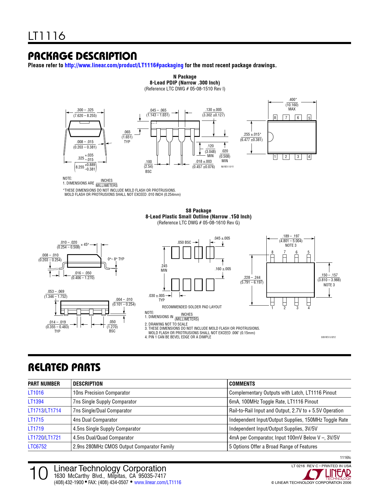

package DescripTion. Please refer to http://www.linear.com/product/LT1116#packaging for the most recent package drawings
LT1116
package DescripTion Please refer to http://www.linear.com/product/LT1116#packaging for the most recent package drawings. N Package 8-Lead PDIP (Narrow .300 Inch)
(Reference LTC DWG # 05-08-1510 Rev I) .400* (10.160) .300 – .325 .045 – .065 .130 ±.005 MAX (7.620 – 8.255) (1.143 – 1.651) (3.302 ±0.127) 8 7 6 5 .065 .255 (1.651) ±.015* .008 – .015 TYP (6.477 ±0.381) .120 (0.203 – 0.381) (3.048) .020 +.035 MIN (0.508) .325 1 2 3 4 –.015 .100 .018 MIN ±.003 +0.889 (2.54) N8 REV I 0711 8.255 (0.457 ±0.076) ( –0.381) BSC NOTE: INCHES 1. DIMENSIONS ARE MILLIMETERS *THESE DIMENSIONS DO NOT INCLUDE MOLD FLASH OR PROTRUSIONS. MOLD FLASH OR PROTRUSIONS SHALL NOT EXCEED .010 INCH (0.254mm)
S8 Package 8-Lead Plastic Small Outline (Narrow .150 Inch)
(Reference LTC DWG # 05-08-1610 Rev G) .189 – .197 .045 ±.005 .010 – .020 (4.801 – 5.004) .050 BSC (0.254 – 0.508)× 45° NOTE 3 8 7 6 5 .008 – .010 0 (0.203 – 0.254) °– 8° TYP .245 MIN .160 ±.005 .016 – .050 .150 – .157 (0.406 – 1.270) .228 – .244 (3.810 – 3.988) (5.791 – 6.197) NOTE 3 .053 – .069 (1.346 – 1.752) .030 ±.005 .004 – .010 TYP (0.101 – 0.254) RECOMMENDED SOLDER PAD LAYOUT 1 2 3 4 NOTE: INCHES 1. DIMENSIONS IN (MILLIMETERS) .014 – .019 .050 2. DRAWING NOT TO SCALE (0.355 – 0.483) (1.270) 3. THESE DIMENSIONS DO NOT INCLUDE MOLD FLASH OR PROTRUSIONS. TYP BSC MOLD FLASH OR PROTRUSIONS SHALL NOT EXCEED .006" (0.15mm) 4. PIN 1 CAN BE BEVEL EDGE OR A DIMPLE SO8 REV G 0212
