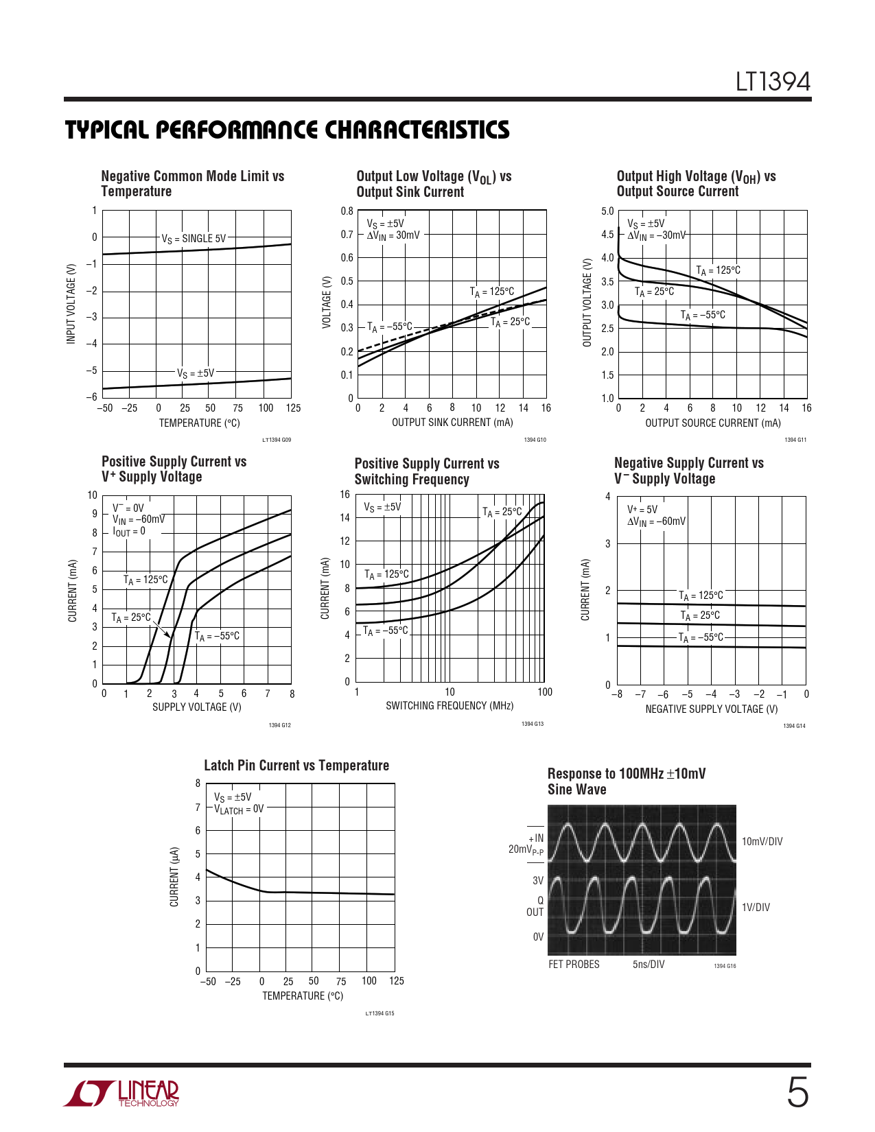

TYPICAL PERFORMANCE CHARACTERISTICS. Negative Common Mode Limit vs. Output Low Voltage (V. Output High Voltage (V. OL) vs. OH) vs
TYPICAL PERFORMANCE CHARACTERISTICS Negative Common Mode Limit vs Output Low Voltage (V Output High Voltage (V OL) vs OH) vs
LT1394
W U TYPICAL PERFORMANCE CHARACTERISTICS Negative Common Mode Limit vs Output Low Voltage (V Output High Voltage (V OL) vs OH) vs Temperature Output Sink Current Output Source Current
1 0.8 5.0 VS = ±5V VS = ±5V 0 V 0.7 ∆V 4.5 ∆V S = SINGLE 5V IN = 30mV IN = –30mV 0.6 4.0 –1 TA = 125°C 0.5 3.5 –2 TA = 125°C TA = 25°C 0.4 3.0 –3 TA = –55°C VOLTAGE (V) T 0.3 T A = 25°C A = –55°C 2.5 INPUT VOLTAGE (V) –4 OUTPUT VOLTAGE (V) 0.2 2.0 –5 VS = ±5V 0.1 1.5 –6 0 1.0 –50 –25 0 25 50 75 100 125 0 2 4 6 8 10 12 14 16 0 2 4 6 8 10 12 14 16 TEMPERATURE (°C) OUTPUT SINK CURRENT (mA) OUTPUT SOURCE CURRENT (mA) LT1394 G09 1394 G10 1394 G11
Positive Supply Current vs Positive Supply Current vs Negative Supply Current vs V+ Supply Voltage Switching Frequency V – Supply Voltage
10 16 4 V– = 0V V 9 S = ±5V T V+ A = 25°C = 5V VIN = –60mV 14 ∆VIN = –60mV 8 IOUT = 0 12 3 7 10 6 T T A = 125°C A = 125°C 5 8 2 TA = 125°C 4 6 CURRENT (mA) T T A = 25°C CURRENT (mA) CURRENT (mA) A = 25°C 3 T T A = –55°C A = –55°C 4 1 TA = –55°C 2 2 1 0 0 0 0 1 2 3 4 5 6 7 8 1 10 100 –8 –7 –6 –5 –4 –3 –2 –1 0 SUPPLY VOLTAGE (V) SWITCHING FREQUENCY (MHz) NEGATIVE SUPPLY VOLTAGE (V) 1394 G12 1394 G13 1394 G14
Latch Pin Current vs Temperature Response to 100MHz
10mV
8
Sine Wave
VS = ±5V 7 VLATCH = 0V 6 + IN 10mV/DIV 5 20mV µA) P-P 4 3V 3 CURRENT ( Q 1V/DIV OUT 2 0V 1 FET PROBES 5ns/DIV 1394 G16 0 –50 –25 0 25 50 75 100 125 TEMPERATURE (°C) LT1394 G15 5
