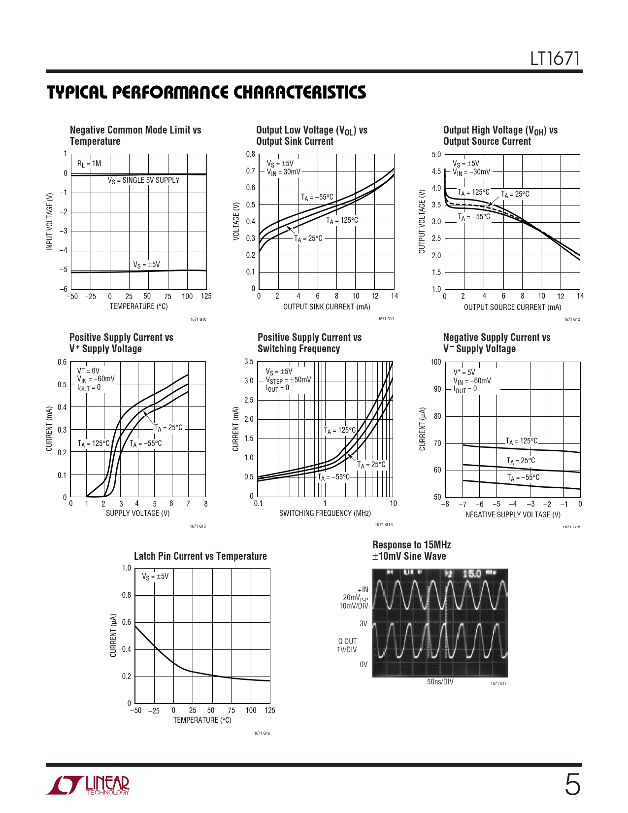

TYPICAL PERFORMANCE CHARACTERISTICS. Negative Common Mode Limit vs. Output Low Voltage (V. Output High Voltage (V. OL) vs. OH) vs
TYPICAL PERFORMANCE CHARACTERISTICS Negative Common Mode Limit vs Output Low Voltage (V Output High Voltage (V OL) vs OH) vs
LT1671
W U TYPICAL PERFORMANCE CHARACTERISTICS Negative Common Mode Limit vs Output Low Voltage (V Output High Voltage (V OL) vs OH) vs Temperature Output Sink Current Output Source Current
1 0.8 5.0 RL = 1M VS = ±5V VS = ±5V 0 0.7 VIN = 30mV 4.5 VIN = –30mV VS = SINGLE 5V SUPPLY 0.6 4.0 –1 T T A = 125°C T A = –55°C A = 25°C 0.5 3.5 –2 T 0.4 T A = –55°C A = 125°C 3.0 –3 VOLTAGE (V) 0.3 TA = 25°C 2.5 INPUT VOLTAGE (V) –4 OUTPUT VOLTAGE (V) 0.2 2.0 V –5 S = ±5V 0.1 1.5 –6 0 1.0 –50 –25 0 25 50 75 100 125 0 2 4 6 8 10 12 14 0 2 4 6 8 10 12 14 TEMPERATURE (°C) OUTPUT SINK CURRENT (mA) OUTPUT SOURCE CURRENT (mA) 1671 G10 1671 G11 1671 G12
Positive Supply Current vs Positive Supply Current vs Negative Supply Current vs V + Supply Voltage Switching Frequency V – Supply Voltage
0.6 3.5 100 V– = 0V VS = ±5V V+ = 5V VIN = –60mV 3.0 VSTEP = ±50mV V 0.5 IN = –60mV IOUT = 0 IOUT = 0 90 IOUT = 0 2.5 0.4 µA) 2.0 80 0.3 TA = 25°C TA = 125°C 1.5 T T A = 125°C TA = –55°C 70 A = 125°C CURRENT (mA) CURRENT (mA) CURRENT ( 0.2 1.0 T T A = 25°C A = 25°C 60 0.1 0.5 TA = –55°C TA = –55°C 0 0 50 0 1 2 3 4 5 6 7 8 0.1 1 10 –8 –7 –6 –5 –4 –3 –2 –1 0 SUPPLY VOLTAGE (V) SWITCHING FREQUENCY (MHz) NEGATIVE SUPPLY VOLTAGE (V) 1671 G13 1671 G14 1671 G15
Response to 15MHz Latch Pin Current vs Temperature
10mV Sine Wave
1.0 VS = ±5V +IN 0.8 20mVP-P 10mV/DIV µA) 0.6 3V Q OUT 0.4 1V/DIV CURRENT ( 0V 0.2 50ns/DIV 1671 G17 0 –50 –25 0 25 50 75 100 125 TEMPERATURE (°C) 1671 G16 5
