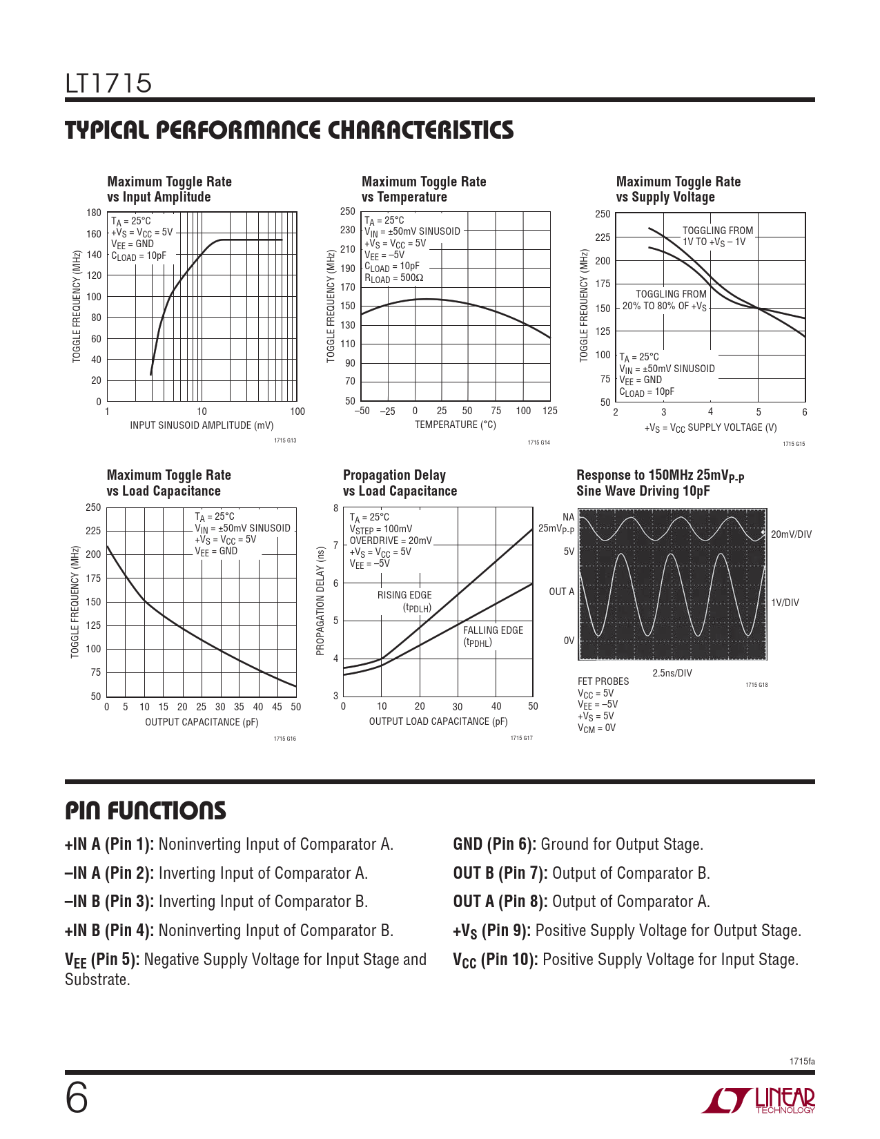

TYPICAL PERFORMANCE CHARACTERISTICS. Maximum Toggle Rate. vs Input Amplitude. vs Temperature. vs Supply Voltage
LT1715
TYPICAL PERFORMANCE CHARACTERISTICS Maximum Toggle Rate Maximum Toggle Rate Maximum Toggle Rate vs Input Amplitude vs Temperature vs Supply Voltage
180 250 250 TA = 25°C TA = 25°C 160 +V 230 TOGGLING FROM S = VCC = 5V VIN = ±50mV SINUSOID 225 V 1V TO +V EE = GND +V 210 S = VCC = 5V S – 1V 140 CLOAD = 10pF VEE = –5V 200 190 CLOAD = 10pF 120 RLOAD = 500Ω 170 175 100 TOGGLING FROM 150 150 20% TO 80% OF +VS 80 130 125 60 110 TOGGLE FREQUENCY (MHz) 40 TOGGLE FREQUENCY (MHz) 100 T 90 TOGGLE FREQUENCY (MHz) A = 25°C VIN = ±50mV SINUSOID 20 70 75 VEE = GND CLOAD = 10pF 0 50 50 1 10 100 –50 –25 0 25 50 75 100 125 2 3 4 5 6 INPUT SINUSOID AMPLITUDE (mV) TEMPERATURE (°C) +VS = VCC SUPPLY VOLTAGE (V) 1715 G13 1715 G14 1715 G15
Maximum Toggle Rate Propagation Delay Response to 150MHz 25mVP-P vs Load Capacitance vs Load Capacitance Sine Wave Driving 10pF
250 8 TA = 25°C TA = 25°C NA 225 VIN = ±50mV SINUSOID VSTEP = 100mV 25mVP-P 20mV/DIV +VS = VCC = 5V OVERDRIVE = 20mV 7 200 VEE = GND +VS = VCC = 5V 5V VEE = –5V 175 6 RISING EDGE OUT A 150 (t 1V/DIV PDLH) 125 5 FALLING EDGE (tPDHL) 0V 100 TOGGLE FREQUENCY (MHz) PROPAGATION DELAY (ns) 4 75 2.5ns/DIV FET PROBES 1715 G18 50 3 VCC = 5V 0 5 10 15 20 25 30 35 40 45 50 0 10 20 30 40 50 VEE = –5V +V OUTPUT CAPACITANCE (pF) OUTPUT LOAD CAPACITANCE (pF) S = 5V VCM = 0V 1715 G16 1715 G17
PIN FUNCTIONS +IN A (Pin 1):
Noninverting Input of Comparator A.
GND (Pin 6):
Ground for Output Stage.
–IN A (Pin 2):
Inverting Input of Comparator A.
OUT B (Pin 7):
Output of Comparator B.
–IN B (Pin 3):
Inverting Input of Comparator B.
OUT A (Pin 8):
Output of Comparator A.
+IN B (Pin 4):
Noninverting Input of Comparator B.
+VS (Pin 9):
Positive Supply Voltage for Output Stage.
VEE (Pin 5):
Negative Supply Voltage for Input Stage and
VCC (Pin 10):
Positive Supply Voltage for Input Stage. Substrate. 1715fa 6
