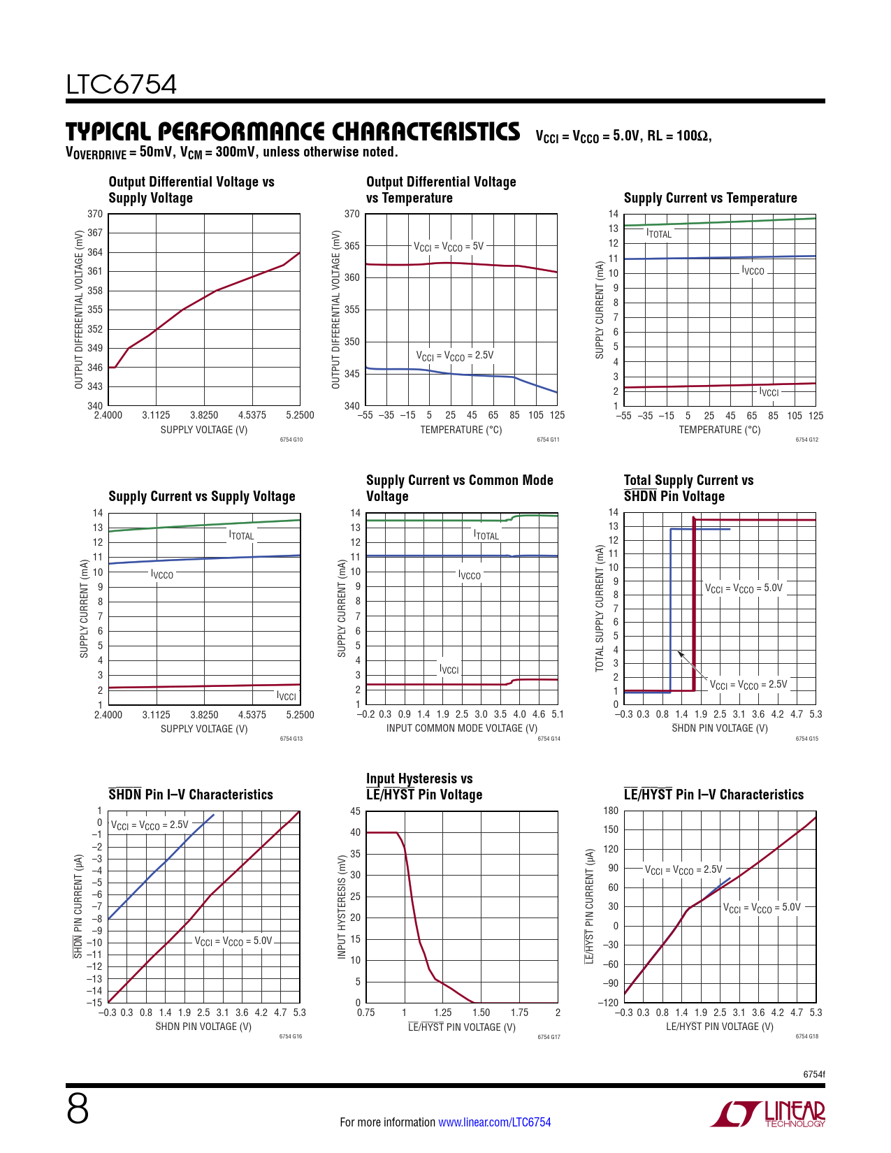

Typical perForMance characTerisTics VCCI = VCCO = 5.0V, RL = 100Ω,
LTC6754
Typical perForMance characTerisTics VCCI = VCCO = 5.0V, RL = 100Ω, VOVERDRIVE = 50mV, VCM = 300mV, unless otherwise noted. Output Differential Voltage vs oltage vs Output Differential Voltage oltage Supply Voltage vs Temperature vs T Supply Current vs Temperature Supply Current vs T
370 370 14 367 13 ITOTAL 365 12 364 VCCI = VCCO = 5V 11 TAGE (mV) 361 TAGE (mV) I 360 10 VCCO 358 9 8 355 355 7 352 Y CURRENT (mA) 6 350 349 5 VCCI = VCCO = 2.5V SUPPL 346 4 345 3 OUTPUT DIFFERENTIAL VOL 343 OUTPUT DIFFERENTIAL VOL 2 IVCCI 340 340 1 2.4000 3.1125 3.8250 4.5375 5.2500 –55 –35 –15 5 25 45 65 85 105 125 –55 –35 –15 5 25 45 65 85 105 125 SUPPLY VOLTAGE (V) TEMPERATURE (°C) TEMPERATURE (°C) 6754 G10 6754 G11 6754 G12
Supply Current vs Common Mode Supply Current vs Common Mode Total Supply Current vs Supply Current vs Supply Voltage Supply Current vs Supply V Voltage V SHDN Pin Voltage
14 14 14 13 13 13 ITOTAL I 12 TOTAL 12 12 11 11 11 10 I 10 VCCO 10 IVCCO 9 9 9 VCCI = VCCO = 5.0V 8 8 8 7 7 7 Y CURRENT (mA) Y CURRENT (mA) 6 6 Y CURRENT (mA) 6 5 5 5 SUPPL 4 AL SUPPL 4 SUPPL 4 I 3 TOT 3 VCCI 3 2 2 VCCI = VCCO = 2.5V I 2 1 VCCI 1 1 0 2.4000 3.1125 3.8250 4.5375 5.2500 –0.2 0.3 0.9 1.4 1.9 2.5 3.0 3.5 4.0 4.6 5.1 –0.3 0.3 0.8 1.4 1.9 2.5 3.1 3.6 4.2 4.7 5.3 SUPPLY VOLTAGE (V) INPUT COMMON MODE VOLTAGE (V) SHDN PIN VOLTAGE (V) 6754 G13 6754 G14 6754 G15
Input Hysteresis vs Input Hysteresis vs SHDN Pin I–V Characteristics LE/HYST LE/HYS Pin Voltage T Pin V LE/HYST Pin I–V Characteristics
1 45 180 0 VCCI = VCCO = 2.5V –1 40 150 –2 120 –3 35 –4 90 30 VCCI = VCCO = 2.5V –5 60 –6 25 –7 30 VCCI = VCCO = 5.0V –8 20 PIN CURRENT (µA) –9 PIN CURRENT (µA) 0 –10 VCCI = VCCO = 5.0V 15 –30 SHDN –11 INPUT HYSTERESIS (mV) /HYST –12 10 LE –60 –13 5 –90 –14 –15 0 –120 –0.3 0.3 0.8 1.4 1.9 2.5 3.1 3.6 4.2 4.7 5.3 0.75 1 1.25 1.50 1.75 2 –0.3 0.3 0.8 1.4 1.9 2.5 3.1 3.6 4.2 4.7 5.3 SHDN PIN VOLTAGE (V) LE/HYST PIN VOLTAGE (V) LE/HYST PIN VOLTAGE (V) 6754 G16 6754 G17 6754 G18 6754f 8 For more information www.linear.com/LTC6754 Document Outline Features Applications Typical Application Description Absolute Maximum Ratings Order Information Pin Configuration Electrical Characteristics Typical Performance Characteristics Pin Functions Applications Information Package Description Revision History Typical Application Related Parts
