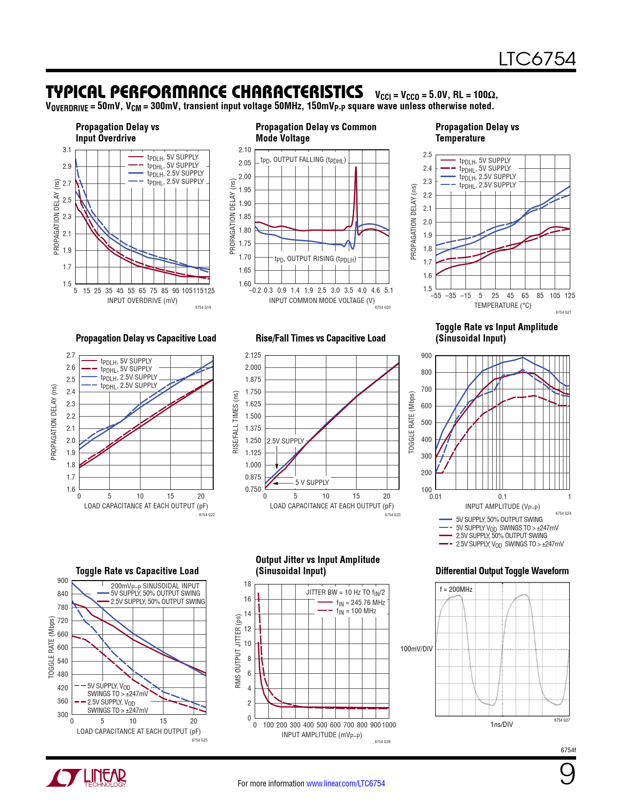

Typical perForMance characTerisTics VCCI = VCCO = 5.0V, RL = 100Ω,
LTC6754
Typical perForMance characTerisTics VCCI = VCCO = 5.0V, RL = 100Ω, VOVERDRIVE = 50mV, VCM = 300mV, transient input voltage 50MHz, 150mVP-P square wave unless otherwise noted. Propagation Delay vs Propagation Delay vs Propagation Delay vs Common Propagation Delay vs Common Propagation Delay vs Input Overdrive Mode Voltage Temperature
3.1 2.10 t 2.5 PDLH, 5V SUPPLY tPD, OUTPUT FALLING (tPDHL) t 2.9 t 2.05 PDLH, 5V SUPPLY PDHL, 5V SUPPLY 2.4 t t PDHL, 5V SUPPLY PDLH, 2.5V SUPPLY 2.00 tPDLH, 2.5V SUPPLY 2.7 tPDHL, 2.5V SUPPLY 2.3 tPDHL, 2.5V SUPPLY Y (ns) 1.95 Y (ns) 2.2 2.5 Y (ns) 1.90 2.1 2.3 1.85 TION DELA TION DELA 2.0 2.1 1.80 TION DELA AGA AGA 1.9 1.75 AGA 1.9 PROP PROP 1.8 1.70 tPD, OUTPUT RISING (tPDLH) PROP 1.7 1.7 1.65 1.6 1.5 1.60 5 15 25 35 45 55 65 75 85 95 105115125 –0.2 0.3 0.9 1.4 1.9 2.5 3.0 3.5 4.0 4.6 5.1 1.5–55 –35 –15 5 25 45 65 85 105 125 INPUT OVERDRIVE (mV) INPUT COMMON MODE VOLTAGE (V) 6754 G19 6754 G20 TEMPERATURE (°C) 6754 G21
Toggle Rate vs Input Amplitude Propagation Delay vs Capacitive Load Rise/Fall Times vs Capacitive Load (Sinusoidal Input)
2.7 2.125 900 tPDLH, 5V SUPPLY 2.6 tPDHL, 5V SUPPLY 2.000 800 t 2.5 PDLH, 2.5V SUPPLY 1.875 tPDHL, 2.5V SUPPLY 700 2.4 1.750 Y (ns) 2.3 1.625 600 2.2 1.500 TE (Mbps) 500 TION DELA 2.1 1.375 ALL TIMES (ns) AGA 2.0 1.250 2.5V SUPPLY 400 1.9 RISE/F 1.125 TOGGLE RA 300 PROP 1.8 1.000 200 1.7 0.875 5 V SUPPLY 1.6 0.750 100 0 5 10 15 20 0 5 10 15 20 0.01 0.1 1 LOAD CAPACITANCE AT EACH OUTPUT (pF) LOAD CAPACITANCE AT EACH OUTPUT (pF) INPUT AMPLITUDE (VP–P) 6754 G24 6754 G22 6754 G23 5V SUPPLY, 50% OUTPUT SWING 5V SUPPLY VOD SWINGS TO > ±247mV 2.5V SUPPLY, 50% OUTPUT SWING 2.5V SUPPLY, VOD SWINGS TO > ±247mV
Output Jitter vs Input Amplitude Toggle Rate vs Capacitive Load (Sinusoidal Input) Differential Output Toggle Waveform
