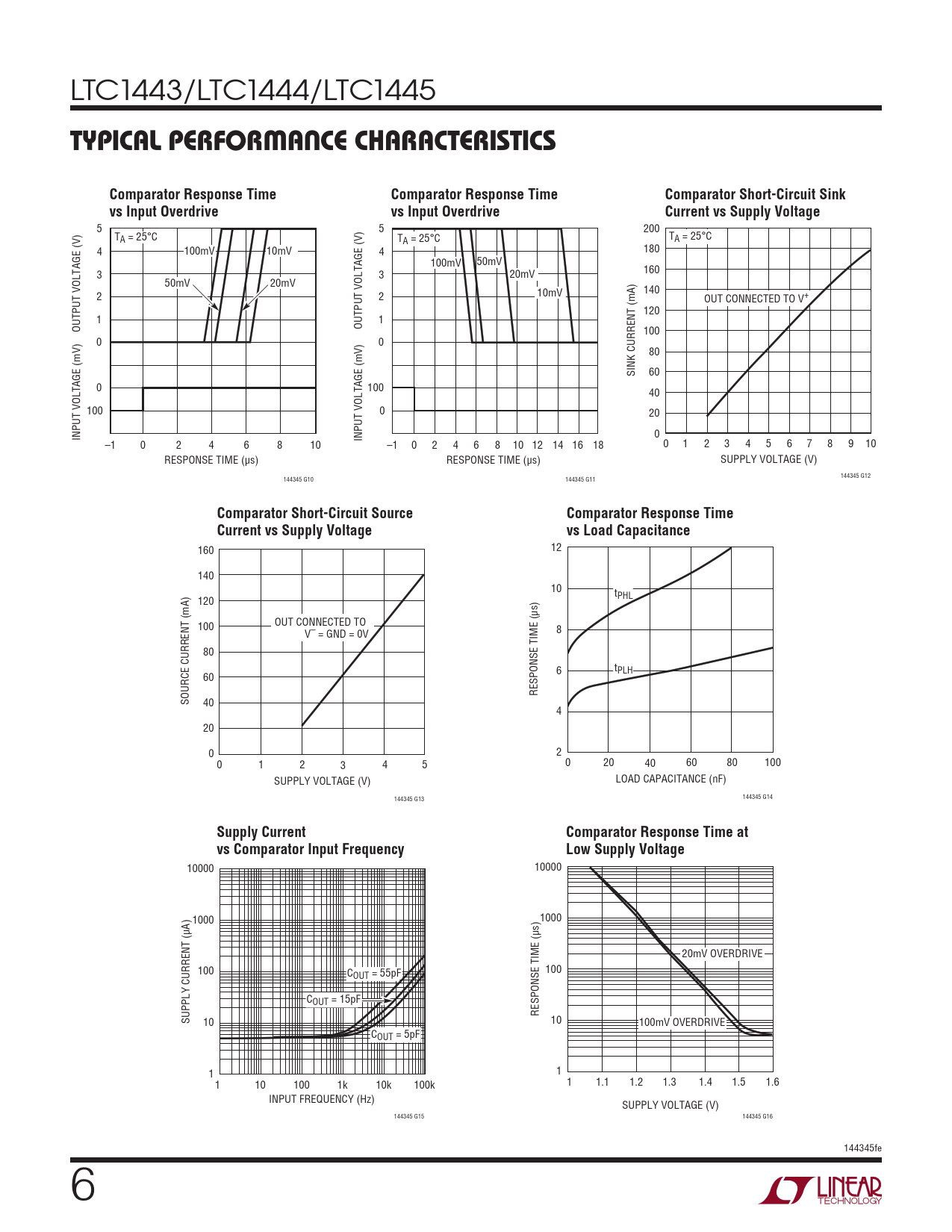

Typical perForMance characTerisTics. Comparator Response Time. Comparator Short-Circuit Sink. vs Input Overdrive
LTC1443/LTC1444/LTC1445
Typical perForMance characTerisTics Comparator Response Time Comparator Response Time Comparator Short-Circuit Sink vs Input Overdrive vs Input Overdrive Current vs Supply Voltage
5 5 200 TA = 25°C TA = 25°C TA = 25°C 4 100mV 10mV 4 180 100mV 50mV 3 3 20mV 160 50mV 20mV 2 2 10mV 140 OUT CONNECTED TO V+ 120 1 1 OUTPUT VOLTAGE (V) OUTPUT VOLTAGE (V) 100 0 0 80 SINK CURRENT (mA) 60 0 100 40 100 0 20 INPUT VOLTAGE (mV) INPUT VOLTAGE (mV) 0 –1 0 2 4 6 8 10 –1 0 2 4 6 8 10 12 14 16 18 0 1 2 3 4 5 6 7 8 9 10 RESPONSE TIME (µs) RESPONSE TIME (µs) SUPPLY VOLTAGE (V) 144345 G10 144345 G11 144345 G12
Comparator Short-Circuit Source Comparator Response Time Current vs Supply Voltage vs Load Capacitance
160 12 140 10 t 120 PHL 100 OUT CONNECTED TO V– = GND = 0V 8 80 6 t 60 PLH RESPONSE TIME (µs) SOURCE CURRENT (mA) 40 4 20 0 2 0 1 2 3 4 5 0 20 40 60 80 100 SUPPLY VOLTAGE (V) LOAD CAPACITANCE (nF) 144345 G13 144345 G14
Supply Current Comparator Response Time at vs Comparator Input Frequency Low Supply Voltage
