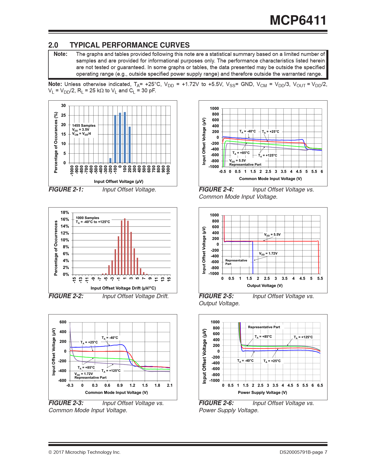

MCP6411. 2.0 TYPICAL PERFORMANCE CURVES
MCP6411
The graphs and tables provided following this note are a statistical summary based on a limited number of
samples and are provided for informational purposes only. The performance characteristics listed herein
are not tested or guaranteed. In some graphs or tables, the data presented may be outside the specified
operating range (e.g., outside specified power supply range) and therefore outside the warranted range. Note: Note: Unless otherwise indicated, TA= +25°C, VDD = +1.72V to +5.5V, VSS= GND, VCM = VDD/3, VOUT = VDD/2,

Common Mode Input Voltage (V) Input Offset Voltage (μV) FIGURE 2-1: Input Offset Voltage. FIGURE 2-4:
Input Offset Voltage vs.
Common Mode Input Voltage. 1000 Samples

15 Percentage of Occurrences 18% 0.5 1 Input Offset Voltage Drift. FIGURE 2-5:
Output Voltage. 400

-0.3 0 0.3 0.6 0.9 1.2 1.5 1.8 Common Mode Input Voltage (V) FIGURE 2-3:
Common Mode Input Voltage. 2017 Microchip Technology Inc. 2.1 Input Offset Voltage (μV) Input Offset Voltage (μV) 600 200 2 2.5 3 3.5 4 4.5 5 5.5 Output Voltage (V) Input Offset Voltage Drift (μV/°C) FIGURE 2-2: 1.5 1000

TA = +85°C TA = -40°C TA = +125°C TA = +25°C 0 0.5 1 1.5 2 2.5 3 3.5 4 4.5 5 5.5 6 6.5
Power Supply Voltage (V) FIGURE 2-6:
Power Supply Voltage. DS20005791B-page 7
