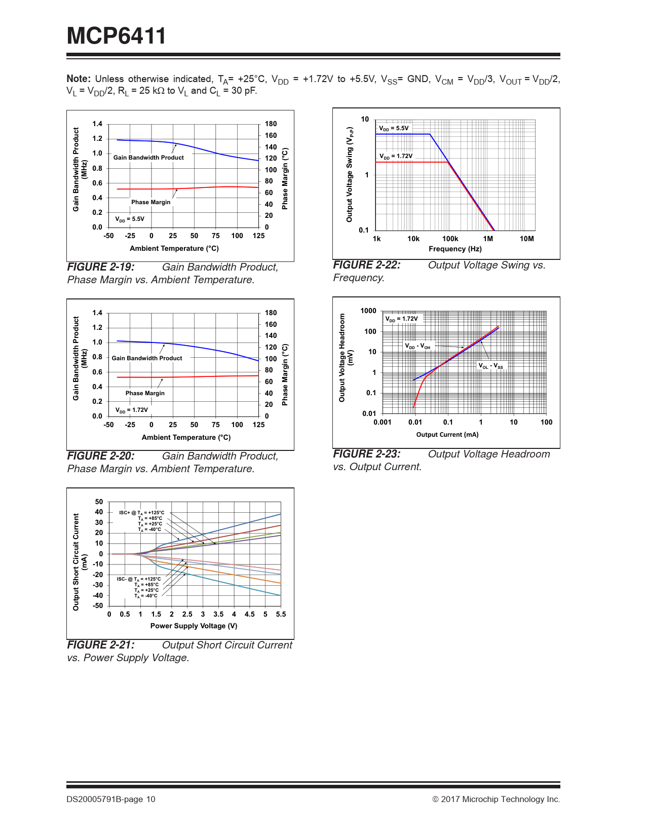

Pages / Page34 / 10 — MCP6411 180 1.2 160. 140 1.0 Gain Bandwidth Product 120 0.8 100 0.6 80
MCP6411 180 1.2 160 140 1.0 Gain Bandwidth Product 120 0.8 100 0.6 80
MCP6411 180 1.2 160
60 0.4 Phase Margin 40 0.2 10 20 VDD = 5.5V 0.0 Output Voltage Swing (VP-P) 1.4 Phase Margin (°C) Gain Bandwidth Product
(MHz) Note: Unless otherwise indicated, TA= +25°C, VDD = +1.72V to +5.5V, VSS= GND, VCM = VDD/3, VOUT = VDD/2,
VL = VDD/2, RL = 25 k to VL and CL = 30 pF. 0
-50 -25 0 25 50 75 100 VDD = 5.5V VDD = 1.72V 1 0.1 125 1000 10000 1k 10k Ambient Temperature (°C) 180 1.2 160
140 1.0 120 0.8 Gain Bandwidth Product 100
80 0.6 60 0.4 40 Phase Margin 0.2 20 VDD = 1.72V 0.0
-50 -25 Phase Margin (°C) Gain Bandwidth Product
(MHz) 1.4 25 50 75 100 125 FIGURE 2-20:
Gain Bandwidth Product,
Phase Margin vs. Ambient Temperature. Output Short Circuit Current
(mA) 10000000 10M Output Voltage Swing vs. VDD = 1.72V 100
10 VDD -VOH
VOL -VSS 1
0.1 0.01 0.1 1 10 100 Output Current (mA) Ambient Temperature (°C) 50
40
30
20
10
0
-10
-20
-30
-40
-50 1000000 1000 0.01
0.001 0
0 Output Voltage Headroom
(mV) FIGURE 2-22:
Frequency. FIGURE 2-19:
Phase Margin vs. Ambient Temperature. 100000 100k
1M
Frequency (Hz) FIGURE 2-23:
vs. Output Current. ISC+ @ TA = +125°C
TA = +85°C
TA = +25°C
TA = -40°C ISC-@ TA = +125°C
TA = +85°C
TA = +25°C
TA = -40°C 0 0.5 1 1.5 2 2.5 3 3.5 4 4.5 5 5.5 Power Supply Voltage (V) FIGURE 2-21:
