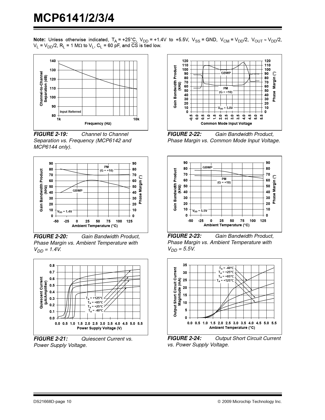

MCP6141/2/3/4. Note:. 140. 120. 110. 130. 100. GBWP. nne. Produ. ) 70. Hz 60. arg. tion (dB 110. l-to-C. (k 50. (G = +10). para. anne. in Bandwidt. VDD = 5.0V
MCP6141/2/3/4 Note: 140 120 110 130 100 GBWP nne Produ ) 70 Hz 60 arg tion (dB 110 l-to-C (k 50 (G = +10) para anne in Bandwidt VDD = 5.0V
MCP6141/2/3/4 Note:
Unless otherwise indicated, TA = +25°C, VDD = +1.4V to +5.5V, VSS = GND, VCM = VDD/2, VOUT ≈ VDD/2, VL = VDD/2, RL = 1 MΩ to VL, CL = 60 pF, and CS is tied low.
140 120 120 t 110 110 c 130 l 100 100 ) 90 GBWP 90 °) nne ( 120 80 Produ 80 in ha h ) 70 70 Hz 60 60 arg tion (dB 110 PM M l-to-C (k 50 50 (G = +10) e para 40 40 100 as anne 30 30 h Se in Bandwidt Ph C 20 20 90 Ga 10 VDD = 5.0V 10 Input Referred 0 0 80 .5 0 5 0 5 0 5 0 5 0 5 0 5 0. 0. 1. 1. 2. 2. 3. 3. 4. 4. 5. 5. 1.E+03 1k 1.E+ 10 0 k 4 -0 Frequency (Hz) Common Mode Input Voltage FIGURE 2-19:
Channel to Channel
FIGURE 2-22:
Gain Bandwidth Product, Separation vs. Frequency (MCP6142 and Phase Margin vs. Common Mode Input Voltage. MCP6144 only).
90 90 90 90 t PM 80 80 t 80 GBWP 80 (G = +10) c uc 70 70 70 70 PM (°) 60 (°) 60 60 Prod 60 in Produ (G = +10) in h ) 50 50 50 50 rg idth Hz) arg Hz w GBWP (k 40 40 M (k 40 40 e Ma nd 30 30 ase 30 30 as 20 20 Ph 20 Ph in Bandwidt 20 Gain Ba 10 10 Ga 10 10 V V DD = 1.4V DD = 5.5V 0 0 0 0 -50 -25 0 25 50 75 100 125 -50 -25 0 25 50 75 100 125 Ambient Temperature (°C) Ambient Temperature (°C) FIGURE 2-20:
FIGURE 2-23:
Gain Bandwidth Product, Phase Margin vs. Ambient Temperature with Phase Margin vs. Ambient Temperature with V V DD = 1.4V. DD = 5.5V.
0.8 35 t TA = -40°C 0.7 30 T rren A = +25°C t u T 0.6 ) A = +85°C 25 t C TA = +125°C rren r) u 0.5 ui 20 t C irc 0.4 de (mA rt C 15 cen 0.3 A/Amplifie TA = +125°C gnitu ies T Sho u 10 0.2 A = +85°C Ma Q TA = +25°C 0.1 T tput 5 A = -40°C u O 0.0 0 0.0 0.5 1.0 1.5 2.0 2.5 3.0 3.5 4.0 4.5 5.0 5.5 0.0 0.5 1.0 1.5 2.0 2.5 3.0 3.5 4.0 4.5 5.0 5.5 Power Supply Voltage (V) Ambient Temperature (°C) FIGURE 2-21:
Quiescent Current vs.
FIGURE 2-24:
Output Short Circuit Current Power Supply Voltage. vs. Power Supply Voltage. DS21668D-page 10 © 2009 Microchip Technology Inc. Document Outline 1.0 Electrical Characteristics FIGURE 1-1: Chip Select (CS) Timing Diagram (MCP6143 only). 1.1 Test Circuits FIGURE 1-2: AC and DC Test Circuit for Most Non-Inverting Gain Conditions. FIGURE 1-3: AC and DC Test Circuit for Most Inverting Gain Conditions. 2.0 Typical Performance Curves FIGURE 2-1: Input Offset Voltage. FIGURE 2-2: Input Offset Voltage Drift with TA = -40°C to +85°C. FIGURE 2-3: Input Offset Voltage vs. Common Mode Input Voltage with VDD = 1.4V. FIGURE 2-4: Input Offset Voltage Drift with TA = +85°C to +125°C and VDD = 1.4V. FIGURE 2-5: Input Offset Voltage Drift with TA = +85°C to +125°C and VDD = 5.5V. FIGURE 2-6: Input Offset Voltage vs. Common Mode Input Voltage with VDD = 5.5V. FIGURE 2-7: Input Offset Voltage vs. Output Voltage. FIGURE 2-8: Input Noise Voltage Density vs. Frequency. FIGURE 2-9: CMRR, PSRR vs. Frequency. FIGURE 2-10: The MCP6141/2/3/4 Family Shows No Phase Reversal. FIGURE 2-11: Input Noise Voltage Density vs. Common Mode Input Voltage. FIGURE 2-12: CMRR, PSRR vs. Ambient Temperature. FIGURE 2-13: Input Bias, Offset Currents vs. Ambient Temperature. FIGURE 2-14: Open-Loop Gain, Phase vs. Frequency. FIGURE 2-15: DC Open-Loop Gain vs. Power Supply Voltage. FIGURE 2-16: Input Bias, Offset Currents vs. Common Mode Input Voltage. FIGURE 2-17: DC Open-Loop Gain vs. Load Resistance. FIGURE 2-18: DC Open-Loop Gain vs. Output Voltage Headroom. FIGURE 2-19: Channel to Channel Separation vs. Frequency (MCP6142 and MCP6144 only). FIGURE 2-20: Gain Bandwidth Product, Phase Margin vs. Ambient Temperature with VDD = 1.4V. FIGURE 2-21: Quiescent Current vs. Power Supply Voltage. FIGURE 2-22: Gain Bandwidth Product, Phase Margin vs. Common Mode Input Voltage. FIGURE 2-23: Gain Bandwidth Product, Phase Margin vs. Ambient Temperature with VDD = 5.5V. FIGURE 2-24: Output Short Circuit Current vs. Power Supply Voltage. FIGURE 2-25: Output Voltage Headroom vs. Output Current Magnitude. FIGURE 2-26: Slew Rate vs. Ambient Temperature. FIGURE 2-27: Small Signal Non-inverting Pulse Response. FIGURE 2-28: Output Voltage Headroom vs. Ambient Temperature. FIGURE 2-29: Maximum Output Voltage Swing vs. Frequency. FIGURE 2-30: Small Signal Inverting Pulse Response. FIGURE 2-31: Large Signal Non-inverting Pulse Response. FIGURE 2-32: Chip Select (CS) to Amplifier Output Response Time (MCP6143 only). FIGURE 2-33: Input Current vs. Input Voltage (Below VSS). FIGURE 2-34: Large Signal Inverting Pulse Response. FIGURE 2-35: Internal Chip Select (CS) Hysteresis (MCP6143 only). 3.0 Pin Descriptions TABLE 3-1: Pin Function Table 3.1 Analog Outputs 3.2 Analog Inputs 3.3 CS Digital Input 3.4 Power Supply Pins 4.0 Applications Information 4.1 Rail-to-Rail Input FIGURE 4-1: Simplified Analog Input ESD Structures. FIGURE 4-2: Protecting the Analog Inputs. 4.2 Rail-to-Rail Output 4.3 Output Loads and Battery Life 4.4 Stability FIGURE 4-3: Noise Gain for Non-inverting Gain Configuration. FIGURE 4-4: Noise Gain for Inverting Gain Configuration. FIGURE 4-5: Examples of Unstable Circuits for the MCP6141/2/3/4 Family. FIGURE 4-6: Output Resistor, RISO stabilizes large capacitive loads. FIGURE 4-7: Recommended RISO Values for Capacitive Loads. 4.5 MCP6143 Chip Select 4.6 Supply Bypass 4.7 Unused Op Amps FIGURE 4-8: Unused Op Amps. 4.8 PCB Surface Leakage FIGURE 4-9: Example Guard Ring Layout for Inverting Gain. 4.9 Application Circuits FIGURE 4-10: High Side Battery Current Sensor. FIGURE 4-11: Summing Amplifier. 5.0 Design Aids 5.1 SPICE Macro Model 5.2 FilterLab® Software 5.3 Mindi™ Simulation Tool 5.4 Microchip Advanced Part Selector (MAPS) 5.5 Analog Demonstration and Evaluation Boards 5.6 Application Notes 6.0 Packaging Information 6.1 Package Marking Information
