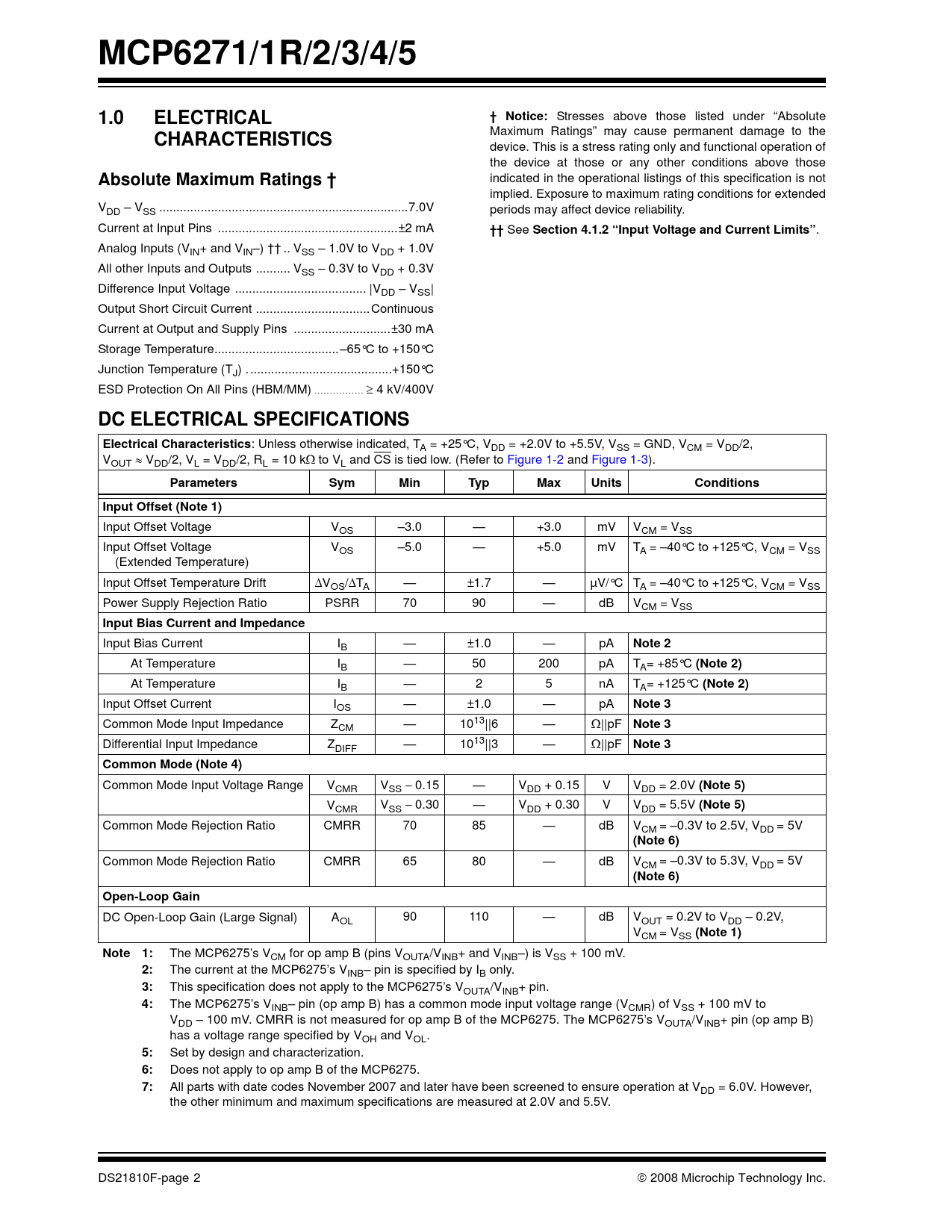

MCP6271/1R/2/3/4/5. 1.0. ELECTRICAL. † Notice:. CHARACTERISTICS. Absolute Maximum Ratings †
MCP6271/1R/2/3/4/5 1.0 ELECTRICAL † Notice: CHARACTERISTICS Absolute Maximum Ratings †
link to page 13 link to page 2 link to page 2 link to page 2 link to page 2 link to page 2 link to page 2 link to page 2 link to page 2 link to page 2 link to page 2 link to page 2 link to page 2 link to page 2 link to page 5 link to page 5
Stresses above those listed under “Absolute Maximum Ratings” may cause permanent damage to the
CHARACTERISTICS
device. This is a stress rating only and functional operation of the device at those or any other conditions above those
indicated in the operational listings of this specification is not implied. Exposure to maximum rating conditions for extended VDD – VSS ..7.0V periods may affect device reliability. Current at Input Pins ..±2 mA
See
Section 4.1.2 “Input Voltage and Current Limits”
. Analog Inputs (VIN+ and VIN–) †† .. VSS – 1.0V to VDD + 1.0V All other Inputs and Outputs .. VSS – 0.3V to VDD + 0.3V Difference Input Voltage .. |VDD – VSS| Output Short Circuit Current ...Continuous Current at Output and Supply Pins ..±30 mA Storage Temperature.. –65°C to +150°C Junction Temperature (TJ) ..+150°C ESD Protection On All Pins (HBM/MM) .. ≥ 4 kV/400V
DC ELECTRICAL SPECIFICATIONS Electrical Characteristics
: Unless otherwise indicated, TA = +25°C, VDD = +2.0V to +5.5V, VSS = GND, VCM = VDD/2, V ≈ OUT VDD/2, VL = VDD/2, RL = 10 kΩ to VL and CS is tied low. (Refer to Figure 1-2 and Figure 1-3).
Parameters Sym Min Typ Max Units Conditions Input Offset (Note 1 )
Input Offset Voltage VOS –3.0 — +3.0 mV VCM = VSS Input Offset Voltage VOS –5.0 — +5.0 mV TA = –40°C to +125°C, VCM = VSS (Extended Temperature) Input Offset Temperature Drift ΔVOS/ΔTA — ±1.7 — µV/°C TA = –40°C to +125°C, VCM = VSS Power Supply Rejection Ratio PSRR 70 90 — dB VCM = VSS
Input Bias Current and Impedance
Input Bias Current IB — ±1.0 — pA
Note 2
At Temperature IB — 50 200 pA TA= +85°C
(Note 2)
At Temperature IB — 2 5 nA TA= +125°C
(Note 2 )
Input Offset Current IOS — ±1.0 — pA
Note 3
Common Mode Input Impedance ZCM — 1013||6 — Ω||pF
Note 3
Differential Input Impedance ZDIFF — 1013||3 — Ω||pF
Note 3 Common Mode (Note 4)
Common Mode Input Voltage Range V − CMR VSS 0.15 — VDD + 0.15 V VDD = 2.0V
(Note 5)
V − CMR VSS 0.30 — VDD + 0.30 V VDD = 5.5V
(Note 5)
Common Mode Rejection Ratio CMRR 70 85 — dB VCM = –0.3V to 2.5V, VDD = 5V
(Note 6 )
Common Mode Rejection Ratio CMRR 65 80 — dB VCM = –0.3V to 5.3V, VDD = 5V
(Note 6 ) Open-Loop Gain
DC Open-Loop Gain (Large Signal) AOL 90 110 — dB VOUT = 0.2V to VDD – 0.2V, VCM = VSS
(Note 1 ) Note 1:
The MCP6275’s VCM for op amp B (pins VOUTA/VINB+ and VINB–) is VSS + 100 mV.
2:
The current at the MCP6275’s VINB– pin is specified by IB only.
3:
This specification does not apply to the MCP6275’s VOUTA/VINB+ pin.
4:
The MCP6275’s VINB– pin (op amp B) has a common mode input voltage range (VCMR) of VSS + 100 mV to VDD – 100 mV. CMRR is not measured for op amp B of the MCP6275. The MCP6275’s VOUTA/VINB+ pin (op amp B) has a voltage range specified by VOH and VOL.
5:
Set by design and characterization.
6:
Does not apply to op amp B of the MCP6275.
7:
All parts with date codes November 2007 and later have been screened to ensure operation at VDD = 6.0V. However, the other minimum and maximum specifications are measured at 2.0V and 5.5V. DS21810F-page 2 © 2008 Microchip Technology Inc. Document Outline 1.0 Electrical Characteristics FIGURE 1-1: Timing Diagram for the Chip Select (CS) pin on the MCP6273 and MCP6275. 1.1 Test Circuits FIGURE 1-2: AC and DC Test Circuit for Most Non-Inverting Gain Conditions. FIGURE 1-3: AC and DC Test Circuit for Most Inverting Gain Conditions. 2.0 Typical Performance Curves FIGURE 2-1: Input Offset Voltage. FIGURE 2-2: Input Bias Current at TA = +85˚C. FIGURE 2-3: Input Offset Voltage vs. Common Mode Input Voltage, with VDD = 2.0V. FIGURE 2-4: Input Offset Voltage Drift. FIGURE 2-5: Input Bias Current at TA = +125˚C. FIGURE 2-6: Input Offset Voltage vs. Common Mode Input Voltage, with VDD = 5.5V. FIGURE 2-7: Common Mode Input Voltage Range Lower Limit vs. Temperature. FIGURE 2-8: Input Offset Voltage vs. Output Voltage. FIGURE 2-9: CMRR, PSRR vs. Frequency. FIGURE 2-10: Common Mode Input Voltage Range Upper Limit vs. Temperature. FIGURE 2-11: Input Bias, Input Offset Currents vs. Temperature. FIGURE 2-12: CMRR, PSRR vs. Temperature. FIGURE 2-13: Input Bias, Offset Currents vs. Common Mode Input Voltage, with TA = +85˚C. FIGURE 2-14: Quiescent Current vs. Supply Voltage. FIGURE 2-15: Open-Loop Gain, Phase vs. Frequency. FIGURE 2-16: Input Bias, Offset Currents vs. Common Mode Input Voltage, with TA = +125˚C. FIGURE 2-17: Output Voltage Headroom vs. Output Current Magnitude. FIGURE 2-18: Gain Bandwidth Product, Phase Margin vs. Temperature. FIGURE 2-19: Maximum Output Voltage Swing vs. Frequency. FIGURE 2-20: Input Noise Voltage Density vs. Frequency. FIGURE 2-21: Output Short Circuit Current vs. Supply Voltage. FIGURE 2-22: Slew Rate vs. Temperature. FIGURE 2-23: Input Noise Voltage Density vs. Common Mode Input Voltage, with f = 1 kHz. FIGURE 2-24: Channel-to-Channel Separation vs. Frequency (MCP6272 and MCP6274). FIGURE 2-25: Quiescent Current vs. Chip Select (CS) Voltage, with VDD = 2.0V (MCP6273 and MCP6275 only). FIGURE 2-26: Large Signal Non-inverting Pulse Response. FIGURE 2-27: Small Signal Non-inverting Pulse Response. FIGURE 2-28: Quiescent Current vs. Chip Select (CS) Voltage, with VDD = 5.5V (MCP6273 and MCP6275 only). FIGURE 2-29: Large Signal Inverting Pulse Response. FIGURE 2-30: Small Signal Inverting Pulse Response. FIGURE 2-31: Chip Select (CS) to Amplifier Output Response Time, with VDD = 2.0V (MCP6273 and MCP6275 only). FIGURE 2-32: Input Current vs. Input Voltage. FIGURE 2-33: Chip Select (CS) to Amplifier Output Response Time, with VDD = 5,5V (MCP6273 and MCP6275 only). FIGURE 2-34: The MCP6271/1R/2/3/4/5 Show no Phase Reversal. 3.0 Pin Descriptions TABLE 3-1: Pin Function Table for Single Op Amps TABLE 3-2: Pin Function Table for Dual and Quad Op Amps 3.1 Analog Outputs 3.2 Analog Inputs 3.3 MCP6275’s VOUTA/VINB+ Pin 3.4 Chip Select Digital Input 3.5 Power Supply Pins 4.0 Application Information 4.1 Rail-to-Rail Inputs FIGURE 4-1: Simplified Analog Input ESD Structures. FIGURE 4-2: Protecting the Analog Inputs. 4.2 Rail-to-Rail Output 4.3 Capacitive Loads FIGURE 4-3: Output Resistor, RISO stabilizes large capacitive loads. FIGURE 4-4: Recommended RISO Values for Capacitive Loads. 4.4 MCP6273/5 Chip Select 4.5 Cascaded Dual Op Amps (MCP6275) FIGURE 4-5: Cascaded Gain Amplifier. 4.6 Unused Amplifiers FIGURE 4-6: Unused Op Amps. 4.7 Supply Bypass 4.8 PCB Surface Leakage FIGURE 4-7: Example Guard Ring Layout for Inverting Gain. 4.9 Application Circuits FIGURE 4-8: Active Full-wave Rectifier. FIGURE 4-9: Non-Inverting Integrator. FIGURE 4-10: Isolating the Load with a Buffer. FIGURE 4-11: Cascaded Gain Circuit Configuration. FIGURE 4-12: Difference Amplifier Circuit. FIGURE 4-13: Integrator Circuit with Active Compensation. FIGURE 4-14: Second Order Multiple Feedback Low-Pass Filter with an Extra Pole- Zero Pair. FIGURE 4-15: Second Order Sallen-Key Low-Pass Filter with an Extra Pole-Zero Pair and Chip Select. FIGURE 4-16: Capacitorless Second Order Low-Pass Filter with Chip Select. 5.0 Design Tools 5.1 SPICE Macro Model 5.2 FilterLab® Software 5.3 Mindi™ Circuit Designer & Simulator 5.4 MAPS (Microchip Advanced Part Selector) 5.5 Analog Demonstration and Evaluation Boards 5.6 Application Notes 6.0 Packaging Information 6.1 Package Marking Information
