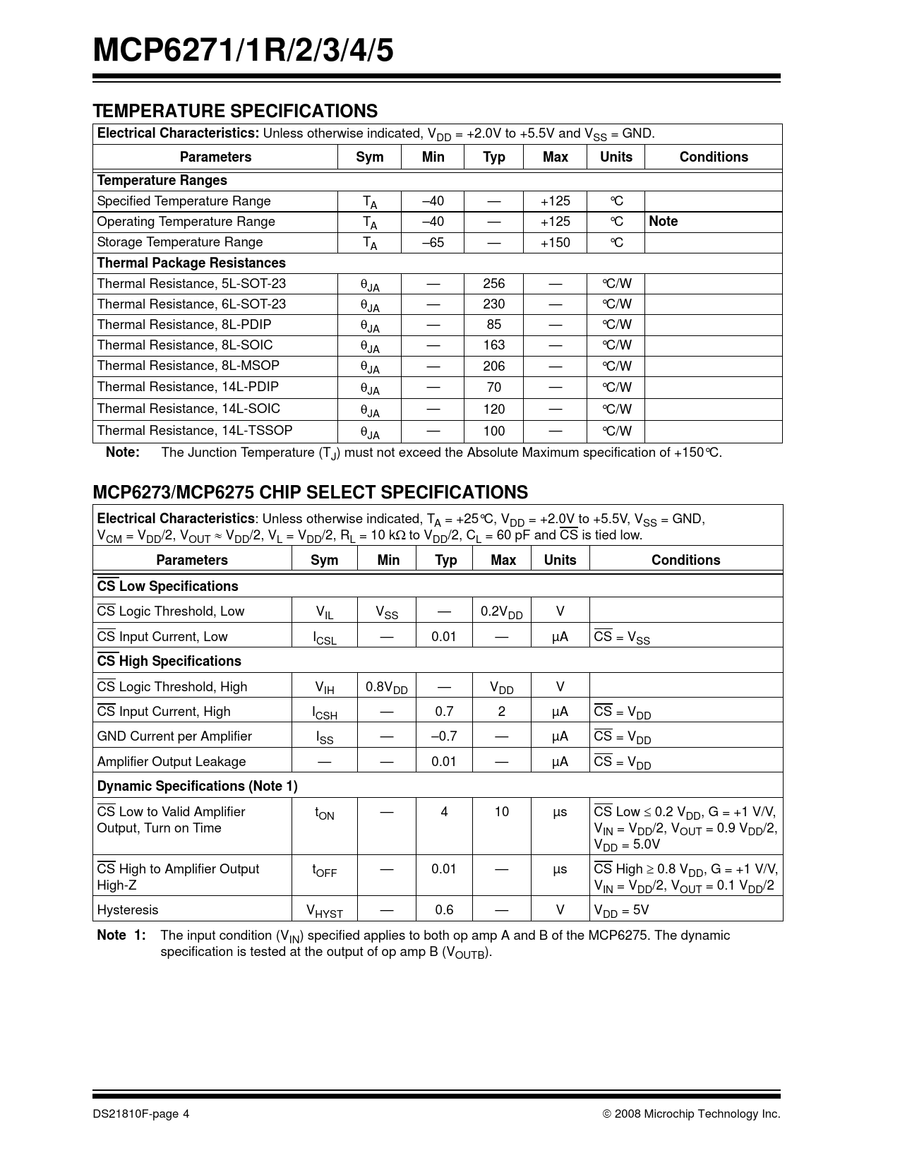

MCP6271/1R/2/3/4/5. TEMPERATURE SPECIFICATIONS. Electrical Characteristics:. Parameters. Sym. Min. Typ. Max. Units. Conditions
MCP6271/1R/2/3/4/5 TEMPERATURE SPECIFICATIONS Electrical Characteristics: Parameters Sym Min Typ Max Units Conditions
link to page 4 link to page 4
Unless otherwise indicated, VDD = +2.0V to +5.5V and VSS = GND.
Parameters Sym Min Typ Max Units Conditions Temperature Ranges
Specified Temperature Range TA –40 — +125 °C Operating Temperature Range TA –40 — +125 °C
Note
Storage Temperature Range TA –65 — +150 °C
Thermal Package Resistances
Thermal Resistance, 5L-SOT-23 θJA — 256 — °C/W Thermal Resistance, 6L-SOT-23 θJA — 230 — °C/W Thermal Resistance, 8L-PDIP θJA — 85 — °C/W Thermal Resistance, 8L-SOIC θJA — 163 — °C/W Thermal Resistance, 8L-MSOP θJA — 206 — °C/W Thermal Resistance, 14L-PDIP θJA — 70 — °C/W Thermal Resistance, 14L-SOIC θJA — 120 — °C/W Thermal Resistance, 14L-TSSOP θJA — 100 — °C/W
Note:
The Junction Temperature (TJ) must not exceed the Absolute Maximum specification of +150°C.
MCP6273/MCP6275 CHIP SELECT SPECIFICATIONS Electrical Characteristics
: Unless otherwise indicated, TA = +25°C, VDD = +2.0V to +5.5V, VSS = GND, V ≈ CM = VDD/2, VOUT VDD/2, VL = VDD/2, RL = 10 kΩ to VDD/2, CL = 60 pF and CS is tied low.
Parameters Sym Min Typ Max Units Conditions CS Low Specifications
CS Logic Threshold, Low VIL VSS — 0.2VDD V CS Input Current, Low ICSL — 0.01 — µA CS = VSS
CS High Specifications
CS Logic Threshold, High VIH 0.8VDD — VDD V CS Input Current, High ICSH — 0.7 2 µA CS = VDD GND Current per Amplifier ISS — –0.7 — µA CS = VDD Amplifier Output Leakage — — 0.01 — µA CS = VDD
Dynamic Specifications (Note 1)
CS Low to Valid Amplifier tON — 4 10 µs CS Low ≤ 0.2 VDD, G = +1 V/V, Output, Turn on Time VIN = VDD/2, VOUT = 0.9 VDD/2, VDD = 5.0V CS High to Amplifier Output tOFF — 0.01 — µs CS High ≥ 0.8 VDD, G = +1 V/V, High-Z VIN = VDD/2, VOUT = 0.1 VDD/2 Hysteresis VHYST — 0.6 — V VDD = 5V
Note 1:
The input condition (VIN) specified applies to both op amp A and B of the MCP6275. The dynamic specification is tested at the output of op amp B (VOUTB). DS21810F-page 4 © 2008 Microchip Technology Inc. Document Outline 1.0 Electrical Characteristics FIGURE 1-1: Timing Diagram for the Chip Select (CS) pin on the MCP6273 and MCP6275. 1.1 Test Circuits FIGURE 1-2: AC and DC Test Circuit for Most Non-Inverting Gain Conditions. FIGURE 1-3: AC and DC Test Circuit for Most Inverting Gain Conditions. 2.0 Typical Performance Curves FIGURE 2-1: Input Offset Voltage. FIGURE 2-2: Input Bias Current at TA = +85˚C. FIGURE 2-3: Input Offset Voltage vs. Common Mode Input Voltage, with VDD = 2.0V. FIGURE 2-4: Input Offset Voltage Drift. FIGURE 2-5: Input Bias Current at TA = +125˚C. FIGURE 2-6: Input Offset Voltage vs. Common Mode Input Voltage, with VDD = 5.5V. FIGURE 2-7: Common Mode Input Voltage Range Lower Limit vs. Temperature. FIGURE 2-8: Input Offset Voltage vs. Output Voltage. FIGURE 2-9: CMRR, PSRR vs. Frequency. FIGURE 2-10: Common Mode Input Voltage Range Upper Limit vs. Temperature. FIGURE 2-11: Input Bias, Input Offset Currents vs. Temperature. FIGURE 2-12: CMRR, PSRR vs. Temperature. FIGURE 2-13: Input Bias, Offset Currents vs. Common Mode Input Voltage, with TA = +85˚C. FIGURE 2-14: Quiescent Current vs. Supply Voltage. FIGURE 2-15: Open-Loop Gain, Phase vs. Frequency. FIGURE 2-16: Input Bias, Offset Currents vs. Common Mode Input Voltage, with TA = +125˚C. FIGURE 2-17: Output Voltage Headroom vs. Output Current Magnitude. FIGURE 2-18: Gain Bandwidth Product, Phase Margin vs. Temperature. FIGURE 2-19: Maximum Output Voltage Swing vs. Frequency. FIGURE 2-20: Input Noise Voltage Density vs. Frequency. FIGURE 2-21: Output Short Circuit Current vs. Supply Voltage. FIGURE 2-22: Slew Rate vs. Temperature. FIGURE 2-23: Input Noise Voltage Density vs. Common Mode Input Voltage, with f = 1 kHz. FIGURE 2-24: Channel-to-Channel Separation vs. Frequency (MCP6272 and MCP6274). FIGURE 2-25: Quiescent Current vs. Chip Select (CS) Voltage, with VDD = 2.0V (MCP6273 and MCP6275 only). FIGURE 2-26: Large Signal Non-inverting Pulse Response. FIGURE 2-27: Small Signal Non-inverting Pulse Response. FIGURE 2-28: Quiescent Current vs. Chip Select (CS) Voltage, with VDD = 5.5V (MCP6273 and MCP6275 only). FIGURE 2-29: Large Signal Inverting Pulse Response. FIGURE 2-30: Small Signal Inverting Pulse Response. FIGURE 2-31: Chip Select (CS) to Amplifier Output Response Time, with VDD = 2.0V (MCP6273 and MCP6275 only). FIGURE 2-32: Input Current vs. Input Voltage. FIGURE 2-33: Chip Select (CS) to Amplifier Output Response Time, with VDD = 5,5V (MCP6273 and MCP6275 only). FIGURE 2-34: The MCP6271/1R/2/3/4/5 Show no Phase Reversal. 3.0 Pin Descriptions TABLE 3-1: Pin Function Table for Single Op Amps TABLE 3-2: Pin Function Table for Dual and Quad Op Amps 3.1 Analog Outputs 3.2 Analog Inputs 3.3 MCP6275’s VOUTA/VINB+ Pin 3.4 Chip Select Digital Input 3.5 Power Supply Pins 4.0 Application Information 4.1 Rail-to-Rail Inputs FIGURE 4-1: Simplified Analog Input ESD Structures. FIGURE 4-2: Protecting the Analog Inputs. 4.2 Rail-to-Rail Output 4.3 Capacitive Loads FIGURE 4-3: Output Resistor, RISO stabilizes large capacitive loads. FIGURE 4-4: Recommended RISO Values for Capacitive Loads. 4.4 MCP6273/5 Chip Select 4.5 Cascaded Dual Op Amps (MCP6275) FIGURE 4-5: Cascaded Gain Amplifier. 4.6 Unused Amplifiers FIGURE 4-6: Unused Op Amps. 4.7 Supply Bypass 4.8 PCB Surface Leakage FIGURE 4-7: Example Guard Ring Layout for Inverting Gain. 4.9 Application Circuits FIGURE 4-8: Active Full-wave Rectifier. FIGURE 4-9: Non-Inverting Integrator. FIGURE 4-10: Isolating the Load with a Buffer. FIGURE 4-11: Cascaded Gain Circuit Configuration. FIGURE 4-12: Difference Amplifier Circuit. FIGURE 4-13: Integrator Circuit with Active Compensation. FIGURE 4-14: Second Order Multiple Feedback Low-Pass Filter with an Extra Pole- Zero Pair. FIGURE 4-15: Second Order Sallen-Key Low-Pass Filter with an Extra Pole-Zero Pair and Chip Select. FIGURE 4-16: Capacitorless Second Order Low-Pass Filter with Chip Select. 5.0 Design Tools 5.1 SPICE Macro Model 5.2 FilterLab® Software 5.3 Mindi™ Circuit Designer & Simulator 5.4 MAPS (Microchip Advanced Part Selector) 5.5 Analog Demonstration and Evaluation Boards 5.6 Application Notes 6.0 Packaging Information 6.1 Package Marking Information
