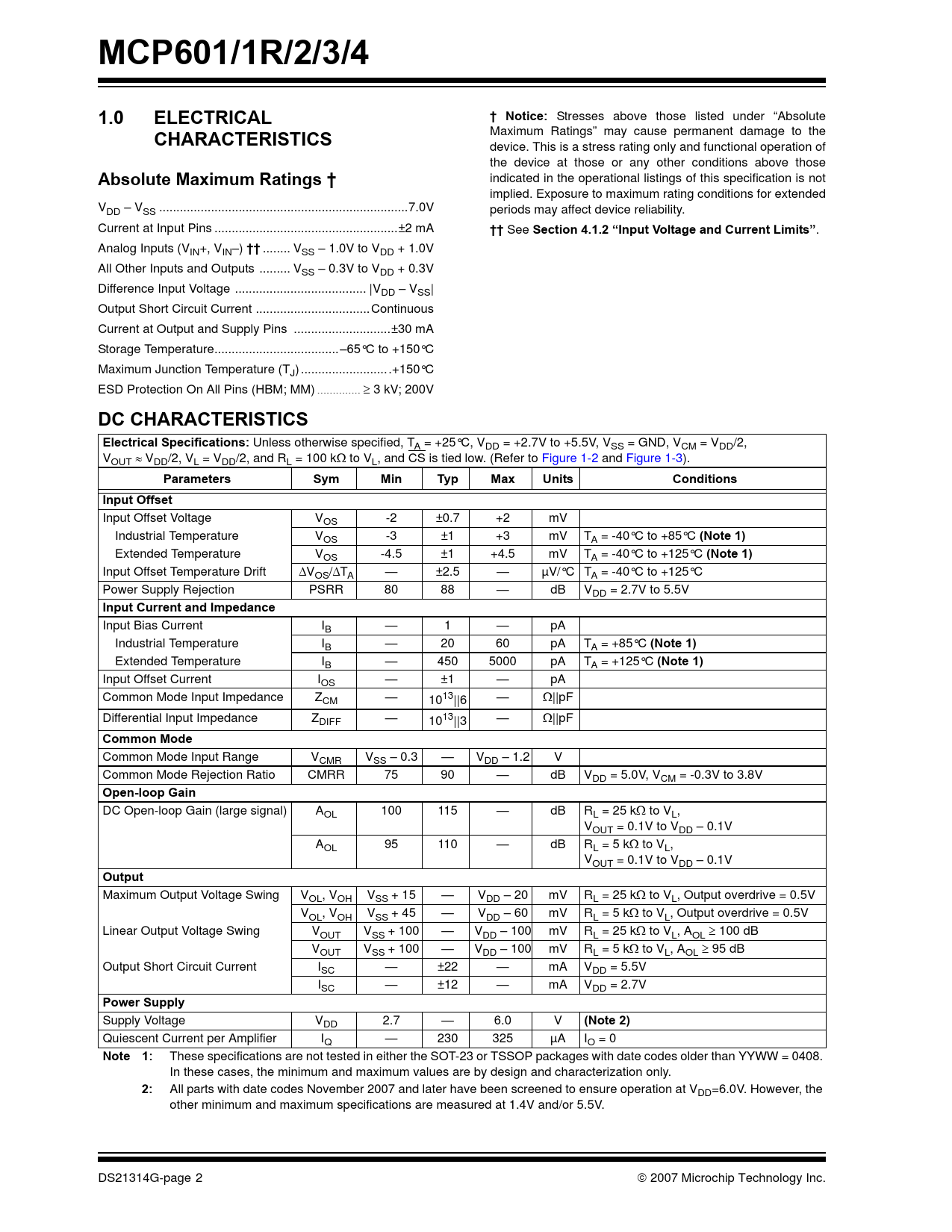

MCP601/1R/2/3/4. 1.0. ELECTRICAL. † Notice:. CHARACTERISTICS. Absolute Maximum Ratings †
MCP601/1R/2/3/4 1.0 ELECTRICAL † Notice: CHARACTERISTICS Absolute Maximum Ratings †
link to page 12 link to page 4 link to page 4 link to page 2 link to page 2 link to page 2 link to page 2 link to page 2
Stresses above those listed under “Absolute
CHARACTERISTICS
Maximum Ratings” may cause permanent damage to the device. This is a stress rating only and functional operation of the device at those or any other conditions above those
indicated in the operational listings of this specification is not implied. Exposure to maximum rating conditions for extended VDD – VSS ..7.0V periods may affect device reliability. Current at Input Pins ...±2 mA
See
Section 4.1.2 “Input Voltage and Current Limits”
. Analog Inputs (VIN+, VIN–)
.. VSS – 1.0V to VDD + 1.0V All Other Inputs and Outputs ... VSS – 0.3V to VDD + 0.3V Difference Input Voltage .. |VDD – VSS| Output Short Circuit Current ...Continuous Current at Output and Supply Pins ..±30 mA Storage Temperature.. –65°C to +150°C Maximum Junction Temperature (TJ) ..+150°C ESD Protection On All Pins (HBM; MM) .. ≥ 3 kV; 200V
DC CHARACTERISTICS Electrical Specifications:
Unless otherwise specified, TA = +25°C, VDD = +2.7V to +5.5V, VSS = GND, VCM = VDD/2, VOUT ≈ VDD/2, VL = VDD/2, and RL = 100 kΩ to VL, and CS is tied low. (Refer to Figure 1-2 and Figure 1-3).
Parameters Sym Min Typ Max Units Conditions Input Offset
Input Offset Voltage VOS -2 ±0.7 +2 mV Industrial Temperature VOS -3 ±1 +3 mV TA = -40°C to +85°C
(Note 1 )
Extended Temperature VOS -4.5 ±1 +4.5 mV TA = -40°C to +125°C
(Note 1)
Input Offset Temperature Drift ΔVOS/ΔTA — ±2.5 — µV/°C TA = -40°C to +125°C Power Supply Rejection PSRR 80 88 — dB VDD = 2.7V to 5.5V
Input Current and Impedance
Input Bias Current IB — 1 — pA Industrial Temperature IB — 20 60 pA TA = +85°C
(Note 1)
Extended Temperature IB — 450 5000 pA TA = +125°C
(Note 1 )
Input Offset Current IOS — ±1 — pA Common Mode Input Impedance ZCM — 1013||6 — Ω||pF Differential Input Impedance ZDIFF — 1013||3 — Ω||pF
Common Mode
Common Mode Input Range VCMR VSS – 0.3 — VDD – 1.2 V Common Mode Rejection Ratio CMRR 75 90 — dB VDD = 5.0V, VCM = -0.3V to 3.8V
Open-loop Gain
DC Open-loop Gain (large signal) AOL 100 115 — dB RL = 25 kΩ to VL, VOUT = 0.1V to VDD – 0.1V AOL 95 110 — dB RL = 5 kΩ to VL, VOUT = 0.1V to VDD – 0.1V
Output
Maximum Output Voltage Swing VOL, VOH VSS + 15 — VDD – 20 mV RL = 25 kΩ to VL, Output overdrive = 0.5V VOL, VOH VSS + 45 — VDD – 60 mV RL = 5 kΩ to VL, Output overdrive = 0.5V Linear Output Voltage Swing VOUT VSS + 100 — VDD – 100 mV RL = 25 kΩ to VL, AOL ≥ 100 dB VOUT VSS + 100 — VDD – 100 mV RL = 5 kΩ to VL, AOL ≥ 95 dB Output Short Circuit Current ISC — ±22 — mA VDD = 5.5V ISC — ±12 — mA VDD = 2.7V
Power Supply
Supply Voltage VDD 2.7 — 6.0 V
(Note 2)
Quiescent Current per Amplifier IQ — 230 325 µA IO = 0
Note 1:
These specifications are not tested in either the SOT-23 or TSSOP packages with date codes older than YYWW = 0408. In these cases, the minimum and maximum values are by design and characterization only.
2:
All parts with date codes November 2007 and later have been screened to ensure operation at VDD=6.0V. However, the other minimum and maximum specifications are measured at 1.4V and/or 5.5V. DS21314G-page 2 © 2007 Microchip Technology Inc. Document Outline 1.0 Electrical Characteristics FIGURE 1-1: MCP603 Chip Select (CS) Timing Diagram. 1.1 Test Circuits FIGURE 1-2: AC and DC Test Circuit for Most Non-Inverting Gain Conditions. FIGURE 1-3: AC and DC Test Circuit for Most Inverting Gain Conditions. 2.0 Typical Performance Curves FIGURE 2-1: Open-Loop Gain, Phase vs. Frequency. FIGURE 2-2: Slew Rate vs. Temperature. FIGURE 2-3: Gain Bandwidth Product, Phase Margin vs. Temperature. FIGURE 2-4: Quiescent Current vs. Supply Voltage. FIGURE 2-5: Quiescent Current vs. Temperature. FIGURE 2-6: Input Noise Voltage Density vs. Frequency. FIGURE 2-7: Input Offset Voltage. FIGURE 2-8: Input Offset Voltage vs. Temperature. FIGURE 2-9: Input Offset Voltage vs. Common Mode Input Voltage with VDD = 2.7V. FIGURE 2-10: Input Offset Voltage Drift. FIGURE 2-11: CMRR, PSRR vs. Temperature. FIGURE 2-12: Input Offset Voltage vs. Common Mode Input Voltage with VDD = 5.5V. FIGURE 2-13: Channel-to-Channel Separation vs. Frequency. FIGURE 2-14: Input Bias Current, Input Offset Current vs. Ambient Temperature. FIGURE 2-15: DC Open-Loop Gain vs. Load Resistance. FIGURE 2-16: CMRR, PSRR vs. Frequency. FIGURE 2-17: Input Bias Current, Input Offset Current vs. Common Mode Input Voltage. FIGURE 2-18: DC Open-Loop Gain vs. Supply Voltage. FIGURE 2-19: Gain Bandwidth Product, Phase Margin vs. Load Resistance. FIGURE 2-20: Output Voltage Headroom vs. Output Current. FIGURE 2-21: Maximum Output Voltage Swing vs. Frequency. FIGURE 2-22: DC Open-Loop Gain vs. Temperature. FIGURE 2-23: Output Voltage Headroom vs. Temperature. FIGURE 2-24: Output Short-Circuit Current vs. Supply Voltage. FIGURE 2-25: Large Signal Non-Inverting Pulse Response. FIGURE 2-26: Small Signal Non-Inverting Pulse Response. FIGURE 2-27: Chip Select Timing (MCP603). FIGURE 2-28: Large Signal Inverting Pulse Response. FIGURE 2-29: Small Signal Inverting Pulse Response. FIGURE 2-30: Quiescent Current Through VSS vs. Chip Select Voltage (MCP603). FIGURE 2-31: Chip Select Pin Input Current vs. Chip Select Voltage. FIGURE 2-32: Hysteresis of Chip Select’s Internal Switch. FIGURE 2-33: The MCP601/1R/2/3/4 family of op amps shows no phase reversal under input overdrive. FIGURE 2-34: Measured Input Current vs. Input Voltage (below VSS). 3.0 Pin Descriptions TABLE 3-1: Pin Function Table For Single Op Amps TABLE 3-2: Pin Function Table For Dual And Quad Op Amps 3.1 Analog Outputs 3.2 Analog Inputs 3.3 Chip Select Digital Input 3.4 Power Supply Pins 4.0 Applications Information 4.1 Inputs FIGURE 4-1: Simplified Analog Input ESD Structures. FIGURE 4-2: Protecting the Analog Inputs. FIGURE 4-3: Unity Gain Buffer has a Limited VOUT Range. 4.2 Rail-to-Rail Output 4.3 MCP603 Chip Select 4.4 Capacitive Loads FIGURE 4-4: Output resistor RISO stabilizes large capacitive loads. FIGURE 4-5: Recommended RISO values for capacitive loads. 4.5 Supply Bypass 4.6 Unused Op Amps FIGURE 4-6: Unused Op Amps. 4.7 PCB Surface Leakage FIGURE 4-7: Example Guard Ring layout. 4.8 Typical Applications FIGURE 4-8: Second-Order, Low-Pass Sallen-Key Filter. FIGURE 4-9: Second-Order, Low-Pass Multiple-Feedback Filter. FIGURE 4-10: Three-Op Amp Instrumentation Amplifier. FIGURE 4-11: Two-Op Amp Instrumentation Amplifier. FIGURE 4-12: Photovoltaic Mode Detector. FIGURE 4-13: Photoconductive Mode Detector. 5.0 Design Aids 5.1 SPICE Macro Model 5.2 FilterLab® Software 5.3 Mindi™ Simulatior Tool 5.4 MAPS (Microchip Advanced Part Selector) 5.5 Analog Demonstration and Evaluation Boards 5.6 Application Notes 6.0 Packaging Information 6.1 Package Marking Information
