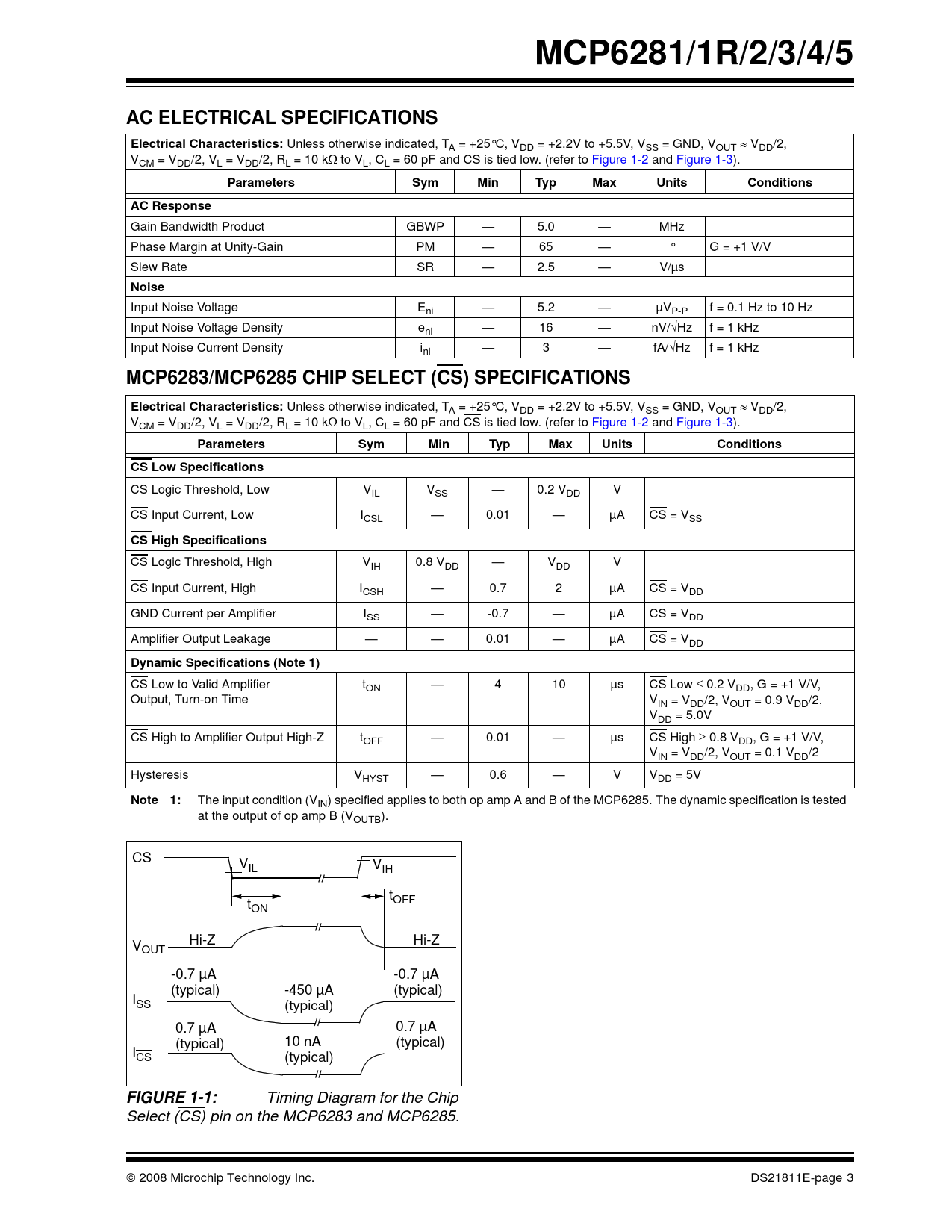

MCP6281/1R/2/3/4/5. AC ELECTRICAL SPECIFICATIONS. Electrical Characteristics:. Parameters. Sym. Min. Typ. Max. Units. Conditions
MCP6281/1R/2/3/4/5 AC ELECTRICAL SPECIFICATIONS Electrical Characteristics: Parameters Sym Min Typ Max Units Conditions
link to page 4 link to page 4 link to page 4 link to page 4 link to page 3
Unless otherwise indicated, T ≈ A = +25°C, VDD = +2.2V to +5.5V, VSS = GND, VOUT VDD/2, VCM = VDD/2, VL = VDD/2, RL = 10 kΩ to VL, CL = 60 pF and CS is tied low. (refer to Figure 1-2 and Figure 1-3).
Parameters Sym Min Typ Max Units Conditions AC Response
Gain Bandwidth Product GBWP — 5.0 — MHz Phase Margin at Unity-Gain PM — 65 — ° G = +1 V/V Slew Rate SR — 2.5 — V/µs
Noise
Input Noise Voltage Eni — 5.2 — µVP-P f = 0.1 Hz to 10 Hz Input Noise Voltage Density eni — 16 — nV/√Hz f = 1 kHz Input Noise Current Density ini — 3 — fA/√Hz f = 1 kHz
MCP6283/MCP6285 CHIP SELECT (CS) SPECIFICATIONS Electrical Characteristics:
Parameters Sym Min Typ Max Units Conditions CS Low Specifications
CS Logic Threshold, Low VIL VSS — 0.2 VDD V CS Input Current, Low ICSL — 0.01 — µA CS = VSS
CS High Specifications
CS Logic Threshold, High VIH 0.8 VDD — VDD V CS Input Current, High ICSH — 0.7 2 µA CS = VDD GND Current per Amplifier ISS — -0.7 — µA CS = VDD Amplifier Output Leakage — — 0.01 — µA CS = VDD
Dynamic Specifications (Note 1 )
CS Low to Valid Amplifier tON — 4 10 µs CS Low ≤ 0.2 VDD, G = +1 V/V, Output, Turn-on Time VIN = VDD/2, VOUT = 0.9 VDD/2, VDD = 5.0V CS High to Amplifier Output High-Z tOFF — 0.01 — µs CS High ≥ 0.8 VDD, G = +1 V/V, VIN = VDD/2, VOUT = 0.1 VDD/2 Hysteresis VHYST — 0.6 — V VDD = 5V
Note 1:
The input condition (VIN) specified applies to both op amp A and B of the MCP6285. The dynamic specification is tested at the output of op amp B (VOUTB). CS VIL VIH t t OFF ON Hi-Z V Hi-Z OUT -0.7 µA -0.7 µA (typical) -450 µA (typical) ISS (typical) 0.7 µA 0.7 µA (typical) 10 nA (typical) ICS (typical)
FIGURE 1-1:
Timing Diagram for the Chip Select (CS) pin on the MCP6283 and MCP6285. © 2008 Microchip Technology Inc. DS21811E-page 3 Document Outline 1.0 Electrical Characteristics FIGURE 1-1: Timing Diagram for the Chip Select (CS) pin on the MCP6283 and MCP6285. 1.1 Test Circuits FIGURE 1-2: AC and DC Test Circuit for Most Non-Inverting Gain Conditions. FIGURE 1-3: AC and DC Test Circuit for Most Inverting Gain Conditions. 2.0 Typical Performance Curves FIGURE 2-1: Input Offset Voltage. FIGURE 2-2: Input Bias Current at TA = +85 ˚C. FIGURE 2-3: Input Offset Voltage vs. Common Mode Input Voltage at VDD = 2.2V. FIGURE 2-4: Input Offset Voltage Drift. FIGURE 2-5: Input Bias Current at TA = +125 ˚C. FIGURE 2-6: Input Offset Voltage vs. Common Mode Input Voltage at VDD = 5.5V. FIGURE 2-7: Input Offset Voltage vs. Output Voltage. FIGURE 2-8: CMRR, PSRR vs. Frequency. FIGURE 2-9: Input Bias, Offset Currents vs. Common Mode Input Voltage at TA = +85˚C. FIGURE 2-10: Input Bias, Input Offset Currents vs. Ambient Temperature. FIGURE 2-11: CMRR, PSRR vs. Ambient Temperature. FIGURE 2-12: Input Bias, Offset Currents vs. Common Mode Input Voltage at TA = +125˚C. FIGURE 2-13: Quiescent Current vs. Power Supply Voltage. FIGURE 2-14: Open-Loop Gain, Phase vs. Frequency. FIGURE 2-15: Maximum Output Voltage Swing vs. Frequency. FIGURE 2-16: Output Voltage Headroom vs. Output Current Magnitude. FIGURE 2-17: Gain Bandwidth Product, Phase Margin vs. Ambient Temperature. FIGURE 2-18: Slew Rate vs. Ambient Temperature. FIGURE 2-19: Input Noise Voltage Density vs. Frequency. FIGURE 2-20: Output Short Circuit Current vs. Power Supply Voltage. FIGURE 2-21: Quiescent Current vs. Chip Select (CS) Voltage at VDD = 2.2V (MCP6283 and MCP6285 only). FIGURE 2-22: Input Noise Voltage Density vs. Common Mode Input Voltage at 1 kHz. FIGURE 2-23: Channel-to-Channel Separation vs. Frequency (MCP6282 and MCP6284 only). FIGURE 2-24: Quiescent Current vs. Chip Select (CS) Voltage at VDD = 5.5V (MCP6283 and MCP6285 only). FIGURE 2-25: Large-Signal, Non-inverting Pulse Response. FIGURE 2-26: Small-Signal, Non-inverting Pulse Response. FIGURE 2-27: Chip Select (CS) to Amplifier Output Response Time at VDD = 2.2V (MCP6283 and MCP6285 only). FIGURE 2-28: Large-Signal, Inverting Pulse Response. FIGURE 2-29: Small-Signal, Inverting Pulse Response. FIGURE 2-30: Chip Select (CS) to Amplifier Output Response Time at VDD = 5.5V (MCP6283 and MCP6285 only). FIGURE 2-31: Measured Input Current vs. Input Voltage (below VSS). FIGURE 2-32: The MCP6281/1R/2/3/4/5 Show No Phase Reversal. 3.0 Pin Descriptions TABLE 3-1: Pin Function Table for Single Op Amps TABLE 3-2: Pin Function Table for Dual and Quad Op Amps 3.1 Analog Outputs 3.2 Analog Inputs 3.3 MCP6285’s VOUTA/VINB+ Pin 3.4 Chip Select Digital Input (CS) 3.5 Power Supply Pins 4.0 Application infoRmation 4.1 Rail-to-Rail Inputs FIGURE 4-1: Simplified Analog Input ESD Structures. FIGURE 4-2: Protecting the Analog Inputs. 4.2 Rail-to-Rail Output 4.3 Capacitive Loads FIGURE 4-3: Output Resistor, RISO stabilizes large capacitive loads. FIGURE 4-4: Recommended RISO Values for Capacitive Loads. 4.4 MCP628X Chip Select (CS) 4.5 Cascaded Dual Op Amps (MCP6285) FIGURE 4-5: Cascaded Gain Amplifier. 4.6 Supply Bypass 4.7 Unused Op Amps FIGURE 4-6: Unused Op Amps. 4.8 PCB Surface Leakage FIGURE 4-7: Example Guard Ring Layout for Inverting Gain. 4.9 Application Circuits FIGURE 4-8: Sallen-Key High-Pass Filter. FIGURE 4-9: Miller Integrator. FIGURE 4-10: Isolating the Load with a Buffer. FIGURE 4-11: Cascaded Gain Circuit Configuration. FIGURE 4-12: Difference Amplifier Circuit. FIGURE 4-13: Buffered Non-inverting Integrator with Chip Select. FIGURE 4-14: Integrator Circuit with Active Compensation. FIGURE 4-15: Second-Order Multiple Feedback Low-Pass Filter with an Extra Pole-Zero Pair. FIGURE 4-16: Second-Order Sallen-Key Low-Pass Filter with an Extra Pole-Zero Pair and Chip Select. FIGURE 4-17: Capacitorless Second-Order Low-Pass Filter with Chip Select. 5.0 Design AIDS 5.1 SPICE Macro Model 5.2 FilterLab® Software 5.3 Mindi™ Circuit Designer & Simulator 5.4 MAPS (Microchip Advanced Part Selector) 5.5 Analog Demonstration and Evaluation Boards 5.6 Application Notes 6.0 Packaging Information 6.1 Package Marking Information
