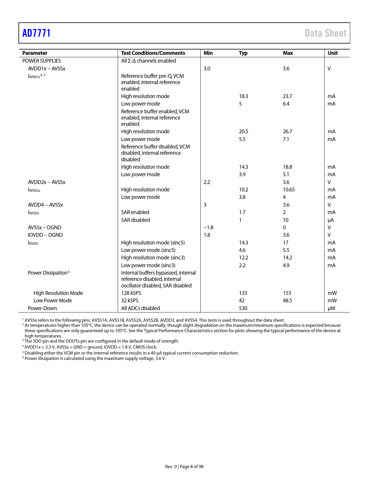

AD7771. Data Sheet. Parameter. Test Conditions/Comments. Min. Typ. Max. Unit
link to page 18
AD7771 Data Sheet Parameter Test Conditions/Comments Min Typ Max Unit
POWER SUPPLIES All Σ-Δ channels enabled AVDD1x − AVSSx 3.0 3.6 V I 4, 5 AVDD1x Reference buffer pre-Q, VCM enabled, internal reference enabled High resolution mode 18.3 23.7 mA Low power mode 5 6.4 mA Reference buffer enabled, VCM enabled, internal reference enabled High resolution mode 20.5 26.7 mA Low power mode 5.5 7.1 mA Reference buffer disabled, VCM disabled, internal reference disabled High resolution mode 14.3 18.8 mA Low power mode 3.9 5.1 mA AVDD2x − AVSSx 2.2 3.6 V IAVDD2x High resolution mode 10.2 10.65 mA Low power mode 3.8 4 mA AVDD4 − AVSSx 3 3.6 V IAVDD4 SAR enabled 1.7 2 mA SAR disabled 1 10 µA AVSSx − DGND −1.8 0 V IOVDD − DGND 1.8 3.6 V IIOVDD High resolution mode (sinc5) 14.3 17 mA Low power mode (sinc5) 4.6 5.5 mA High resolution mode (sinc3) 12.2 14.2 mA Low power mode (sinc3) 2.2 4.9 mA Power Dissipation6 Internal buffers bypassed, internal reference disabled, internal oscillator disabled, SAR disabled High Resolution Mode 128 kSPS 133 153 mW Low Power Mode 32 kSPS 42 48.5 mW Power-Down All ADCs disabled 530 µW 1 AVSSx refers to the following pins: AVSS1A, AVSS1B, AVSS2A, AVSS2B, AVDD3, and AVSS4. This term is used throughout the data sheet. 2 At temperatures higher than 105°C, the device can be operated normally, though slight degradation on the maximum/minimum specifications is expected because these specifications are only guaranteed up to 105°C. See the Typical Performance Characteristics section for plots showing the typical performance of the device at high temperatures. 3 The SDO pin and the DOUTx pin are configured in the default mode of strength. 4 AVDD1x = 3.3 V, AVSSx = GND = ground, IOVDD = 1.8 V, CMOS clock. 5 Disabling either the VCM pin or the internal reference results in a 40 µA typical current consumption reduction. 6 Power dissipation is calculated using the maximum supply voltage, 3.6 V. Rev. 0 | Page 8 of 98 Document Outline FEATURES APPLICATIONS GENERAL DESCRIPTION TABLE OF CONTENTS REVISION HISTORY FUNCTIONAL BLOCK DIAGRAM SPECIFICATIONS DOUTx TIMING CHARACTERISTISTICS SPI TIMING CHARACTERISTISTICS SYNCHRONIZATION PINS AND RESET TIMING CHARACTERISTICS SAR ADC TIMING CHARACTERISTISTICS GPIO SRC UPDATE TIMING CHARACTERISTISTICS ABSOLUTE MAXIMUM RATINGS THERMAL RESISTANCE ESD CAUTION PIN CONFIGURATION AND FUNCTION DESCRIPTIONS TYPICAL PERFORMANCE CHARACTERISTICS TERMINOLOGY THEORY OF OPERATION ANALOG INPUTS TRANSFER FUNCTION CORE SIGNAL CHAIN CAPACITIVE PGA INTERNAL REFERENCE AND REFERENCE BUFFERS INTEGRATED LDOs CLOCKING AND SAMPLING DIGITAL RESET AND SYNCHRONIZATION PINS DIGITAL FILTERING SHUTDOWN MODE CONTROLLING THE AD7771 PIN CONTROL MODE SPI CONTROL Functionality Available in SPI Control Mode Offset and Gain Correction SPI Control Functionality Global Control Functions Per Channel Functions Phase Adjustment PGA Gain Decimation GPIOx Pins Σ-Δ Reference Configuration Power Modes Sinc3 and Sinc5 Filters LDO Bypassing DIGITAL SPI SPI CRC—Checksum Protection (SPI Control Mode) SPI Read/Write Register Mode (SPI Control Mode) SPI SAR Diagnostic Mode (SPI Control Mode) Σ-Δ Data, ADC Mode SPI Software Reset RMS NOISE AND RESOLUTION HIGH RESOLUTION MODE LOW POWER MODE DIAGNOSTICS AND MONITORING SELF DIAGNOSTICS ERROR General Errors MCLK Switch Error (SPI Control Mode) Reset Detection Internal LDO Status ROM and Memory Map CRC Σ-Δ ADC Errors Reference Detect (SPI Control Mode) Overvoltage and Undervoltage Events Modulator Saturation Filter Saturation Output Saturation SPI Transmission Errors (SPI Control Mode) CRC Checksum Error SCLK Counter Invalid Read Invalid Write MONITORING USING THE AD7771 SAR ADC(SPI CONTROL MODE) Temperature Sensor Σ-Δ ADC DIAGNOSTICS (SPI CONTROL MODE) Σ-∆ OUTPUT DATA ADC CONVERSION OUTPUT—HEADER AND DATA CRC Header Error Header (SPI Control Mode) SAMPLE RATE CONVERTER (SRC) (SPI CONTROL MODE) SRC Bandwidth SRC Group Delay Settling Time DATA OUTPUT INTERFACE DOUT3 to DOUT0 Data Interface Standalone Mode Daisy-Chain Mode Minimum DCLKx Frequency SPI CALCULATING THE CRC CHECKSUM Σ-Δ CRC Checksum SPI Control Mode Checksum REGISTER SUMMARY REGISTER DETAILS CHANNEL 0 CONFIGURATION REGISTER CHANNEL 1 CONFIGURATION REGISTER CHANNEL 2 CONFIGURATION REGISTER CHANNEL 3 CONFIGURATION REGISTER CHANNEL 4 CONFIGURATION REGISTER CHANNEL 5 CONFIGURATION REGISTER CHANNEL 6 CONFIGURATION REGISTER CHANNEL 7 CONFIGURATION REGISTER DISABLE CLOCKS TO ADC CHANNEL REGISTER CHANNEL 0 SYNC OFFSET REGISTER CHANNEL 1 SYNC OFFSET REGISTER CHANNEL 2 SYNC OFFSET REGISTER CHANNEL 3 SYNC OFFSET REGISTER CHANNEL 4 SYNC OFFSET REGISTER CHANNEL 5 SYNC OFFSET REGISTER CHANNEL 6 SYNC OFFSET REGISTER CHANNEL 7 SYNC OFFSET REGISTER GENERAL USER CONFIGURATION 1 REGISTER GENERAL USER CONFIGURATION 2 REGISTER GENERAL USER CONFIGURATION 3 REGISTER DATA OUTPUT FORMAT REGISTER MAIN ADC METER AND REFERENCE MUX CONTROL REGISTER GLOBAL DIAGNOSTICS MUX REGISTER GPIO CONFIGURATION REGISTER GPIO DATA REGISTER BUFFER CONFIGURATION 1 REGISTER BUFFER CONFIGURATION 2 REGISTER CHANNEL 0 OFFSET UPPER BYTE REGISTER CHANNEL 0 OFFSET MIDDLE BYTE REGISTER CHANNEL 0 OFFSET LOWER BYTE REGISTER CHANNEL 0 GAIN UPPER BYTE REGISTER CHANNEL 0 GAIN MIDDLE BYTE REGISTER CHANNEL 0 GAIN LOWER BYTE REGISTER CHANNEL 1 OFFSET UPPER BYTE REGISTER CHANNEL 1 OFFSET MIDDLE BYTE REGISTER CHANNEL 1 OFFSET LOWER BYTE REGISTER CHANNEL 1 GAIN UPPER BYTE REGISTER CHANNEL 1 GAIN MIDDLE BYTE REGISTER CHANNEL 1 GAIN LOWER BYTE REGISTER CHANNEL 2 OFFSET UPPER BYTE REGISTER CHANNEL 2 OFFSET MIDDLE BYTE REGISTER CHANNEL 2 OFFSET LOWER BYTE REGISTER CHANNEL 2 GAIN UPPER BYTE REGISTER CHANNEL 2 GAIN MIDDLE BYTE REGISTER CHANNEL 2 GAIN LOWER BYTE REGISTER CHANNEL 3 OFFSET UPPER BYTE REGISTER CHANNEL 3 OFFSET MIDDLE BYTE REGISTER CHANNEL 3 OFFSET LOWER BYTE REGISTER CHANNEL 3 GAIN UPPER BYTE REGISTER CHANNEL 3 GAIN MIDDLE BYTE REGISTER CHANNEL 3 GAIN LOWER BYTE REGISTER CHANNEL 4 OFFSET UPPER BYTE REGISTER CHANNEL 4 OFFSET MIDDLE BYTE REGISTER CHANNEL 4 OFFSET LOWER BYTE REGISTER CHANNEL 4 GAIN UPPER BYTE REGISTER CHANNEL 4 GAIN MIDDLE BYTE REGISTER CHANNEL 4 GAIN LOWER BYTE REGISTER CHANNEL 5 OFFSET UPPER BYTE REGISTER CHANNEL 5 OFFSET MIDDLE BYTE REGISTER CHANNEL 5 OFFSET LOWER BYTE REGISTER CHANNEL 5 GAIN UPPER BYTE REGISTER CHANNEL 5 GAIN MIDDLE BYTE REGISTER CHANNEL 5 GAIN LOWER BYTE REGISTER CHANNEL 6 OFFSET UPPER BYTE REGISTER CHANNEL 6 OFFSET MIDDLE BYTE REGISTER CHANNEL 6 OFFSET LOWER BYTE REGISTER CHANNEL 6 GAIN UPPER BYTE REGISTER CHANNEL 6 GAIN MIDDLE BYTE REGISTER CHANNEL 6 GAIN LOWER BYTE REGISTER CHANNEL 7 OFFSET UPPER BYTE REGISTER CHANNEL 7 OFFSET MIDDLE BYTE REGISTER CHANNEL 7 OFFSET LOWER BYTE REGISTER CHANNEL 7 GAIN UPPER BYTE REGISTER CHANNEL 7 GAIN MIDDLE BYTE REGISTER CHANNEL 7 GAIN LOWER BYTE REGISTER CHANNEL 0 STATUS REGISTER CHANNEL 1 STATUS REGISTER CHANNEL 2 STATUS REGISTER CHANNEL 3 STATUS REGISTER CHANNEL 4 STATUS REGISTER CHANNEL 5 STATUS REGISTER CHANNEL 6 STATUS REGISTER CHANNEL 7 STATUS REGISTER CHANNEL 0/CHANNEL 1 DSP ERRORS REGISTER CHANNEL 2/CHANNEL 3 DSP ERRORS REGISTER CHANNEL 4/CHANNEL 5 DSP ERRORS REGISTER CHANNEL 6/CHANNEL 7 DSP ERRORS REGISTER CHANNEL 0 TO CHANNEL 7 ERROR REGISTER ENABLE REGISTER GENERAL ERRORS REGISTER 1 GENERAL ERRORS REGISTER 1 ENABLE GENERAL ERRORS REGISTER 2 GENERAL ERRORS REGISTER 2 ENABLE ERROR STATUS REGISTER 1 ERROR STATUS REGISTER 2 ERROR STATUS REGISTER 3 DECIMATION RATE (N) MSB REGISTER DECIMATION RATE (N) LSB REGISTER DECIMATION RATE (IF) MSB REGISTER DECIMATION RATE (IF) LSB REGISTER SRC LOAD SOURCE AND LOAD UPDATE REGISTER OUTLINE DIMENSIONS ORDERING GUIDE
