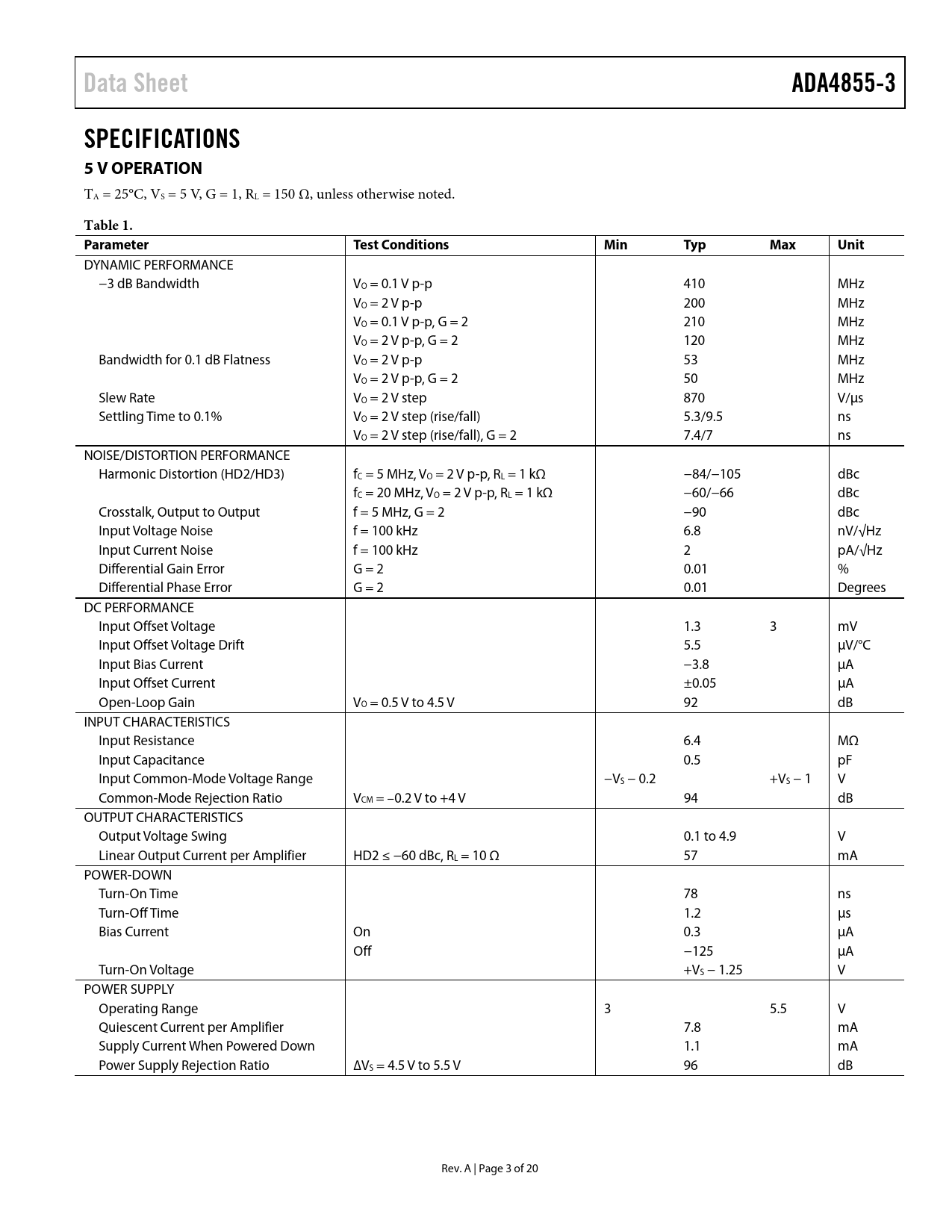

Data Sheet. ADA4855-3. SPECIFICATIONS 5 V OPERATION. Table 1. Parameter. Test Conditions. Min. Typ. Max. Unit
Data Sheet ADA4855-3 SPECIFICATIONS 5 V OPERATION Table 1 Parameter Test Conditions Min Typ Max Unit
TA = 25°C, VS = 5 V, G = 1, RL = 150 Ω, unless otherwise noted.
Table 1. Parameter Test Conditions Min Typ Max Unit
DYNAMIC PERFORMANCE −3 dB Bandwidth VO = 0.1 V p-p 410 MHz VO = 2 V p-p 200 MHz VO = 0.1 V p-p, G = 2 210 MHz VO = 2 V p-p, G = 2 120 MHz Bandwidth for 0.1 dB Flatness VO = 2 V p-p 53 MHz VO = 2 V p-p, G = 2 50 MHz Slew Rate VO = 2 V step 870 V/µs Settling Time to 0.1% VO = 2 V step (rise/fall) 5.3/9.5 ns VO = 2 V step (rise/fall), G = 2 7.4/7 ns NOISE/DISTORTION PERFORMANCE Harmonic Distortion (HD2/HD3) fC = 5 MHz, VO = 2 V p-p, RL = 1 kΩ −84/−105 dBc fC = 20 MHz, VO = 2 V p-p, RL = 1 kΩ −60/−66 dBc Crosstalk, Output to Output f = 5 MHz, G = 2 −90 dBc Input Voltage Noise f = 100 kHz 6.8 nV/√Hz Input Current Noise f = 100 kHz 2 pA/√Hz Differential Gain Error G = 2 0.01 % Differential Phase Error G = 2 0.01 Degrees DC PERFORMANCE Input Offset Voltage 1.3 3 mV Input Offset Voltage Drift 5.5 µV/°C Input Bias Current −3.8 µA Input Offset Current ±0.05 µA Open-Loop Gain VO = 0.5 V to 4.5 V 92 dB INPUT CHARACTERISTICS Input Resistance 6.4 MΩ Input Capacitance 0.5 pF Input Common-Mode Voltage Range −VS − 0.2 +VS − 1 V Common-Mode Rejection Ratio VCM = –0.2 V to +4 V 94 dB OUTPUT CHARACTERISTICS Output Voltage Swing 0.1 to 4.9 V Linear Output Current per Amplifier HD2 ≤ −60 dBc, RL = 10 Ω 57 mA POWER-DOWN Turn-On Time 78 ns Turn-Off Time 1.2 µs Bias Current On 0.3 µA Off −125 µA Turn-On Voltage +VS − 1.25 V POWER SUPPLY Operating Range 3 5.5 V Quiescent Current per Amplifier 7.8 mA Supply Current When Powered Down 1.1 mA Power Supply Rejection Ratio ∆VS = 4.5 V to 5.5 V 96 dB Rev. A | Page 3 of 20 Document Outline Features Applications Connection Diagram General Description Revision History Specifications 5 V Operation 3.3 V Operation Absolute Maximum Ratings Thermal Resistance Maximum Power Dissipation ESD Caution Pin Configuration and Function Descriptions Typical Performance Characteristics Test Circuits Theory of Operation Applications Information Gain Configurations 20 MHz Active Low-Pass Filter RGB Video Driver Driving Multiple Video Loads PD (Power-Down) Pin Single-Supply Operation Power Supply Bypassing Layout Outline Dimensions Ordering Guide
