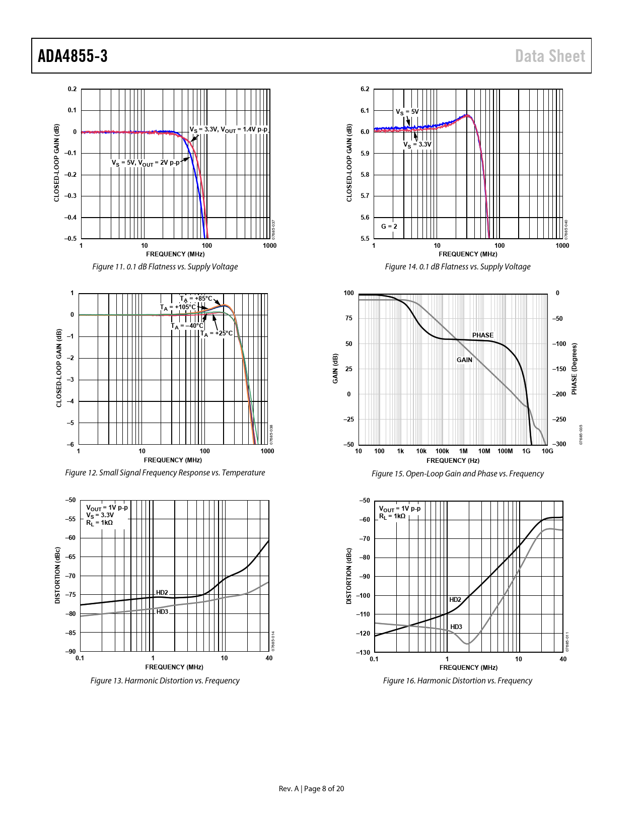

ADA4855-3. Data Sheet. 0.2. 6.2. 0.1. 6.1. VS = 5V. VS = 3.3V, VOUT = 1.4V p-p. 6.0. VS = 3.3V. GA –0.1. 5.9. S = 5V, VOUT = 2V p-p. -L –0.2. 5.8
ADA4855-3 Data Sheet 0.2 6.2 0.1 6.1 VS = 5V ) ) B B d 0 VS = 3.3V, VOUT = 1.4V p-p d 6.0 ( ( IN IN VS = 3.3V GA –0.1 GA 5.9 P P V OO S = 5V, VOUT = 2V p-p OO -L –0.2 -L 5.8 D D E E OS OS L –0.3 L 5.7 C C –0.4 5.6

1 10 100 1000 1 10 100 1000 FREQUENCY (MHz) FREQUENCY (MHz)
Figure 11. 0.1 dB Flatness vs. Supply Voltage Figure 14. 0.1 dB Flatness vs. Supply Voltage
1 100 0 TA = +85°C TA = +105°C 0 75 –50 ) TA = –40°C B T d –1 A = +25°C PHASE ( 50 –100 IN ) GA –2 rees) B d GAIN eg ( 25 –150 D OOP IN ( E -L –3 D GA AS E H P OS 0 –200 L –4 C –25 –250 –5

–50 –300 1 10 100 1000 10 100 1k 10k 100k 1M 10M 100M 1G 10G FREQUENCY (MHz) FREQUENCY (Hz)
Figure 12. Small Signal Frequency Response vs. Temperature Figure 15. Open-Loop Gain and Phase vs. Frequency
–50 –50 VOUT = 1V p-p VOUT = 1V p-p V –55 S = 3.3V RL = 1kΩ R –60 L = 1kΩ –60 –70 c) B –65 d Bc) –80 ( d ( N ON –70 TI IO –90 T R OR T O –75 HD2 T IS S –100 D DI HD2 –80 HD3 –110 HD3 –85

0.1 1 10 40 0.1 1 10 40 FREQUENCY (MHz) FREQUENCY (MHz)
Figure 13. Harmonic Distortion vs. Frequency Figure 16. Harmonic Distortion vs. Frequency Rev. A | Page 8 of 20 Document Outline Features Applications Connection Diagram General Description Revision History Specifications 5 V Operation 3.3 V Operation Absolute Maximum Ratings Thermal Resistance Maximum Power Dissipation ESD Caution Pin Configuration and Function Descriptions Typical Performance Characteristics Test Circuits Theory of Operation Applications Information Gain Configurations 20 MHz Active Low-Pass Filter RGB Video Driver Driving Multiple Video Loads PD (Power-Down) Pin Single-Supply Operation Power Supply Bypassing Layout Outline Dimensions Ordering Guide
