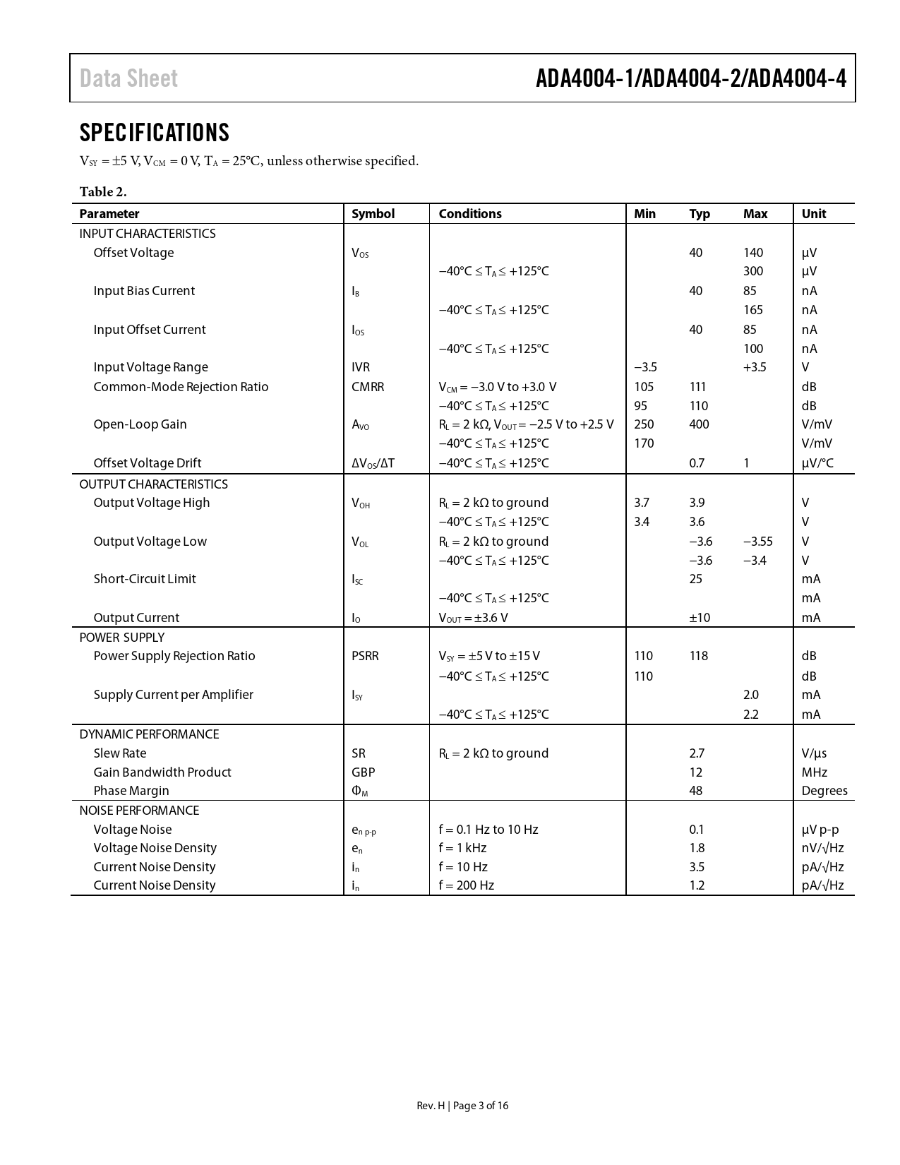

Data Sheet. ADA4004-1/ADA4004-2/ADA4004-4. SPECIFICATIONS. Table 2. Parameter. Symbol. Conditions. Min. Typ. Max. Unit
Data Sheet ADA4004-1/ADA4004-2/ADA4004-4 SPECIFICATIONS Table 2 Parameter Symbol Conditions Min Typ Max Unit
VSY = ±5 V, VCM = 0 V, TA = 25°C, unless otherwise specified.
Table 2. Parameter Symbol Conditions Min Typ Max Unit
INPUT CHARACTERISTICS Offset Voltage VOS 40 140 μV −40°C ≤ TA ≤ +125°C 300 μV Input Bias Current IB 40 85 nA −40°C ≤ TA ≤ +125°C 165 nA Input Offset Current IOS 40 85 nA −40°C ≤ TA ≤ +125°C 100 nA Input Voltage Range IVR −3.5 +3.5 V Common-Mode Rejection Ratio CMRR VCM = −3.0 V to +3.0 V 105 111 dB −40°C ≤ TA ≤ +125°C 95 110 dB Open-Loop Gain AVO RL = 2 kΩ, VOUT = −2.5 V to +2.5 V 250 400 V/mV −40°C ≤ TA ≤ +125°C 170 V/mV Offset Voltage Drift ∆VOS/∆T −40°C ≤ TA ≤ +125°C 0.7 1 μV/°C OUTPUT CHARACTERISTICS Output Voltage High VOH RL = 2 kΩ to ground 3.7 3.9 V −40°C ≤ TA ≤ +125°C 3.4 3.6 V Output Voltage Low VOL RL = 2 kΩ to ground −3.6 −3.55 V −40°C ≤ TA ≤ +125°C −3.6 −3.4 V Short-Circuit Limit ISC 25 mA −40°C ≤ TA ≤ +125°C mA Output Current IO VOUT = ±3.6 V ±10 mA POWER SUPPLY Power Supply Rejection Ratio PSRR VSY = ±5 V to ±15 V 110 118 dB −40°C ≤ TA ≤ +125°C 110 dB Supply Current per Amplifier ISY 2.0 mA −40°C ≤ TA ≤ +125°C 2.2 mA DYNAMIC PERFORMANCE Slew Rate SR RL = 2 kΩ to ground 2.7 V/μs Gain Bandwidth Product GBP 12 MHz Phase Margin ΦM 48 Degrees NOISE PERFORMANCE Voltage Noise en p-p f = 0.1 Hz to 10 Hz 0.1 μV p-p Voltage Noise Density en f = 1 kHz 1.8 nV/√Hz Current Noise Density in f = 10 Hz 3.5 pA/√Hz Current Noise Density in f = 200 Hz 1.2 pA/√Hz Rev. H | Page 3 of 16 Document Outline FEATURES APPLICATIONS GENERAL DESCRIPTION PIN CONFIGURATIONS TABLE OF CONTENTS REVISION HISTORY SPECIFICATIONS ABSOLUTE MAXIMUM RATINGS THERMAL RESISTANCE ESD CAUTION TYPICAL PERFORMANCE CHARACTERISTICS OUTLINE DIMENSIONS ORDERING GUIDE
