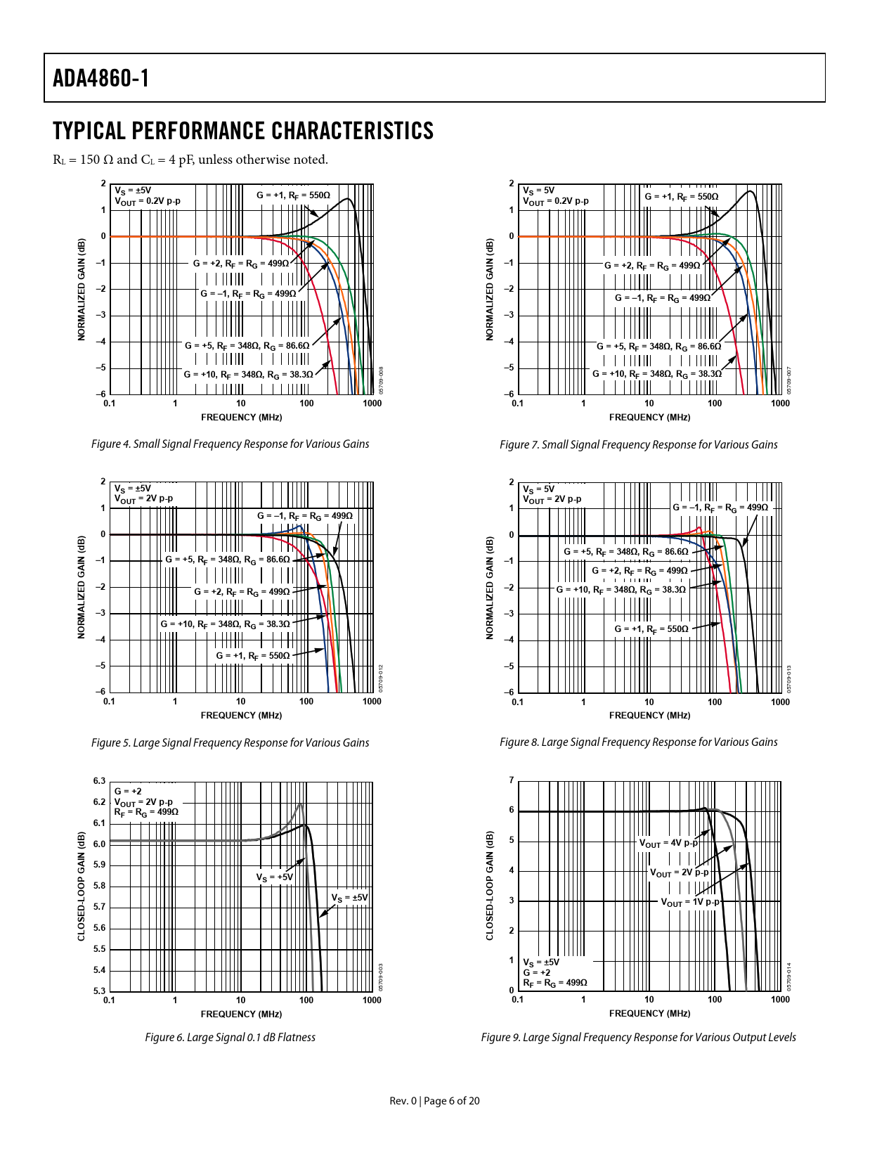

ADA4860-1. TYPICAL PERFORMANCE CHARACTERISTICS. VS = ±5V. G = +1, R. S = 5V. F = 550Ω. OUT = 0.2V p-p. VOUT = 0.2V p-p
ADA4860-1 TYPICAL PERFORMANCE CHARACTERISTICS
RL = 150 Ω and CL = 4 pF, unless otherwise noted.

Figure 4. Small Signal Frequency Response for Various Gains Figure 7. Small Signal Frequency Response for Various Gains

Figure 5. Large Signal Frequency Response for Various Gains Figure 8. Large Signal Frequency Response for Various Gains
6.3 7 G = +2 6.2 VOUT = 2V p-p R 6 F = RG = 499Ω 6.1 ) ) B B d 6.0 5 d V ( ( OUT = 4V p-p IN IN 5.9 GA 4 V V GA OUT = 2V p-p S = +5V 5.8 OOP OOP -L VS = ±5V -L 3 V D 5.7 D OUT = 1V p-p E E OS 5.6 OS L L 2 C C 5.5 1 V 5.4 S = ±5V

Figure 6. Large Signal 0.1 dB Flatness Figure 9. Large Signal Frequency Response for Various Output Levels Rev. 0 | Page 6 of 20 Document Outline FEATURES APPLICATIONS PIN CONFIGURATION GENERAL DESCRIPTION TABLE OF CONTENTS REVISION HISTORY SPECIFICATIONS ABSOLUTE MAXIMUM RATINGS THERMAL RESISTANCE Maximum Power Dissipation ESD CAUTION TYPICAL PERFORMANCE CHARACTERISTICS APPLICATION INFORMATION POWER SUPPLY BYPASSING FEEDBACK RESISTOR SELECTION DRIVING CAPACITIVE LOADS POWER DOWN PIN VIDEO AMPLIFIER SINGLE-SUPPLY OPERATION OPTIMIZING FLATNESS AND BANDWIDTH LAYOUT AND CIRCUIT BOARD PARASITICS OUTLINE DIMENSIONS ORDERING GUIDE
