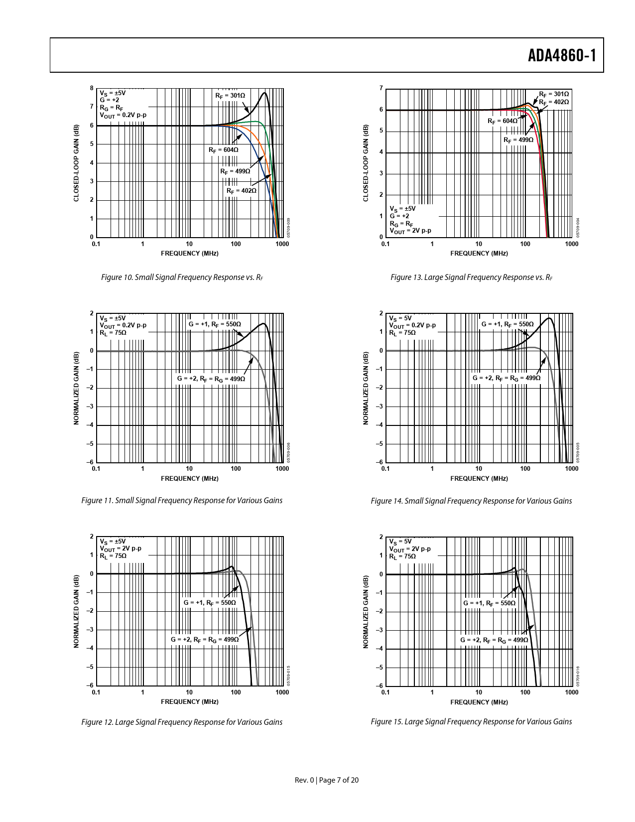

ADA4860-1. VS = ±5V. RF = 301Ω. G = +2. F = 301Ω. F = 402Ω. RG = RF. VOUT = 0.2V p-p. F = 604Ω. F = 499Ω. OOP. RF = 499Ω. 1 G = +2. G = RF
ADA4860-1 8 7 VS = ±5V R RF = 301Ω G = +2 F = 301Ω R 7 F = 402Ω RG = RF 6 VOUT = 0.2V p-p R ) 6 ) F = 604Ω B B d 5 d ( ( IN R 5 IN F = 499Ω R GA F = 604Ω 4 GA 4 OOP OOP -L RF = 499Ω -L 3 D D E 3 E OS R OS L F = 402Ω L 2 C 2 C VS = ±5V 1 1 G = +2

0.1 1 10 100 1000 0.1 1 10 100 1000 FREQUENCY (MHz) FREQUENCY (MHz)
Figure 10. Small Signal Frequency Response vs. RF Figure 13. Large Signal Frequency Response vs. RF
2 2 VS = ±5V VS = 5V V G = +1, R OUT = 0.2V p-p G = +1, RF = 550Ω VOUT = 0.2V p-p F = 550Ω 1 RL = 75Ω 1 RL = 75Ω ) 0 ) 0 B B d d ( ( IN –1 IN –1 GA G = +2, RF = RG = 499Ω GA G = +2, RF = RG = 499Ω D –2 D E –2 E IZ IZ L L A –3 A M –3 M R R O O N –4 N –4 –5 –5
Figure 11. Small Signal Frequency Response for Various Gains Figure 14. Small Signal Frequency Response for Various Gains
2 2 VS = ±5V VS = 5V VOUT = 2V p-p VOUT = 2V p-p 1 RL = 75Ω 1 RL = 75Ω ) 0 ) 0 B d B d ( ( IN –1 IN –1 GA G = +1, RF = 550Ω GA G = +1, RF = 550Ω D –2 D E –2 E IZ L IZ L A –3 A M –3 M R R O G = +2, RF = RG = 499Ω O G = +2, RF = RG = 499Ω N –4 N –4 –5 –5
Figure 12. Large Signal Frequency Response for Various Gains Figure 15. Large Signal Frequency Response for Various Gains Rev. 0 | Page 7 of 20 Document Outline FEATURES APPLICATIONS PIN CONFIGURATION GENERAL DESCRIPTION TABLE OF CONTENTS REVISION HISTORY SPECIFICATIONS ABSOLUTE MAXIMUM RATINGS THERMAL RESISTANCE Maximum Power Dissipation ESD CAUTION TYPICAL PERFORMANCE CHARACTERISTICS APPLICATION INFORMATION POWER SUPPLY BYPASSING FEEDBACK RESISTOR SELECTION DRIVING CAPACITIVE LOADS POWER DOWN PIN VIDEO AMPLIFIER SINGLE-SUPPLY OPERATION OPTIMIZING FLATNESS AND BANDWIDTH LAYOUT AND CIRCUIT BOARD PARASITICS OUTLINE DIMENSIONS ORDERING GUIDE
