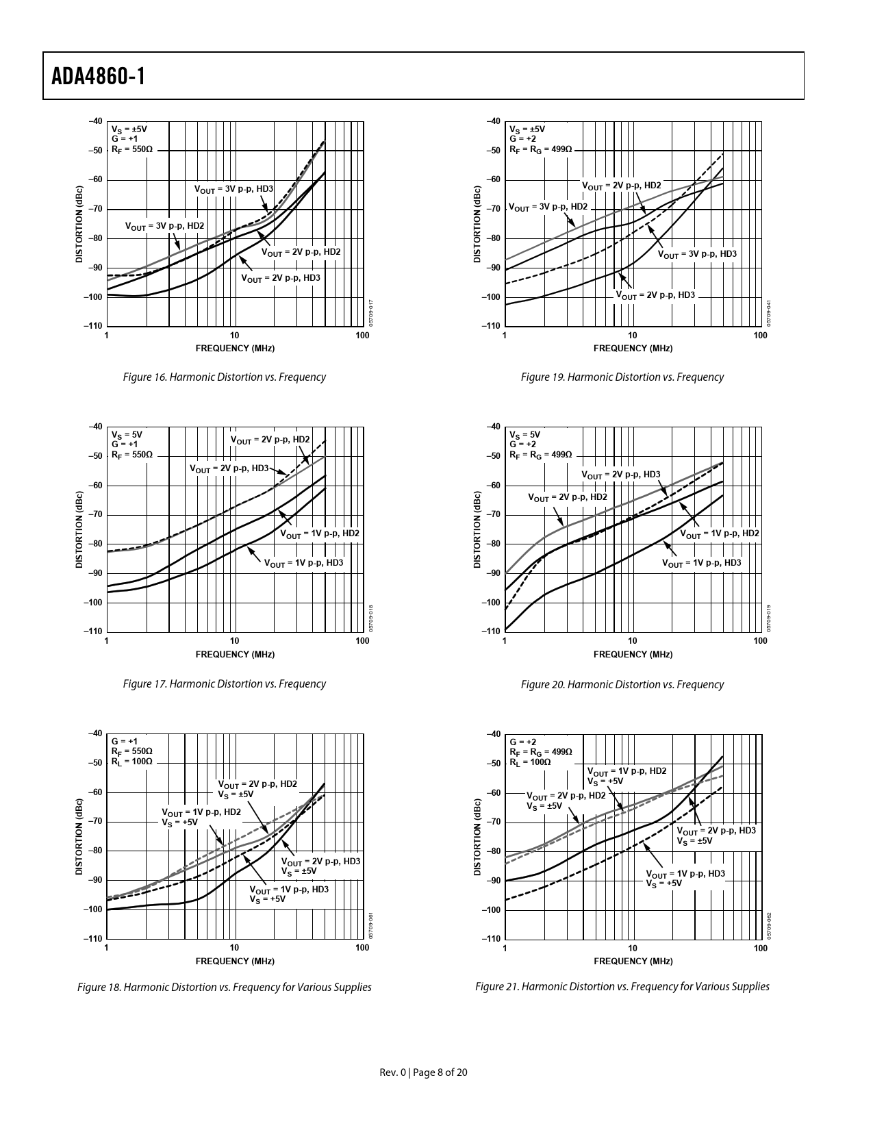

ADA4860-1. –40. VS = ±5V. G = +1. G = +2. –50 RF = 550Ω. –50 RF = RG = 499Ω. –60. VOUT = 3V p-p, HD3. OUT = 2V p-p, HD2. ( –70. –70
ADA4860-1 –40 –40 VS = ±5V VS = ±5V G = +1 G = +2 –50 RF = 550Ω –50 RF = RG = 499Ω –60 –60 V c) VOUT = 3V p-p, HD3 c) OUT = 2V p-p, HD2 B B d d ( –70 ( V N –70 N OUT = 3V p-p, HD2 IO IO T VOUT = 3V p-p, HD2 T R –80 R O –80 O T T S VOUT = 2V p-p, HD2 S V DI DI OUT = 3V p-p, HD3 –90 –90 VOUT = 2V p-p, HD3 –100 –100 VOUT = 2V p-p, HD3

1 10 100 1 10 100 FREQUENCY (MHz) FREQUENCY (MHz)
Figure 16. Harmonic Distortion vs. Frequency Figure 19. Harmonic Distortion vs. Frequency
–40 –40 VS = 5V V V S = 5V G = +1 OUT = 2V p-p, HD2 G = +2 –50 RF = 550Ω –50 RF = RG = 499Ω VOUT = 2V p-p, HD3 VOUT = 2V p-p, HD3 –60 –60 c) c) V B B OUT = 2V p-p, HD2 d d ( –70 ( –70 TION VOUT = 1V p-p, HD2 TION VOUT = 1V p-p, HD2 –80 OR –80 OR T T IS IS D VOUT = 1V p-p, HD3 D VOUT = 1V p-p, HD3 –90 –90 –100 –100
Figure 17. Harmonic Distortion vs. Frequency Figure 20. Harmonic Distortion vs. Frequency
–40 –40 G = +1 G = +2 RF = 550Ω RF = RG = 499Ω –50 RL = 100Ω –50 RL = 100Ω VOUT = 1V p-p, HD2 V V OUT = 2V p-p, HD2 S = +5V –60 V –60 S = ±5V V c) OUT = 2V p-p, HD2 c) B VS = ±5V d V B d ( OUT = 1V p-p, HD2 –70 ( N VS = +5V –70 IO VOUT = 2V p-p, HD3 T TION V R S = ±5V –80 O –80 OR T T S VOUT = 2V p-p, HD3 IS DI VS = ±5V D V –90 –90 OUT = 1V p-p, HD3 V V S = +5V OUT = 1V p-p, HD3 VS = +5V –100 –100
Figure 18. Harmonic Distortion vs. Frequency for Various Supplies Figure 21. Harmonic Distortion vs. Frequency for Various Supplies Rev. 0 | Page 8 of 20 Document Outline FEATURES APPLICATIONS PIN CONFIGURATION GENERAL DESCRIPTION TABLE OF CONTENTS REVISION HISTORY SPECIFICATIONS ABSOLUTE MAXIMUM RATINGS THERMAL RESISTANCE Maximum Power Dissipation ESD CAUTION TYPICAL PERFORMANCE CHARACTERISTICS APPLICATION INFORMATION POWER SUPPLY BYPASSING FEEDBACK RESISTOR SELECTION DRIVING CAPACITIVE LOADS POWER DOWN PIN VIDEO AMPLIFIER SINGLE-SUPPLY OPERATION OPTIMIZING FLATNESS AND BANDWIDTH LAYOUT AND CIRCUIT BOARD PARASITICS OUTLINE DIMENSIONS ORDERING GUIDE
