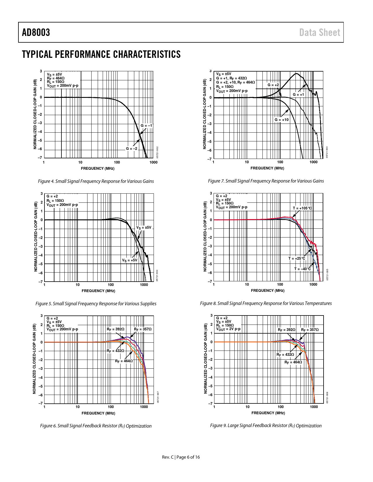

AD8003. Data Sheet. TYPICAL PERFORMANCE CHARACTERISTICS. S = ±5V. RF = 464Ω. G = +1, RF = 432Ω. L = 150Ω. G = +2, +10, RF = 464Ω

Figure 4. Small Signal Frequency Response for Various Gains Figure 7. Small Signal Frequency Response for Various Gains

Figure 5. Small Signal Frequency Response for Various Supplies Figure 8. Small Signal Frequency Response for Various Temperatures

Figure 6. Small Signal Feedback Resistor (RF) Optimization Figure 9. Large Signal Feedback Resistor (RF) Optimization Rev. C | Page 6 of 16 Document Outline Features Applications Connection Diagram General Description Table of Contents Revision History Specifications with ±5 V Supply Specifications with +5 V Supply Absolute Maximum Ratings Thermal Resistance Maximum Power Dissipation ESD Caution Typical Performance Characteristics Applications Information Gain Configurations RGB Video Driver Printed Circuit Board Layout Low Distortion Pinout Signal Routing Exposed Paddle Power Supply Bypassing Grounding Outline Dimensions Ordering Guide
