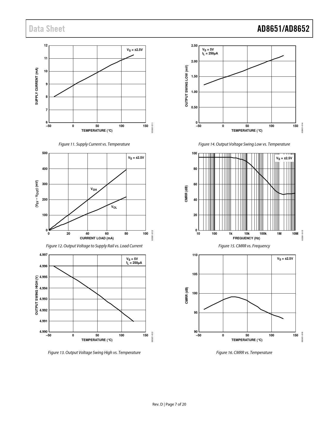

Pages / Page20 / 7 — Data Sheet. AD8651/AD8652. 2.50. VS = ±2.5V. VS = 5V IL = 250µA. 2.00. …
RevisionD
File Format / SizePDF / 472 Kb
Data Sheet. AD8651/AD8652. 2.50. VS = ±2.5V. VS = 5V IL = 250µA. 2.00. 1.50. G LO IN. URRE. C Y. 1.00. 0.50. –50. 100. 150. TEMPERATURE (°C). 500. 400. 300
Data Sheet AD8651/AD8652 2.50 VS = ±2.5V VS = 5V IL = 250µA 2.00 1.50 G LO IN URRE C Y 1.00 0.50 –50 100 150 TEMPERATURE (°C) 500 400 300
Data Sheet AD8651/AD8652 12 2.50 VS = ±2.5V VS = 5V IL = 250µA 11 2.00 ) ) V A 10 (m (m W 1.50 NT 9 G LO IN URRE W C Y S 1.00 L T P 8 U UP TP S OU 0.50 7 6 0

0 03 Figure 11. Supply Current vs. Temperature Figure 14. Output Voltage Swing Low vs. Temperature
500 100 VS = ±2.5V VS = ±2.5V 400 80 V) 300 60 ) (m B) T VOH d OUV RR ( 200 CM 40 SY (V VOL 100 20 0 0

33 0 0 Figure 12. Output Voltage to Supply Rail vs. Load Current Figure 15. CMRR vs. Frequency
4.997 110 VS = 5V VS = ±2.5V IL = 250µA 4.996 ) 105 V 4.995 ( IGH 4.994 B) G H d IN 100 W 4.993 RR ( S T CM U TP 4.992 OU 95 4.991 4.990 90

33 0 0 Figure 13. Output Voltage Swing High vs. Temperature Figure 16. CMRR vs. Temperature Rev. D | Page 7 of 20 Document Outline Features Applications Pin Configurations General Description Table of Contents Revision History Specifications Electrical Characteristics Absolute Maximum Ratings ESD Caution Thermal Resistance Typical Performance Characteristics Applications Theory of Operation Rail-to-Rail Output Stage Rail-to-Rail Input Stage Input Protection Overdrive Recovery Layout, Grounding, and Bypassing Considerations Power Supply Bypassing Grounding Leakage Currents Input Capacitance Output Capacitance Settling Time THD Readings vs. Common-Mode Voltage Driving a 16-Bit ADC Outline Dimensions Ordering Guide
