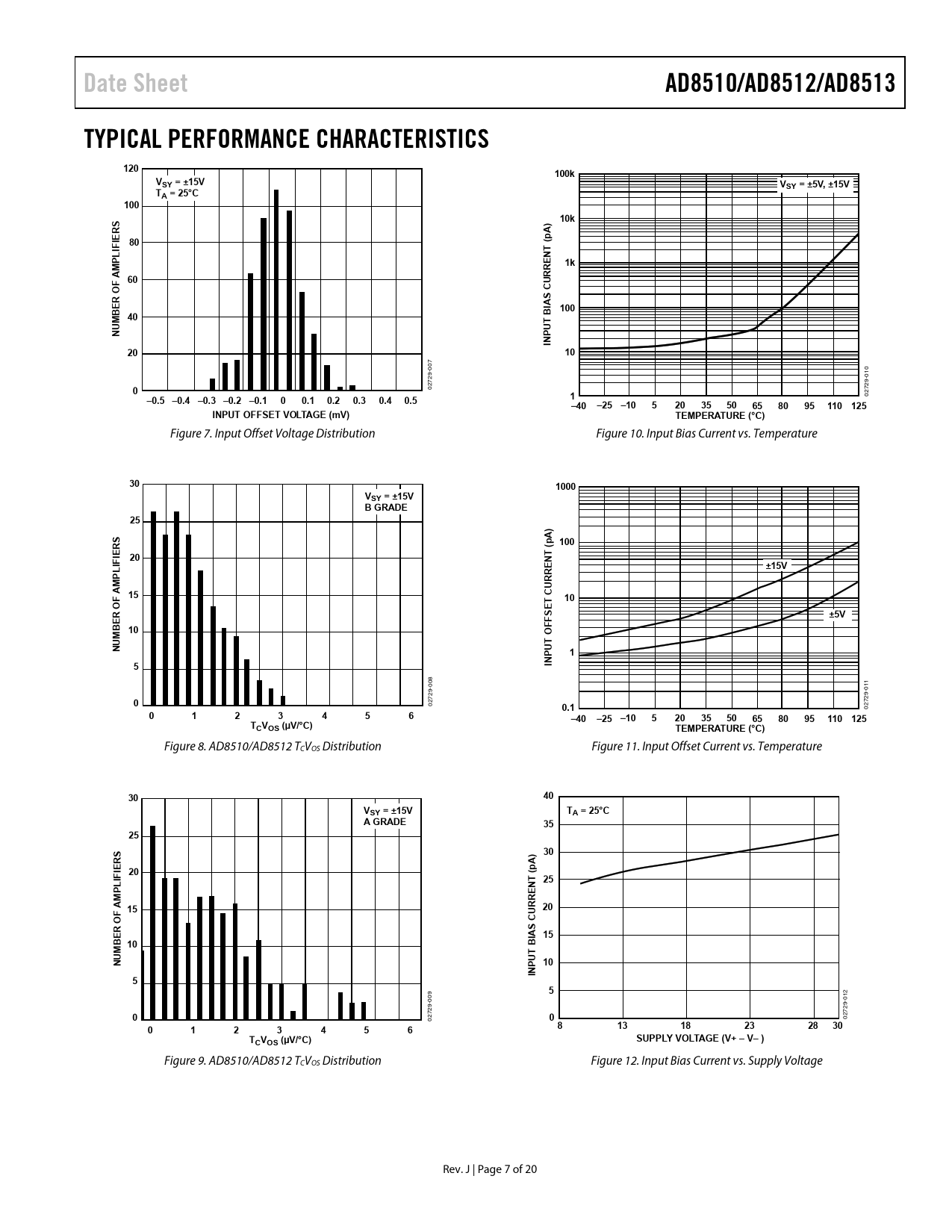

Date Sheet. AD8510/AD8512/AD8513. TYPICAL PERFORMANCE CHARACTERISTICS. 120. 100k. VSY = ±15V. VSY = ±5V, ±15V. TA = 25°C. 100. 10k. IF L. RRE
Date Sheet AD8510/AD8512/AD8513 TYPICAL PERFORMANCE CHARACTERISTICS 120 100k VSY = ±15V VSY = ±5V, ±15V TA = 25°C 100 10k RS A) IE p 80 ( IF L NT P 1k AM RRE F 60 CU R O AS BE 100 40 BI T U NUM INP 20 10
007 9- 10 0 72 9-
0
02 72 02
–0.5 –0.4 –0.3 –0.2 –0.1 0 0.1 0.2 0.3 0.4 0.5 1–40 –25 –10 5 20 35 50 65 80 95 110 125 INPUT OFFSET VOLTAGE (mV) TEMPERATURE (°C)
Figure 7. Input Offset Voltage Distribution Figure 10. Input Bias Current vs. Temperature
30 1000 VSY = ±15V B GRADE 25 A) p RS ( 100 IE 20 IF NT L ±15V P AM URRE F 15 C T 10 O E R S F ±5V BE F 10 O NUM UT 1 5 INP
08 1 0 1 9- 0 9-
0
272 72 0
0.1
02
0 1 2 3 4 5 6 –40 –25 –10 5 20 35 50 65 80 95 110 125 TCVOS (µV/°C) TEMPERATURE (°C)
Figure 8. AD8510/AD8512 TCVOS Distribution Figure 11. Input Offset Current vs. Temperature
30 40 VSY = ±15V TA = 25°C A GRADE 35 25 S 30 R A) IE p 20 ( IF T L 25 N P M A 15 20 OF CURRE R S E IA 15 10 MB B U UT N 10 INP 5 5
09 12 0 0 9- 9- 72
0
72 02
0
02
0 1 2 3 4 5 6 8 13 18 23 28 30 TCVOS (µV/°C) SUPPLY VOLTAGE (V+ – V– )
Figure 9. AD8510/AD8512 TCVOS Distribution Figure 12. Input Bias Current vs. Supply Voltage Rev. J | Page 7 of 20 Document Outline Features Applications Pin Configurations General Description Revision History Specifications Electrical Characteristics Absolute Maximum Ratings ESD Caution Typical Performance Characteristics General Application Information Input Overvoltage Protection Output Phase Reversal Total Harmonic Distortion (THD) + Noise Total Noise Including Source Resistors Settling Time Overload Recovery Time Capacitive Load Drive Open-Loop Gain and Phase Response Precision Rectifiers I-V Conversion Applications Photodiode Circuits Signal Transmission Applications Crosstalk Outline Dimensions Ordering Guide
