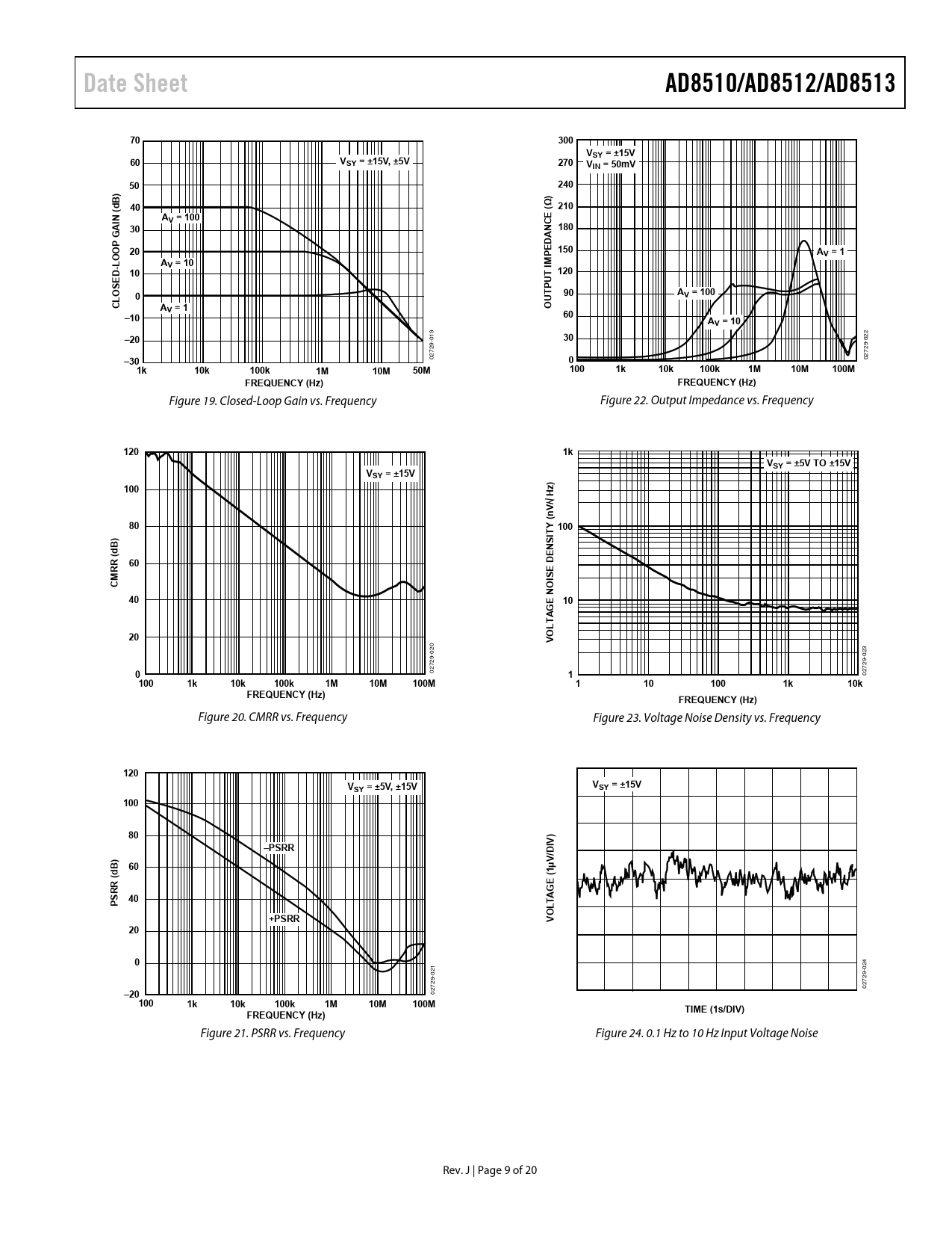

Date Sheet. AD8510/AD8512/AD8513. 300. VSY = ±15V. VSY = ±15V, ±5V. 270. VIN = 50mV. 240. ) B. Ω 210. ( E. AV = 100. N 180. E 150. V = 1. AV = 10. D 10
Date Sheet AD8510/AD8512/AD8513 300 VSY = ±15V VSY = ±15V, ±5V 270 VIN = 50mV 240 ) B Ω 210 ( E AV = 100 N 180 E 150 V = 1 AV = 10 D 10
Date Sheet AD8510/AD8512/AD8513 70 300 VSY = ±15V 60 VSY = ±15V, ±5V 270 VIN = 50mV 50 240 ) B ) d Ω 210 ( 40 ( E IN AV = 100 C 30 N 180 GA A P D 20 E 150 A OO P V = 1 M -L AV = 10 I D 10 T 120 E U P OS T 90 A L 0 V = 100 C A OU V = 1 –10 60 AV = 10

Figure 19. Closed-Loop Gain vs. Frequency Figure 22. Output Impedance vs. Frequency

Figure 20. CMRR vs. Frequency Figure 23. Voltage Noise Density vs. Frequency

Figure 21. PSRR vs. Frequency Figure 24. 0.1 Hz to 10 Hz Input Voltage Noise Rev. J | Page 9 of 20 Document Outline Features Applications Pin Configurations General Description Revision History Specifications Electrical Characteristics Absolute Maximum Ratings ESD Caution Typical Performance Characteristics General Application Information Input Overvoltage Protection Output Phase Reversal Total Harmonic Distortion (THD) + Noise Total Noise Including Source Resistors Settling Time Overload Recovery Time Capacitive Load Drive Open-Loop Gain and Phase Response Precision Rectifiers I-V Conversion Applications Photodiode Circuits Signal Transmission Applications Crosstalk Outline Dimensions Ordering Guide
