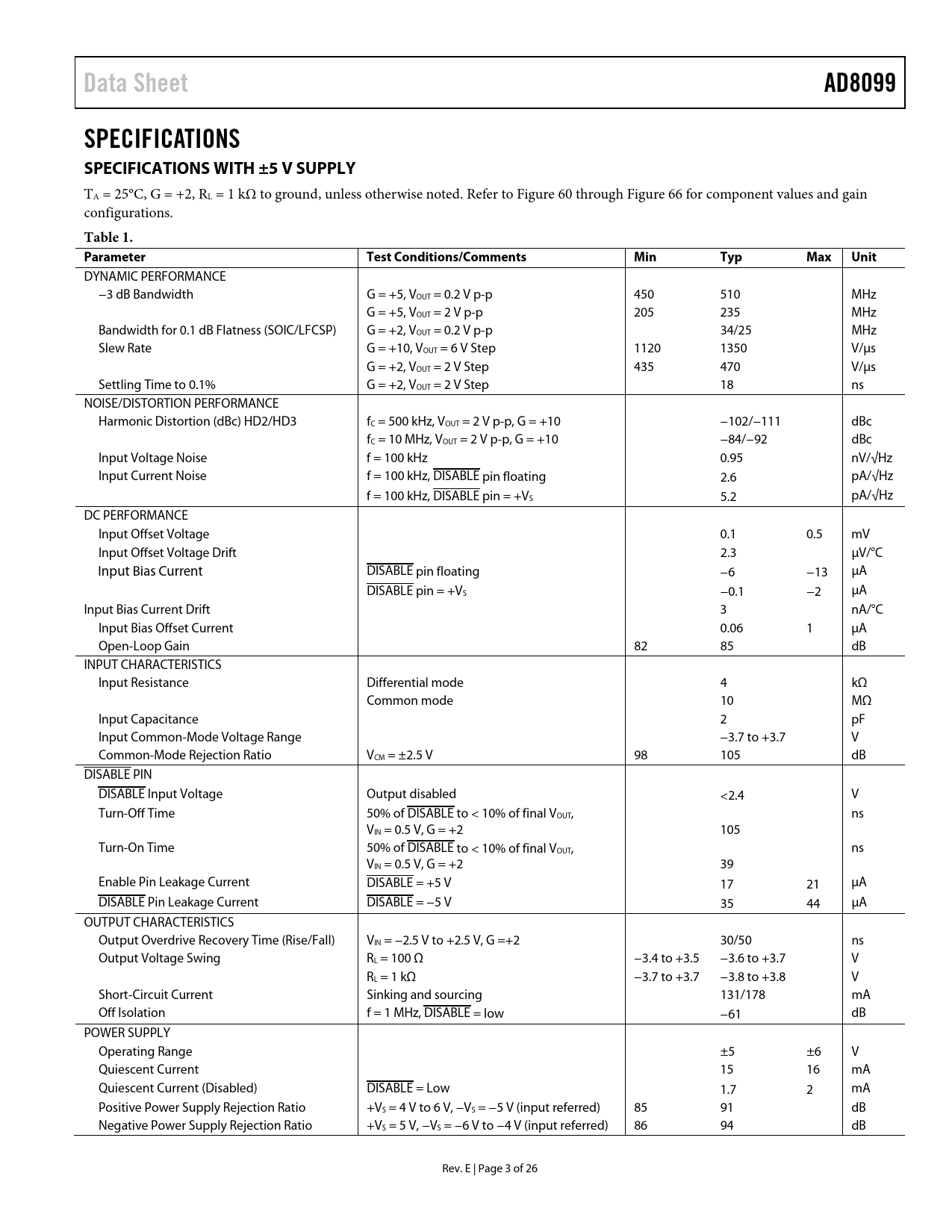

Data Sheet. AD8099. SPECIFICATIONS SPECIFICATIONS WITH ±5 V SUPPLY. Table 1. Parameter. Test Conditions/Comments. Min. Typ. Max. Unit
Data Sheet AD8099 SPECIFICATIONS SPECIFICATIONS WITH ±5 V SUPPLY Table 1 Parameter Test Conditions/Comments Min Typ Max Unit
link to page 19 link to page 20
TA = 25°C, G = +2, RL = 1 kΩ to ground, unless otherwise noted. Refer to Figure 60 through Figure 66 for component values and gain configurations.
Table 1. Parameter Test Conditions/Comments Min Typ Max Unit
DYNAMIC PERFORMANCE −3 dB Bandwidth G = +5, VOUT = 0.2 V p-p 450 510 MHz G = +5, VOUT = 2 V p-p 205 235 MHz Bandwidth for 0.1 dB Flatness (SOIC/LFCSP) G = +2, VOUT = 0.2 V p-p 34/25 MHz Slew Rate G = +10, VOUT = 6 V Step 1120 1350 V/µs G = +2, VOUT = 2 V Step 435 470 V/µs Settling Time to 0.1% G = +2, VOUT = 2 V Step 18 ns NOISE/DISTORTION PERFORMANCE Harmonic Distortion (dBc) HD2/HD3 fC = 500 kHz, VOUT = 2 V p-p, G = +10 −102/−111 dBc fC = 10 MHz, VOUT = 2 V p-p, G = +10 −84/−92 dBc Input Voltage Noise f = 100 kHz 0.95 nV/√Hz Input Current Noise f = 100 kHz, DISABLE pin floating 2.6 pA/√Hz f = 100 kHz, DISABLE pin = +VS 5.2 pA/√Hz DC PERFORMANCE Input Offset Voltage 0.1 0.5 mV Input Offset Voltage Drift 2.3 µV/°C Input Bias Current DISABLE pin floating −6 −13 µA DISABLE pin = +VS −0.1 −2 µA Input Bias Current Drift 3 nA/°C Input Bias Offset Current 0.06 1 µA Open-Loop Gain 82 85 dB INPUT CHARACTERISTICS Input Resistance Differential mode 4 kΩ Common mode 10 MΩ Input Capacitance 2 pF Input Common-Mode Voltage Range −3.7 to +3.7 V Common-Mode Rejection Ratio VCM = ±2.5 V 98 105 dB DISABLE PIN DISABLE Input Voltage Output disabled <2.4 V Turn-Off Time 50% of DISABLE to < 10% of final VOUT, ns VIN = 0.5 V, G = +2 105 Turn-On Time 50% of DISABLE to < 10% of final VOUT, ns VIN = 0.5 V, G = +2 39 Enable Pin Leakage Current DISABLE = +5 V 17 21 µA DISABLE Pin Leakage Current DISABLE = −5 V 35 44 µA OUTPUT CHARACTERISTICS Output Overdrive Recovery Time (Rise/Fall) VIN = −2.5 V to +2.5 V, G =+2 30/50 ns Output Voltage Swing RL = 100 Ω −3.4 to +3.5 −3.6 to +3.7 V RL = 1 kΩ −3.7 to +3.7 −3.8 to +3.8 V Short-Circuit Current Sinking and sourcing 131/178 mA Off Isolation f = 1 MHz, DISABLE = low −61 dB POWER SUPPLY Operating Range ±5 ±6 V Quiescent Current 15 16 mA Quiescent Current (Disabled) DISABLE = Low 1.7 2 mA Positive Power Supply Rejection Ratio +VS = 4 V to 6 V, −VS = −5 V (input referred) 85 91 dB Negative Power Supply Rejection Ratio +VS = 5 V, −VS = −6 V to −4 V (input referred) 86 94 dB Rev. E | Page 3 of 26 Document Outline FEATURES APPLICATIONS GENERAL DESCRIPTION CONNECTION DIAGRAMS REVISION HISTORY SPECIFICATIONS SPECIFICATIONS WITH ±5 V SUPPLY SPECIFICATIONS WITH +5 V SUPPLY ABSOLUTE MAXIMUM RATINGS MAXIMUM POWER DISSIPATION ESD CAUTION TYPICAL PERFORMANCE CHARACTERISTICS THEORY OF OPERATION APPLICATIONS INFORMATION USING THE AD8099 CIRCUIT COMPONENTS RECOMMENDED VALUES CIRCUIT CONFIGURATIONS PERFORMANCE vs. COMPONENT VALUES TOTAL OUTPUT NOISE CALCULATIONS AND DESIGN INPUT BIAS CURRENT AND DC OFFSET PIN AND INPUT BIAS CANCELLATION 16-BIT ADC DRIVER CIRCUIT CONSIDERATIONS PCB Layout Parasitics Grounding Power Supply Bypassing Component Selection DESIGN TOOLS AND TECHNICAL SUPPORT OUTLINE DIMENSIONS ORDERING GUIDE
