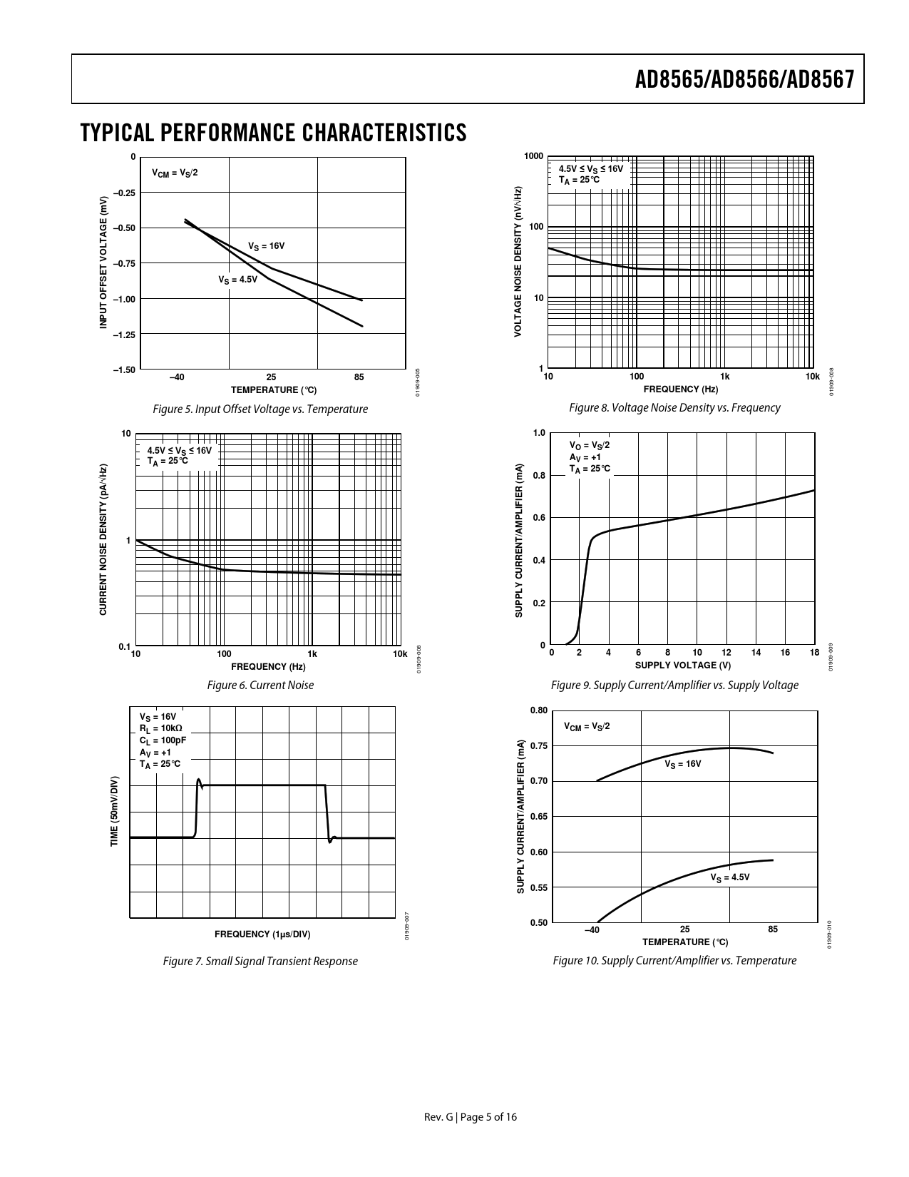

Pages / Page16 / 5 — AD8565/AD8566/AD8567. TYPICAL PERFORMANCE CHARACTERISTICS. 1000. 4.5V ≤ …

AD8565/AD8566/AD8567. TYPICAL PERFORMANCE CHARACTERISTICS. 1000. 4.5V ≤ VS ≤ 16V. CM = VS/2. TA = 25°C. –0.25. ) V. √Hz. GE –0.50. Y (n 100

01909- 01909- Figure 5. Input Offset Voltage vs. Temperature Figure 8. Voltage Noise Density vs. Frequency
10 1.0 V 4.5V ≤ V O = VS/2 S ≤ 16V A ) T V = +1 A = 25°C TA = 25°C √Hz 0.8 mA) A/ p R ( ( IE Y IF IT L P 0.6 NS /AM DE 1 E NT IS 0.4 NO NT CURRE Y L P 0.2 UP CURRE S 0.1 0 10 100 1k 10k

01909- 01909- Figure 6. Current Noise Figure 9. Supply Current/Amplifier vs. Supply Voltage
0.80 VS = 16V R V L = 10kΩ CM = VS/2 CL = 100pF 0.75 AV = +1 mA) TA = 25°C R ( VS = 16V IE IV) IF 0.70 D L P V/ m 0 /AM 0.65 NT IME (5 T CURRE 0.60 Y L P VS = 4.5V UP S 0.55

01909- Figure 7. Small Signal Transient Response Figure 10. Supply Current/Amplifier vs. Temperature Rev. G | Page 5 of 16 Document Outline Features Applications General Description Pin Configurations Revision History Specifications Electrical Characteristics Absolute Maximum Ratings Thermal Resistance ESD Caution Typical Performance Characteristics Theory of Operation Input Overvoltage Protection Output Phase Reversal Power Dissipation Thermal Pad—AD8567 Total Harmonic Distortion + Noise (THD + N) Short-Circuit Output Conditions LCD Panel Applications Outline Dimensions Ordering Guide
