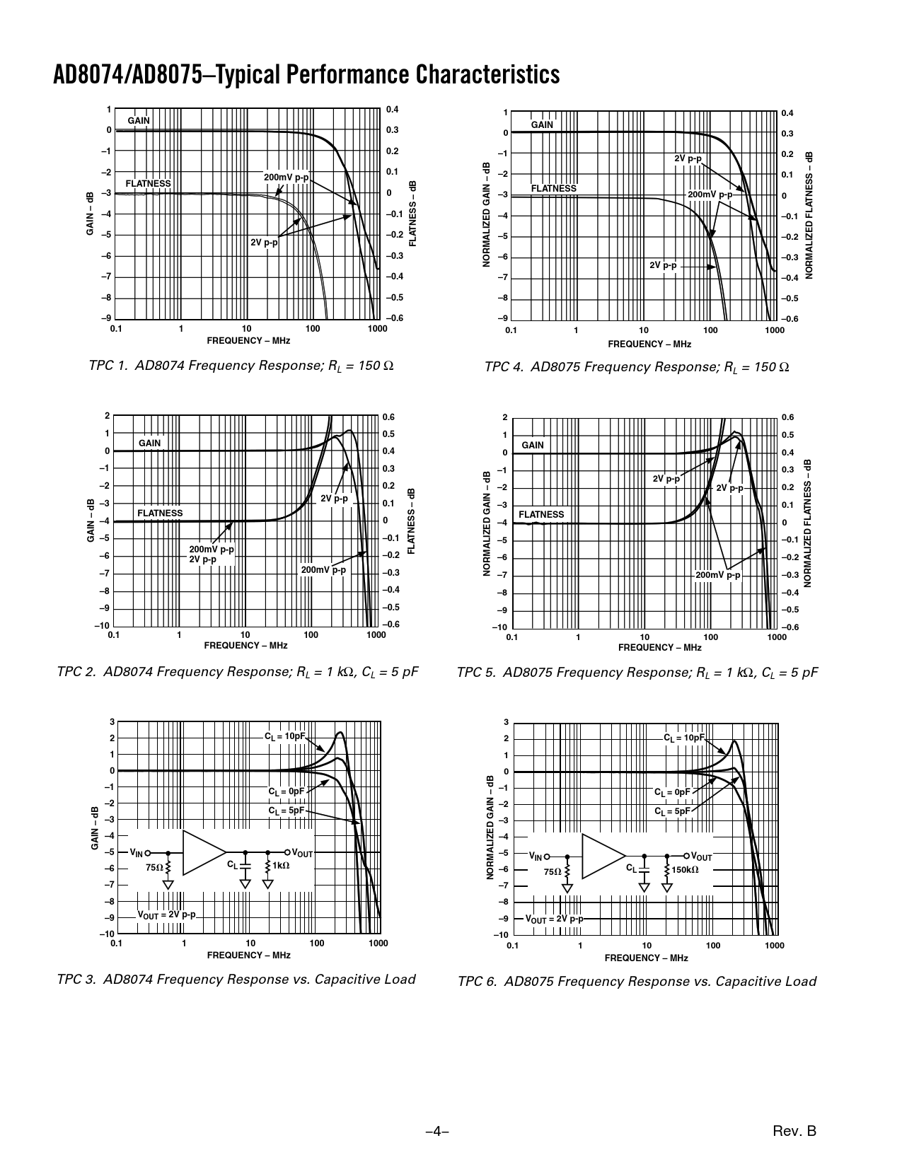

AD8074/AD8075–Typical Performance Characteristics. 0.4. GAIN. 0.3. 0.2. 2V p-p. dB –. 0.1. 200mV p-p. FLATNESS. TNESS. –0.1. –0.2. FLA. –0.3
AD8074/AD8075–Typical Performance Characteristics 0.4 GAIN 0.3 0.2 2V p-p dB – 0.1 200mV p-p FLATNESS TNESS –0.1 –0.2 FLA –0.3
AD8074/AD8075–Typical Performance Characteristics 1 0.4 1 0.4 GAIN GAIN 0 0.3 0 0.3 –1 0.2 –1 0.2 2V p-p dB – –2 0.1 200mV p-p dB –2 0.1 FLATNESS FLATNESS –3 0 dB – –3 200mV p-p 0 dB TNESS –4 –0.1 –4 –0.1 TNESS GAIN –5 –0.2 –5 –0.2 2V p-p FLA –6 –0.3 –6 –0.3 NORMALIZED GAIN 2V p-p –7 –0.4 –7 –0.4 NORMALIZED FLA –8 –0.5 –8 –0.5 –9 –0.6 –9 –0.6 0.1 1 10 100 1000 0.1 1 10 100 1000 FREQUENCY – MHz FREQUENCY – MHz
TPC 1. AD8074 Frequency Response; RL = 150 Ω TPC 4. AD8075 Frequency Response; RL = 150 Ω
2 0.6 2 0.6 1 0.5 1 0.5 GAIN GAIN 0 0.4 0 0.4 –1 0.3 –1 0.3 dB – 2V p-p –2 0.2 dB – –2 2V p-p 0.2 2V p-p dB –3 0.1 –3 0.1 dB TNESS FLATNESS FLATNESS –4 0 –4 0 GAIN –5 –0.1 TNESS –5 –0.1 200mV p-p FLA –6 –0.2 2V p-p –6 –0.2 –7 200mV p-p –0.3 NORMALIZED GAIN –7 200mV p-p –0.3 NORMALIZED FLA –8 –0.4 –8 –0.4 –9 –0.5 –9 –0.5 –10 –0.6 –10 –0.6 0.1 1 10 100 1000 0.1 1 10 100 1000 FREQUENCY – MHz FREQUENCY – MHz
TPC 2. AD8074 Frequency Response; RL = 1 kΩ, CL = 5 pF TPC 5. AD8075 Frequency Response; RL = 1 kΩ, CL = 5 pF
3 3 2 CL = 10pF 2 CL = 10pF 1 1 0 0 –1 dB C –1 L = 0pF CL = 0pF –2 –2 CL = 5pF CL = 5pF dB – –3 –3 –4 –4 GAIN –5 VIN VOUT –5 VIN VOUT C –6 75 L 1k
ORMALIZED GAIN –6 CL 150k 75
N –7 –7 –8 –8 –9 VOUT = 2V p-p –9 VOUT = 2V p-p –10 –10 0.1 1 10 100 1000 0.1 1 10 100 1000 FREQUENCY – MHz FREQUENCY – MHz
TPC 3. AD8074 Frequency Response vs. Capacitive Load TPC 6. AD8075 Frequency Response vs. Capacitive Load –4– Rev. B Document Outline FEATURES APPLICATIONS FUNCTIONAL BLOCK DIAGRAM PRODUCT DESCRIPTION AD8074/AD8075-SPECIFICATIONS ABSOLUTE MAXIMUM RATINGS PIN CONFIGURATION ESD CAUTION MAXIMUM POWER DISSIPATION AD8074/AD8075-TYPICAL PERFORMANCE CHARACTERISTICS THEORY OF OPERATION OUTLINE DIMENSIONS ORDERING GUIDE
