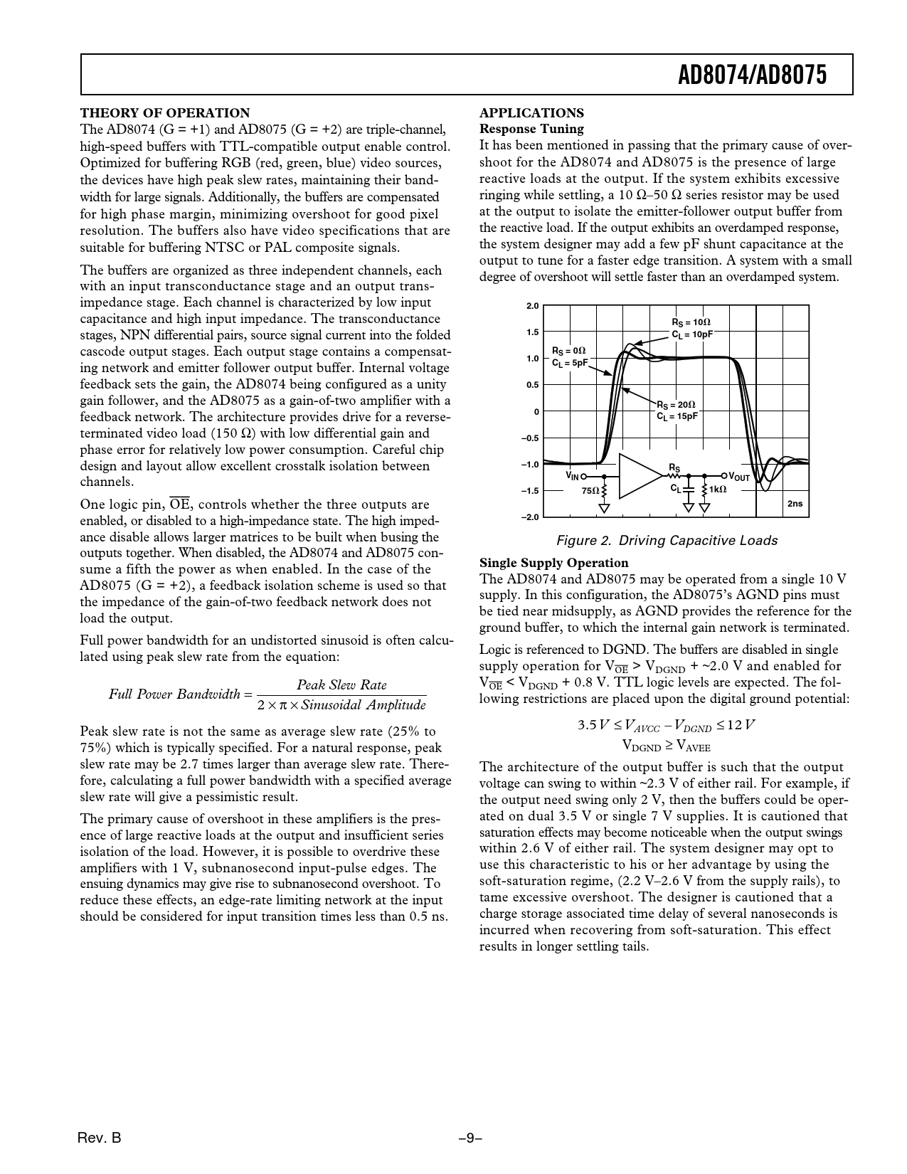

AD8074/AD8075. THEORY OF OPERATION. APPLICATIONS. Response Tuning. 2.0. RS = 10. 1.5. CL = 10pF. RS = 0. 1.0. CL = 5pF. 0.5. RS = 20. CL = 15pF
AD8074/AD8075 THEORY OF OPERATION APPLICATIONS Response Tuning 2.0 RS = 10 1.5 CL = 10pF RS = 0 1.0 CL = 5pF 0.5 RS = 20 CL = 15pF
The AD8074 (G = +1) and AD8075 (G = +2) are triple-channel,
Response Tuning
high-speed buffers with TTL-compatible output enable control. It has been mentioned in passing that the primary cause of over- Optimized for buffering RGB (red, green, blue) video sources, shoot for the AD8074 and AD8075 is the presence of large the devices have high peak slew rates, maintaining their band- reactive loads at the output. If the system exhibits excessive width for large signals. Additionally, the buffers are compensated ringing while settling, a 10 Ω–50 Ω series resistor may be used for high phase margin, minimizing overshoot for good pixel at the output to isolate the emitter-follower output buffer from resolution. The buffers also have video specifications that are the reactive load. If the output exhibits an overdamped response, suitable for buffering NTSC or PAL composite signals. the system designer may add a few pF shunt capacitance at the output to tune for a faster edge transition. A system with a small The buffers are organized as three independent channels, each degree of overshoot will settle faster than an overdamped system. with an input transconductance stage and an output trans- impedance stage. Each channel is characterized by low input
2.0
capacitance and high input impedance. The transconductance
RS = 10
⍀ stages, NPN differential pairs, source signal current into the folded
1.5 CL = 10pF
cascode output stages. Each output stage contains a compensat-
RS = 0
1.0
ing network and emitter follower output buffer. Internal voltage
CL = 5pF
feedback sets the gain, the AD8074 being configured as a unity
0.5
gain follower, and the AD8075 as a gain-of-two amplifier with a
RS = 20
⍀ feedback network. The architecture provides drive for a reverse-
0 CL = 15pF
terminated video load (150 Ω) with low differential gain and
–0.5
phase error for relatively low power consumption. Careful chip design and layout allow excellent crosstalk isolation between
–1.0 RS V
channels.
IN VOUT C –1.5 75 L 1k
⍀ ⍀ One logic pin, OE, controls whether the three outputs are
2ns
enabled, or disabled to a high-impedance state. The high imped-
–2.0
ance disable allows larger matrices to be built when busing the Figure 2. Driving Capacitive Loads outputs together. When disabled, the AD8074 and AD8075 con-
