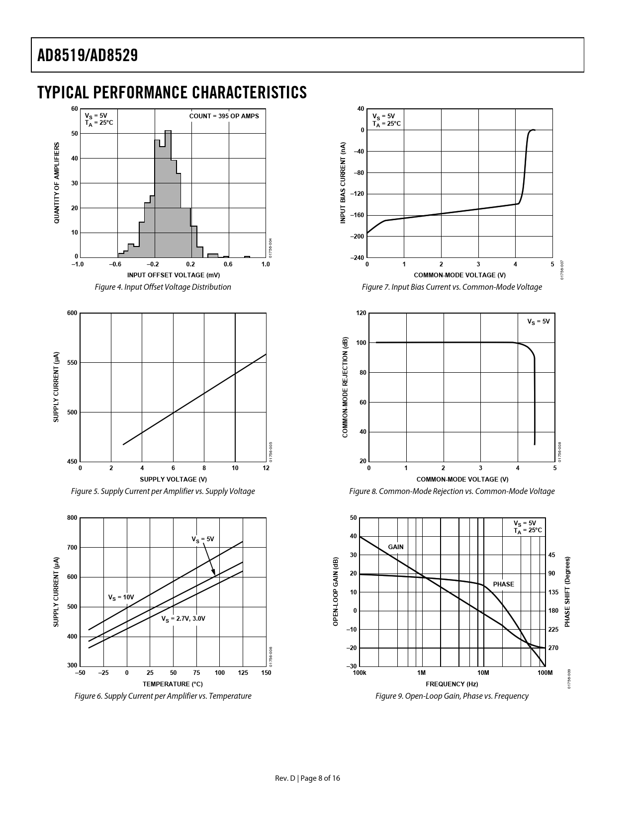

AD8519/AD8529. TYPICAL PERFORMANCE CHARACTERISTICS. VS = 5V. COUNT = 395 OP AMPS. TA = 25°C. A) n. –40. –80. AM F. CURR. O Y. AS –120. T U. UANT
AD8519/AD8529 TYPICAL PERFORMANCE CHARACTERISTICS 60 40 VS = 5V COUNT = 395 OP AMPS VS = 5V TA = 25°C TA = 25°C 0 50 RS A) n IE ( –40 IF 40 L NT P E –80 AM F 30 CURR O Y AS –120 IT BI 20 T U UANT –160 Q INP 10 –200
4 00 6- 75
0
01
–240 –1.0 –0.6 –0.2 0.2 0.6 1.0 0 1 2 3 4 5
07 -0 56
INPUT OFFSET VOLTAGE (mV) COMMON-MODE VOLTAGE (V)
17 0 Figure 4. Input Offset Voltage Distribution Figure 7. Input Bias Current vs. Common-Mode Voltage
600 120 VS = 5V B) 100 (d A) N IO (µ 550 CT NT JE 80 URRE RE E C D Y O L 60 P -M P 500 N U O S M M 40 CO
5 08 00 0 6- 6- 75
450
175 01
20
0
0 2 4 6 8 10 12 0 1 2 3 4 5 SUPPLY VOLTAGE (V) COMMON-MODE VOLTAGE (V)
Figure 5. Supply Current per Amplifier vs. Supply Voltage Figure 8. Common-Mode Rejection vs. Common-Mode Voltage
800 50 VS = 5V TA = 25°C V 40 S = 5V 700 GAIN ) 30 45 A) µ B es) ( d re T ( N 20 90 600 IN eg A RE G PHASE (D T 10 135 IF CUR VS = 10V OOP H Y 500 S L -L E P N 0 180 E UP VS = 2.7V, 3.0V HAS S OP P –10 225 400
6
–20 270
0 0 6- 75
300
01
–30 –50 –25 0 25 50 75 100 125 150 100k 1M 10M 100M
09 -0 56
TEMPERATURE (°C) FREQUENCY (Hz)
17 0 Figure 6. Supply Current per Amplifier vs. Temperature Figure 9. Open-Loop Gain, Phase vs. Frequency Rev. D | Page 8 of 16 Document Outline FEATURES APPLICATIONS PIN CONFIGURATIONS GENERAL DESCRIPTION REVISION HISTORY SPECIFICATIONS ELECTRICAL CHARACTERISTICS ABSOLUTE MAXIMUM RATINGS THERMAL RESISTANCE ESD CAUTION TYPICAL PERFORMANCE CHARACTERISTICS APPLICATIONS INFORMATION MAXIMUM POWER DISSIPATION PRECISION FULL-WAVE RECTIFIER 10× MICROPHONE PREAMP MEETS PC99 SPECIFICATIONS TWO-ELEMENT VARYING BRIDGE AMPLIFIER OUTLINE DIMENSIONS ORDERING GUIDE
