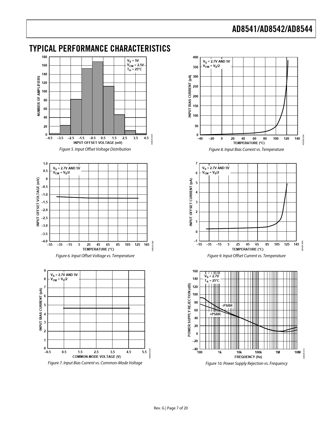

AD8541/AD8542/AD8544. TYPICAL PERFORMANCE CHARACTERISTICS. 180. 400. VS = 5V. VS = 2.7V AND 5V. 160. VCM = 2.5V. 350. VCM = VS/2. TA = 25°C
AD8541/AD8542/AD8544 TYPICAL PERFORMANCE CHARACTERISTICS 180 400 VS = 5V VS = 2.7V AND 5V 160 VCM = 2.5V 350 VCM = VS/2 TA = 25°C
AD8541/AD8542/AD8544 TYPICAL PERFORMANCE CHARACTERISTICS 180 400 VS = 5V VS = 2.7V AND 5V 160 VCM = 2.5V 350 VCM = VS/2 TA = 25°C 140 S A) 300 R p IE 120 ( T IF L N 250 P 100 AM URRE F C 200 80 R O AS 150 BE BI 60 UT NUM 100 40 INP 20 50 0 0
05 8
–4.5 –3.5 –2.5 –1.5 –0.5 0.5 1.5 2.5 3.5 4.5
0 00 5-
–40 –20 0 20 40 60 80 100 120 140
5-
INPUT OFFSET VOLTAGE (mV)
93 93 00
TEMPERATURE (°C)
00 Figure 5. Input Offset Voltage Distribution Figure 8. Input Bias Current vs. Temperature
1.0 7 VS = 2.7V AND 5V VS = 2.7V AND 5V 0.5 VCM = VS/2 6 VCM = VS/2 V) 0 A) m p ( 5 E ( –0.5 G NT A T RE 4 L –1.0 VO –1.5 CUR T 3 E SET S F –2.0 F F F 2 O O T –2.5 UT PU P 1 IN –3.0 IN 0 –3.5 –4.0 –1
06 09
–55 –35 –15 5 25 45 65 85 105 125 145
0
0 5- 5-
TEMPERATURE (°C)
93
TEMPERATURE (°C)
93 00 00 Figure 6. Input Offset Voltage vs. Temperature Figure 9. Input Offset Current vs. Temperature
9 160 VS = 2.7V AND 5V V 8 S = 2.7V VCM = VS/2 140 TA = 25°C 7 B) d 120 A) p N ( ( 6 IO 100 NT CT 80 5 JE –PSRR RE CURRE Y 60 L AS 4 P +PSRR BI 40 UP 3 UT S R E 20 INP 2 W O 0 P 1 –20 0
07
–40 –0.5 0.5 1.5 2.5 3.5 4.5 5.5
0 10 0 5-
100 1k 10k 100k 1M 10M
5-
COMMON-MODE VOLTAGE (V)
93
FREQUENCY (Hz)
93 00 00 Figure 7. Input Bias Current vs. Common-Mode Voltage Figure 10. Power Supply Rejection vs. Frequency Rev. G | Page 7 of 20 Document Outline FEATURES APPLICATIONS GENERAL DESCRIPTION PIN CONFIGURATIONS TABLE OF CONTENTS REVISION HISTORY SPECIFICATIONS ELECTRICAL CHARACTERISTICS ABSOLUTE MAXIMUM RATINGS THERMAL RESISTANCE ESD CAUTION TYPICAL PERFORMANCE CHARACTERISTICS THEORY OF OPERATION NOTES ON THE AD854X AMPLIFIERS Lower Supply Current for 1 MHz Gain Bandwidth Higher Output Current Better Performance at Lower Voltages APPLICATIONS NOTCH FILTER COMPARATOR FUNCTION PHOTODIODE APPLICATION OUTLINE DIMENSIONS ORDERING GUIDE AUTOMOTIVE PRODUCTS
